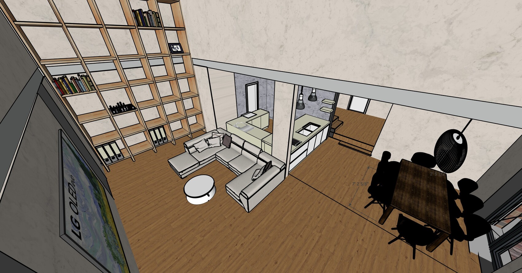

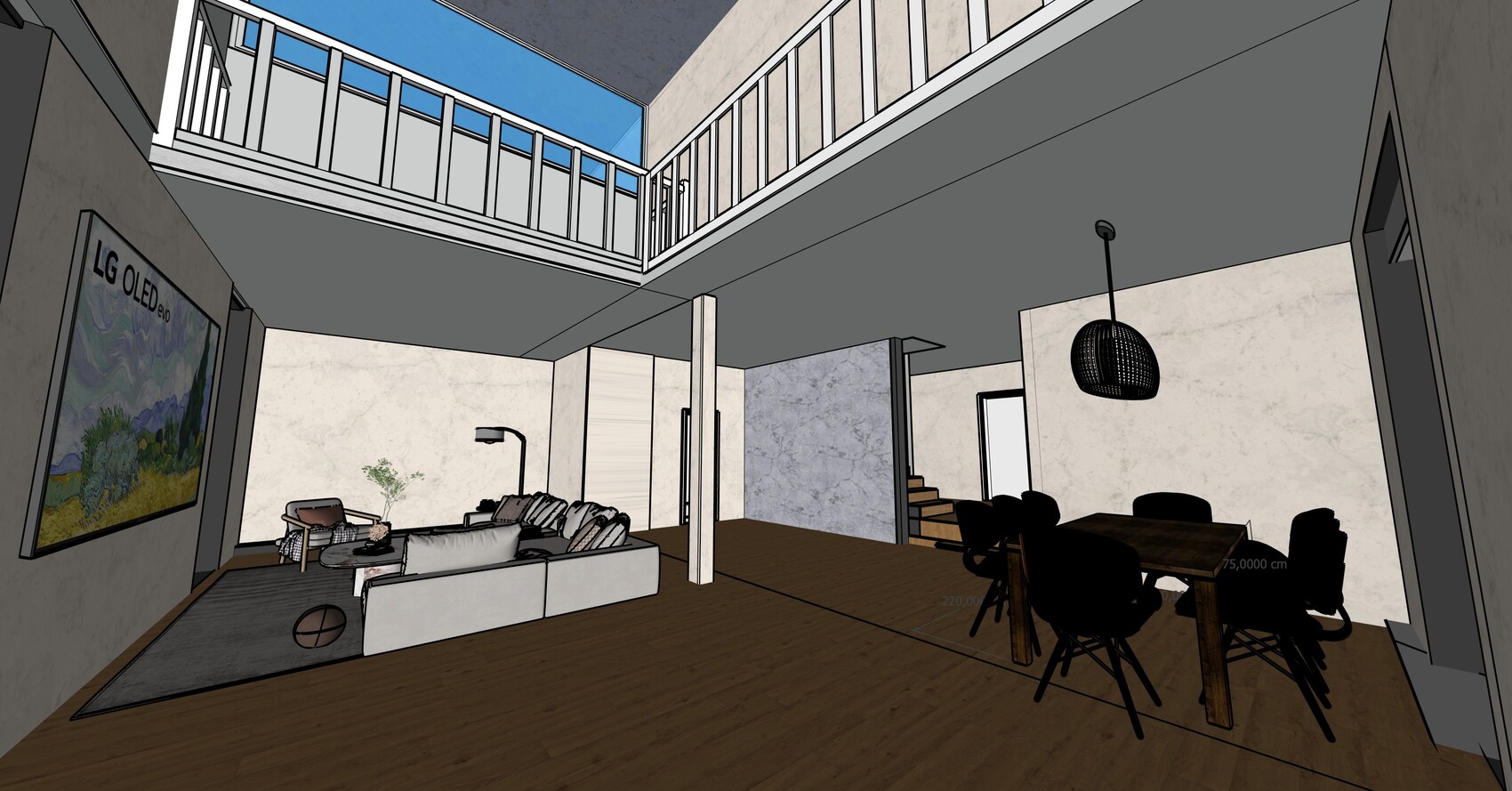

Thank you very much for all the helpful comments.
We have an appointment with the architect on Monday to discuss several points.
I used the architect’s SketchUp project file and placed some furniture.
I am attaching the 3D renderings. There are two versions:
one with the current design and another with the provisional gallery I added, based on your suggestions regarding the ceiling height in the living and dining area.
Thanks again for the support.
I will get back to you as soon as the revised design is available.

Now you have a gallery that is 0.5m (20 inches) wide in front of a bare wall without windows. Why?
This could be an opportunity to bring light into the rooms behind the wall.
How do you get onto the gallery, and how do you use it?

In my opinion, this is a common issue with experimenting using various PC programs. Everything initially seems clear and visually appealing, but people tend to overlook the importance of precise details and measurements, which you can quickly recognize on a floor plan with actual dimensions and furniture.
The original poster (OP) does not yet seem to realize that the floor plan or design will completely change as soon as any adjustment is made. If you move something here, something else shifts elsewhere.
That is exactly why the floor plan needs to be developed step by step, rather than trying to force a beautiful image backwards into exact numbers.
Therefore, there will be a completely new approach, which is not a problem at all. Imagining possibilities is always allowed.

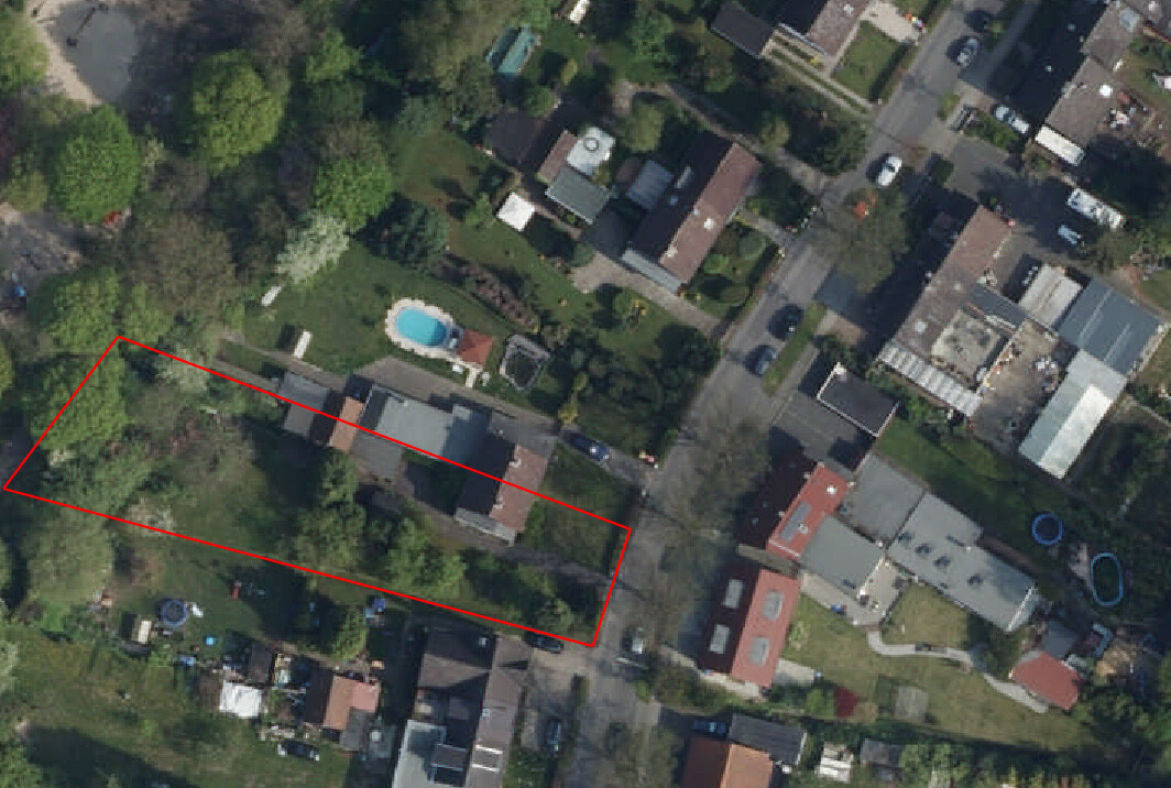

Sorry for the late reply, and thank you for your response.
Our share of the plot is 1027 square meters (11051 square feet). There is a fixed building area, and the plot is located in 21109 Hamburg.
