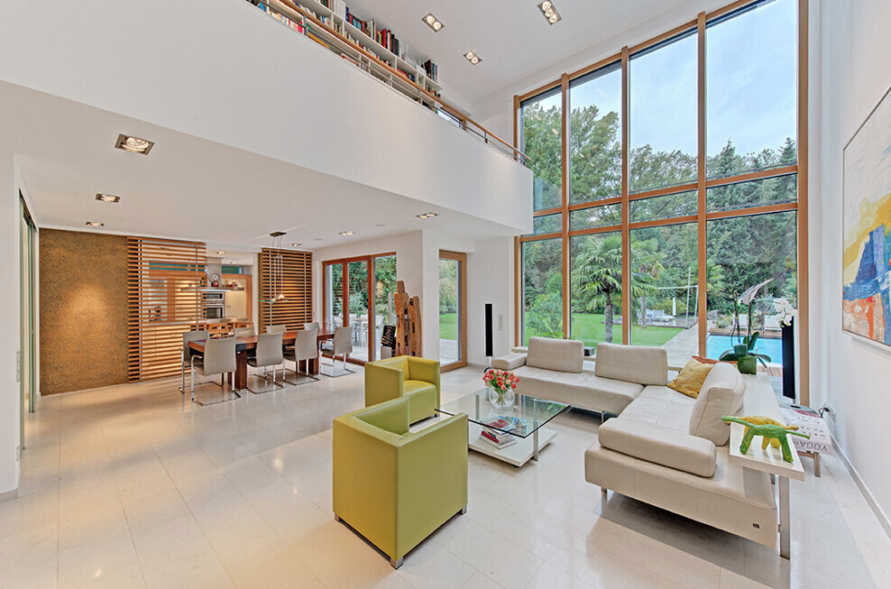

During the day, I kept thinking about your more than 70 square meters (750 square feet), 6 meters (20 feet) high open-plan cube with the huge, strongly symmetrical window fronts. Personally, I think the space would overwhelm me. I can’t imagine feeling calm or cozy in a room like that. To me, it feels more like a factory hall.
Are you sure that’s what you want? Do you know similar houses, or have you spent extended time in one?
