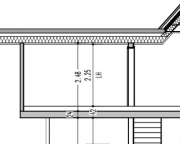

I’m reading here about 6 m (20 feet) ceilings and then this???
Cross-section of building with staircase, ceiling joists, and supports – technical drawing
2.25 m (7 feet 5 inches) ceiling height. I can only recommend choosing a different architect.

hanghaus2023 schrieb:
I’m reading about 6-meter (20-foot) ceilings here, and then this???
2.25 m ceiling height (7 ft 5 in). I can only recommend consulting a different architect.
Could it be that certain points have to align with the neighboring house? The existing old building as well as the neighbor’s house both have a prominent basement level, a main floor, and above that a small attic with a loft, totaling about 45 sqm (484 sq ft) of living space. The new build, however, is planned to have only a ground floor and an upper floor.
hanghaus2023
13 Nov 2025 13:02
Please share some photos of the existing building. The street view of the design looks quite unusual. What does the zoning plan say about roof structures?
hanghaus2023
13 Nov 2025 13:05
lucaskilam schrieb:
Could it be that certain points need to align with the neighboring house? The existing old building and the neighbor’s house both have a prominent basement, one upper floor, and above that a small attic with a loft, totaling around 45 sqm (484 sq ft) of living space. The new build is planned to have only a ground floor and one upper floor.
A ceiling height of 2.25 m (7 ft 5 in) in a new building is not considered living space, regardless of what the neighbor has. Are there as-built plans available?
