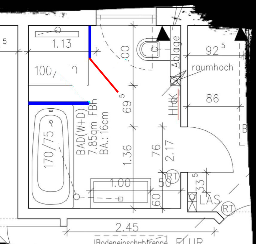

No, that’s exactly right... just imagine you’re standing in the shower... you want to get out again, after all. And, as I said, I find it very practical when a shower door opens inward. It always annoys me when I come across a shower where the door only opens outward. Then you always have water outside the shower.
kaho67423 Feb 2018 07:28
kbt09 schrieb:
No, that’s exactly right ..
If the door swings inward, it’s always in the way, in my opinion. Actually, a simple door that only opens outward would be better. And then I would hang it the other way around.
Bathroom floor plan with bathtub, toilet, sink, and door, measurements
kbt09
23 Feb 2018 07:31
It depends on the length of the vertical fixed glass panel. That’s why I wrote “definitely a swinging door, possibly a folding swinging door,” which works really well opening inward.

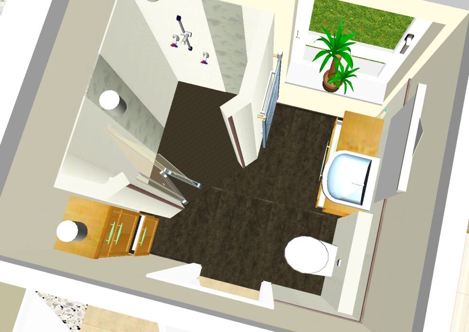

Top view of my bathroom:
Bathroom view from above: bathtub, toilet, sink, cabinets, plant on the window
kaho67423 Feb 2018 07:46
Ah, that looks better. How wide is your shower?
We have pivot doors in the guest bathroom, but double-winged. I was skeptical at first, but they work well and are completely watertight.
Arifas23 Feb 2018 08:02
I find the glass design very, very beautiful! It looks airy yet still spacious.
kbt09
23 Feb 2018 10:38
One could consider making the top glass panel a full wall. This would allow you to build a recessed shelf inside for shower gel and other items, and on the outside, install a towel radiator or at least hooks for large towels. The door and partition to the bathtub could then be made of glass.
