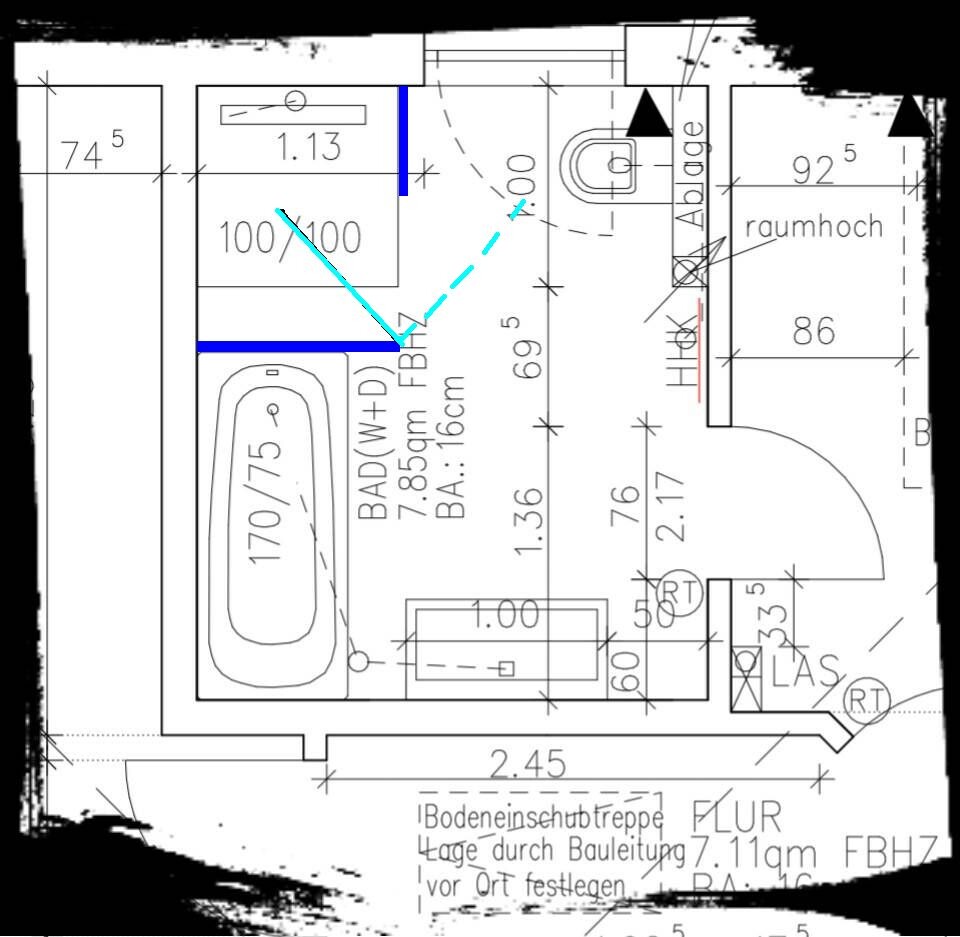

kaho67421 Feb 2018 17:50
Well then, first lie down in the bathtub and step into the shower enclosure. That way, you can see what you like.
21 Feb 2018 18:51
I would rotate the shower and place a wall between the shower and the bathtub. Of course, the bathtub should be nicely integrated with shelves around it. Then install a pivot door in front of the shower.
11ant21 Feb 2018 18:53
Arifas schrieb:
It’s definitely better to install a folding shower door that can fold away to the right and left.
Fold away where exactly – partly in front of the window? – possibly this could create some space by installing the shower door right at the head end of the bathtub. I’m tempted to imagine something like a folding screen.
Of course, install the bathtub in a stylish way
I think you have a style obsession.
Arifas22 Feb 2018 09:22
We would have chosen a folding door that opens inward. But the faucet is there as well. That probably wouldn’t look good. Hmm.
kbt09
23 Feb 2018 06:43
I would first plan the bathtub, then separate the shower area with a fixed glass panel at the top of the layout, followed by possibly another fixed glass panel and a pivot door that opens inward. Depending on the available space at the top of the layout, the pivot door could also be a folding door, making it easier to open inward after showering. This helps prevent water droplets outside the shower. I have a similar folding pivot door myself.
2D bathroom floor plan with bathtub, toilet, and sink, dimension lines visible
kaho67423 Feb 2018 06:53
kbt09 schrieb:
Good idea, but I would have the door swing the other way.
