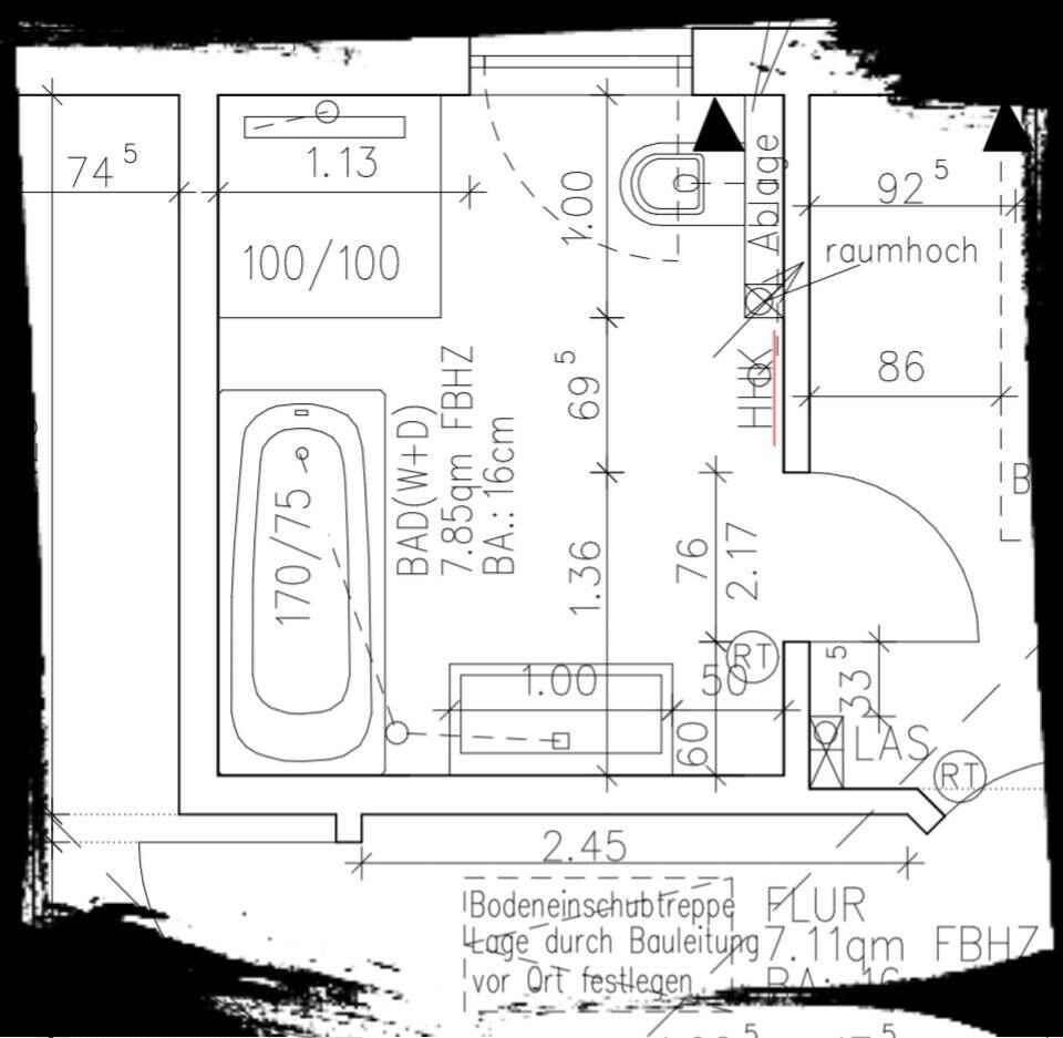

This is how the bathroom will look now. To the left of the washbasin, there is space for a tall cabinet, and to the right, a rod for towels will be installed. We are still unsure about the best way to partition the shower area. It will be flush with the floor and tiled with a drain. We are seriously considering installing a folding shower door that can be folded to the right and left.
What do you think?
What do you think?
Arifas schrieb:
We are still unsure about the best way to enclose the shower. It will be flush with the floor and tiled with a linear drain. We are strongly considering installing a folding shower door that can be folded to the right and left. What do you think? Do you have a company where you go for sample selections, or are you putting everything together on your own?
kaho674 schrieb:
Do you have a company where you go for your selection of materials and finishes? Or are you gathering everything yourselves from different sources?Both options are possible.Similar topics
