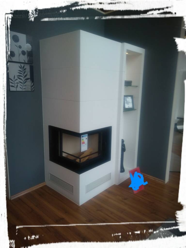

We have also ordered a fireplace and are really excited about it [emoji7]. From the front, it will be installed in the front left corner, built as a mirror image
