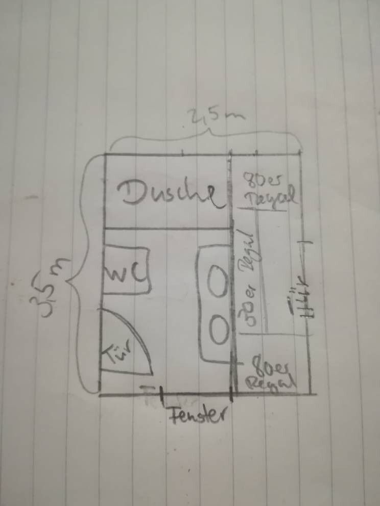

On the right, I don’t see any space where the vacuum cleaner could go; on the left, it would probably be behind the door right in the way and would be a prime trip hazard. So, on the right, but about half a meter (20 inches) wider.If you looked more carefully, you would see the vacuum cleaner too. The mop and bucket are next to it at the very bottom, and above that are the potatoes.
Aotearoa schrieb:
What if you rotated the master bathroom and the pantry so that the partition wall runs horizontally instead of vertically? (In the last design) Then the pantry could have a door (sliding door?) in the middle, making it easier to enter and allowing for more practical storage, like in ypgs’ example.
That would be ideal for the pantry. I’m just worried that the bathroom would end up feeling like just a shower cubicle with a toilet inside. It’s already quite small, and then it would also be narrow, making the layout less practical. Right?A general question: do you think it makes sense to “buy” a bit more living space and extend the whole structure 50cm (20 inches) to the front or back? Or maybe add an extension like in ypgs’ suggestion? Budget-wise that might work out, but then we’d have to give up the fireplace... which would be a shame...
If you looked closely, you would also see the vacuum cleaner. The mop and bucket are next to it, at the very bottom, and above that are the potatoes.Of course, the potatoes [emoji23]. I always forget them in my drawing [emoji28]. And my husband didn’t show me how to change the vacuum cleaner bag either. Pff.Jokes aside: I think proper planning is really important in a tiny pantry. It would be a shame if you were missing exactly 5cm (2 inches) or so.
