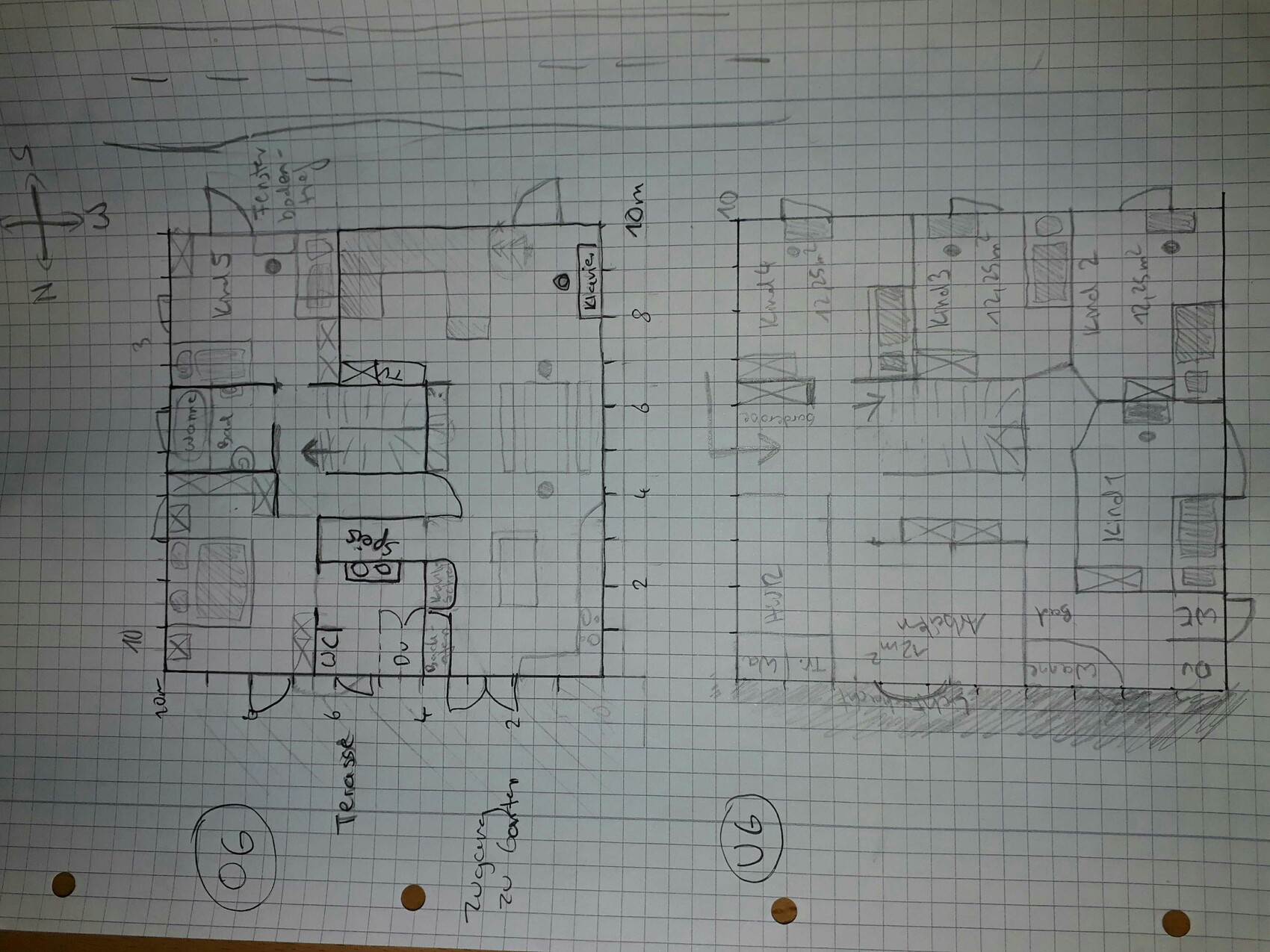

Dear fellow contributors,
I’m sharing our first attempt at the floor plan. Unfortunately, I can’t fill out the list because copying it over on my phone doesn’t work properly, sorry.
Key data:
5 children between 0 and 11 years old
2 adults in their mid-thirties
Plot of about 900 sqm (9700 sq ft), facing north
Building window edge on the street side: 17.35 m (57 ft)
Sloped site; within the building window, the ground rises about 2 m (7 ft) over 10 m (33 ft) from front to back
We want 5 small children’s bedrooms, a slightly larger office for working from home, a master bedroom, three showers, three toilets, a bathtub, and access to the garden through the living room on the upper floor. One wall in the children’s rooms should be removable later.
The attic is walkable.
We are allowed to build 2 full stories, with a ridge height of about 12 m (39 ft) and an eave height of 11.6 m (38 ft).
We would prefer a hip roof.
The current drawing is 9.5 by 11 m (31 by 36 ft), but we would like to have around 195 to 205 sqm (2100 to 2200 sq ft) of living space later; garage or storage will be added.
The back wall of the house is embedded up to about 2 m (7 ft) into the slope.
I will try to attach a rough overview of the plot.

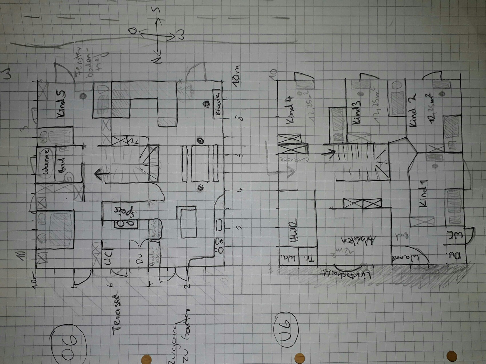

I hope you don’t mind, but I redrew the plans. I think in the end we will show up at the architect’s office with a huge stack of plans [emoji23]
The wall thickness is not shown, but there is still some space on the left and right, and the current budget is based on an external dimension of about 11.35 by 11 meters (37.2 by 36 feet).
I find a lot of things look small. However, when I compare with floor plans from, for example, Danwood, many rooms have similar dimensions. So there are obviously others besides us who can’t manage 15sqm (160 sq ft) children’s rooms and bathrooms. The design has been optimally validated for our daily routine.
Therefore, I’m daring enough to post my draft. Feel free to critique it thoroughly.
For me, a home office (if at all) will only be relevant once the three children have moved out. Until then, I can stay with a close colleague. So, for now, that requirement is out of the picture and makes planning easier.
