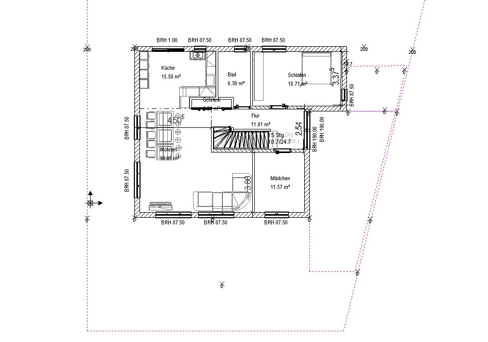

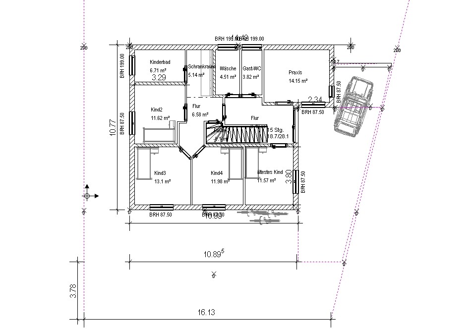

So, here is the promised draft.
The windows can still be adjusted... There is a lot of flexibility with them. In the basement, the rear (southwest) area could later be separated. This would create a small two-room apartment. However, the practice room, bathroom, and one room would remain part of the common area... I found it difficult to create an optimal solution here, just a suggestion to consider. In the basement, the access to the bathroom has created a closet space, which is quite practical for small bedrooms.
Straight staircase: a straight staircase is known to take up a lot of space. Since the many rooms need to be accessed via a corridor, it would be a waste not to use this corridor space also for the staircase. I made sure that at the bottom and top of the plan, the rooms have a functional depth of more than 3 meters (10 feet).
The bedroom on the upper floor should now be sufficiently wide. At the end of the corridor, there is still space for a chest of drawers.
What I find important: the second staircase to the attic. I am not very skilled with cross-sections, but there should be some standing space.
Unfortunately, I was not able to place the kitchen on the south side. The room in the north offered itself well as a kitchen, and I don’t see any major disadvantage, since tomatoes and other vegetables tend to shrivel earlier in the south exposure anyway – there is enough light coming in... and if the children are outside in the garden anyway, they should have a short way to the fridge, rather than having to walk through the living room and disturb others.
The terrain will of course need adjustment – some soil removal on the side, a retaining wall on the right, and the terrace raised slightly at the back...
