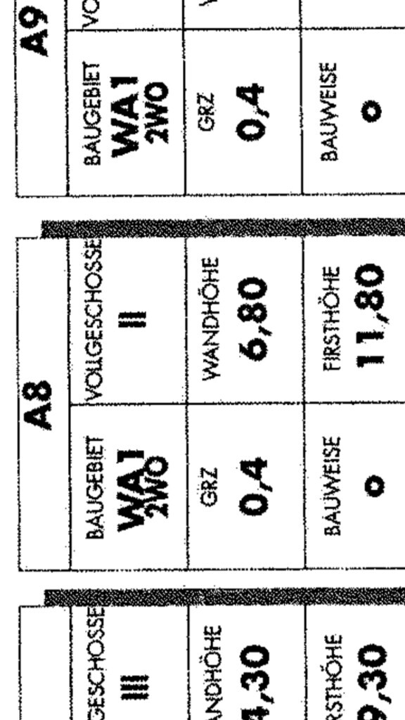

The consultation will come later. We haven’t even signed the contract with this company yet. Once that happens, the detailed planning will begin.
Is there something wrong with this approach? It seems to me that quite a bit has already been done for us free of charge, even though we haven’t signed anything yet. Because of that, we actually feel well taken care of by the general contractor. We were also able to speak with a few previous clients who were very satisfied. Our plan is to buy the plot and sign the house contract within the next two weeks, and then things will become more concrete.

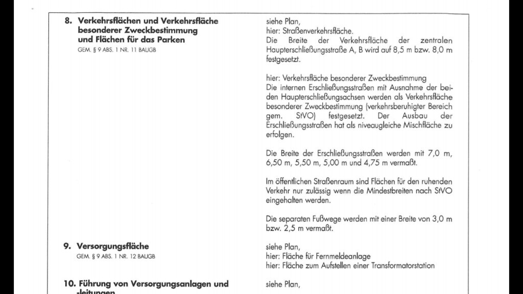

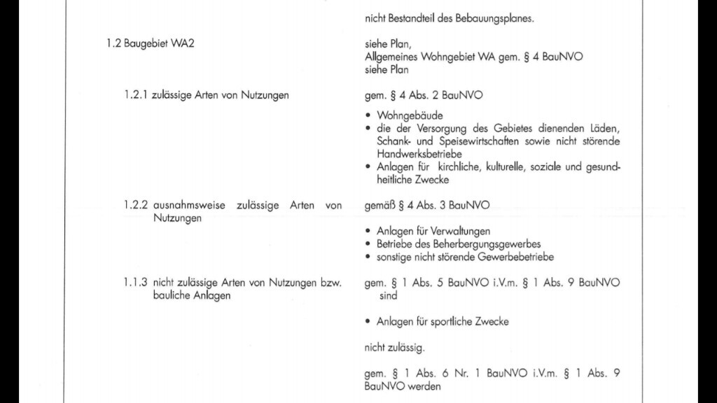

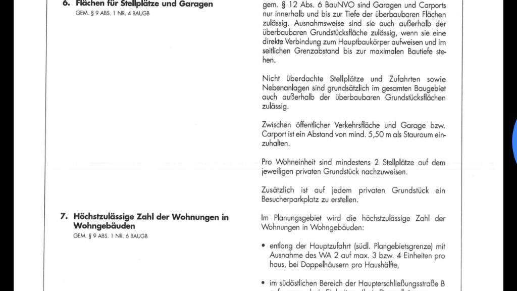

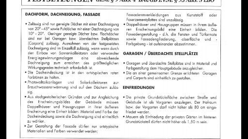

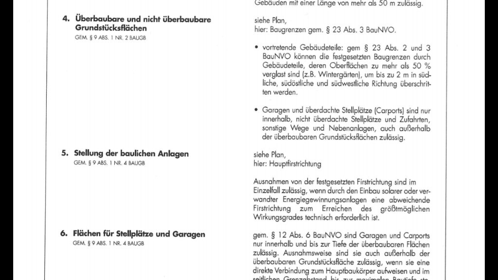

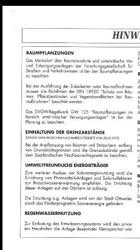

So, here is this for now. I need to prepare the development plan (building plan) accordingly tomorrow.
Of course, please share the development plan here.
Maybe it will reveal some additional possibilities. For example, so that we can "verify" the facts to understand the purpose of such suggestions
As a thought, I also considered a split-level design with three children’s bedrooms facing north, which would really allow for multifunctional use by preparing a separate apartment and allocating suitable space for a practice. might make sense. Five half-levels could bring the solution closer.
Arifas schrieb:
One more question about the plot: there is a large tree within the building zone and three other smaller ones close by. What do the development plan (textual regulations) and any local tree protection ordinance say about removing them?

@11ant
Then please translate the development plan once it is complete and
@Arifas
Please share more details about the possible appearance and budget limits.
(Townhouse or creatively designed roofs as well, if permitted)
If I missed anything: please send it again
