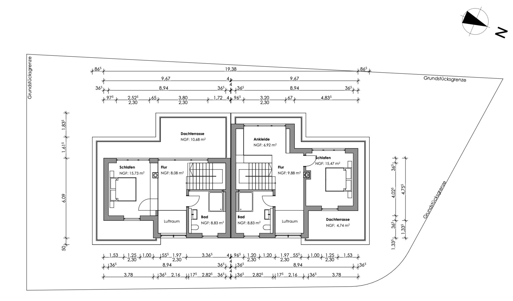

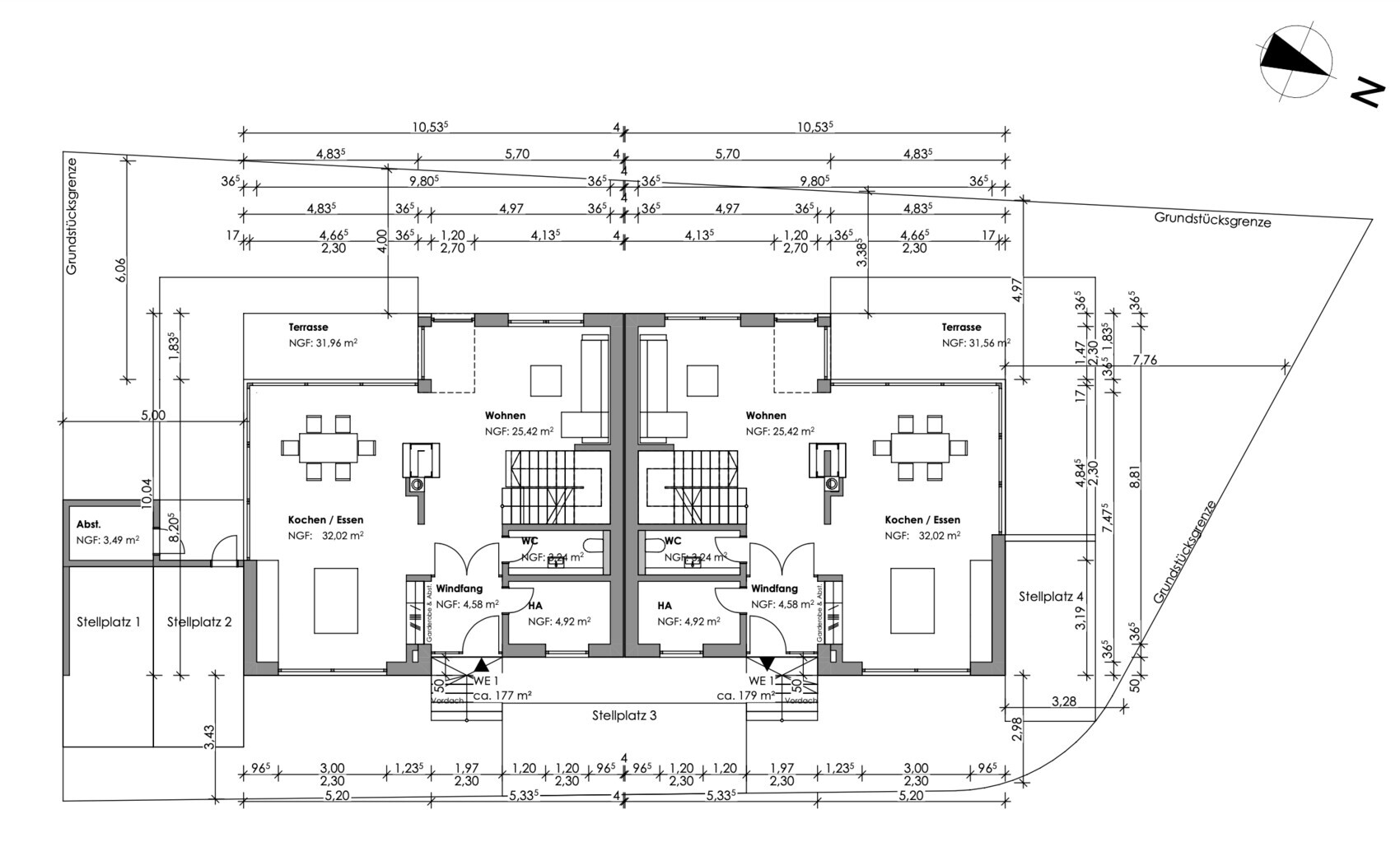

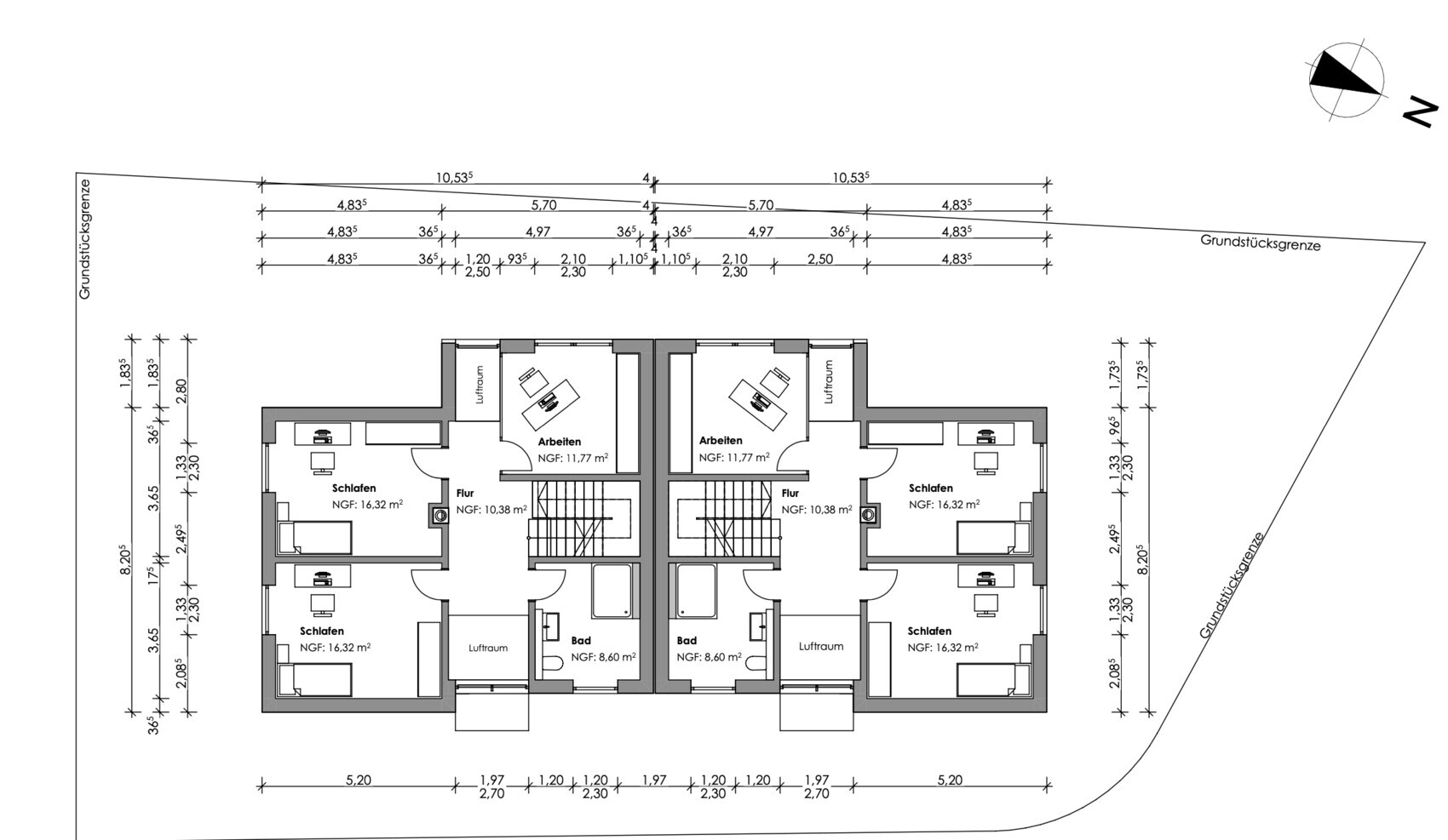

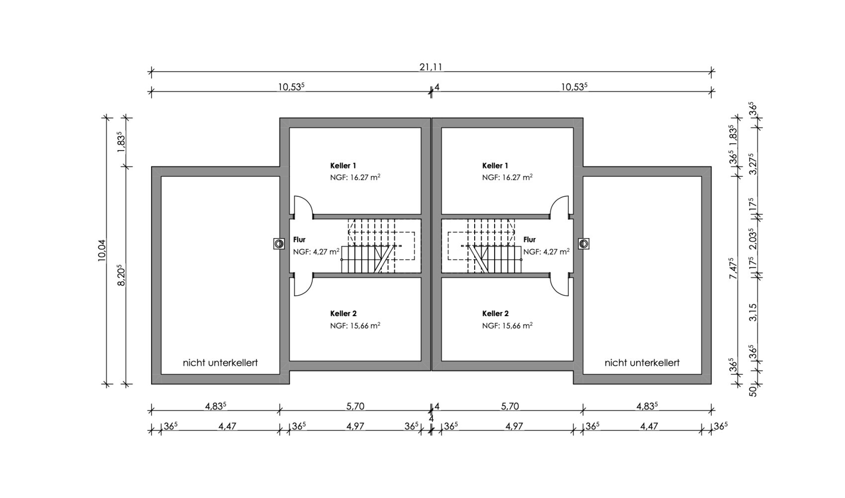

Dear forum,
we are starting a new project with a semi-detached house and have already purchased a suitable small plot of land for it.
We have gone into more detail with the architect during the preliminary building inquiry for the design options and would appreciate any feedback on the two planned variants.
Client requirements
Style, roof type, building type – Modern, flat roof, semi-detached house
Basement, floors – Basement / ground floor / first floor / penthouse level
Number of occupants – currently 2
Open or closed architecture – open
Conservative or modern design – modern
Open kitchen, kitchen island – an open-plan kitchen with a freestanding island + L-shape
Number of dining seats – 6
Fireplace – yes (possibly gas fireplace)
Music/stereo wall – yes, at least 2 meters (6.5 feet) wide
Balcony, roof terrace – penthouse level with roof terrace
Garage, carport – carport
Utility garden, greenhouse – garden as shown in the floor plan
Who is responsible for the design: architect
What do you not like? You will surely tell me 🙂
What is the most important/fundamental floor plan question in 130 characters?
The semi-detached house will be built on a relatively small plot (540 square meters (6,000 square feet)). Therefore, the possibilities are quite limited.
A large living, dining, and kitchen area with the freestanding island mentioned above was important to us, but still divided into different “zones”. Also, privacy from the neighboring house.
So far, we are very satisfied with the designs.
However, I would like to position the kitchen island crosswise. This would mean losing some space on the left and right. In addition, a back kitchen unit under the window facing the street. This would naturally no longer be floor-to-ceiling but adjacent to the kitchen unit.
Furthermore, we do not yet have a free wall for TV, etc. Appliances in front of the window are not preferred.
The following furniture should fit here:
An L-shaped kitchen with a freestanding kitchen island (At the moment we have an island with the following dimensions:
Back kitchen unit 3 meters (10 feet) wide / peninsula 2.10m x 1.17m (6.9 feet x 3.85 feet)
A dining table 2m x 1m (6.5 feet x 3.3 feet)
An L-shaped sofa 3m x 1.90m (10 feet x 6.2 feet) on the longest side
A lowboard for TV / sound system approx. 2 meters (6.5 feet) wide
I welcome any suggestions for improvement and am already excited...
Best regards!

RomeoZwo schrieb:
If a design is made for a buyer or tenant who is still unknown, ... I don’t need to repeat my usual mantra here, “A semi-detached house has TWO halves” ;-)
I like the concept of mirrored identical units, but I would allow the first occupants of the second half (whether buyers or tenants) to customize the non-load-bearing walls.
RomeoZwo schrieb:
The open space in the entrance area spanning three floors is really impressive. But it also acts as a climate and acoustic chimney, not only with desirable effects.
