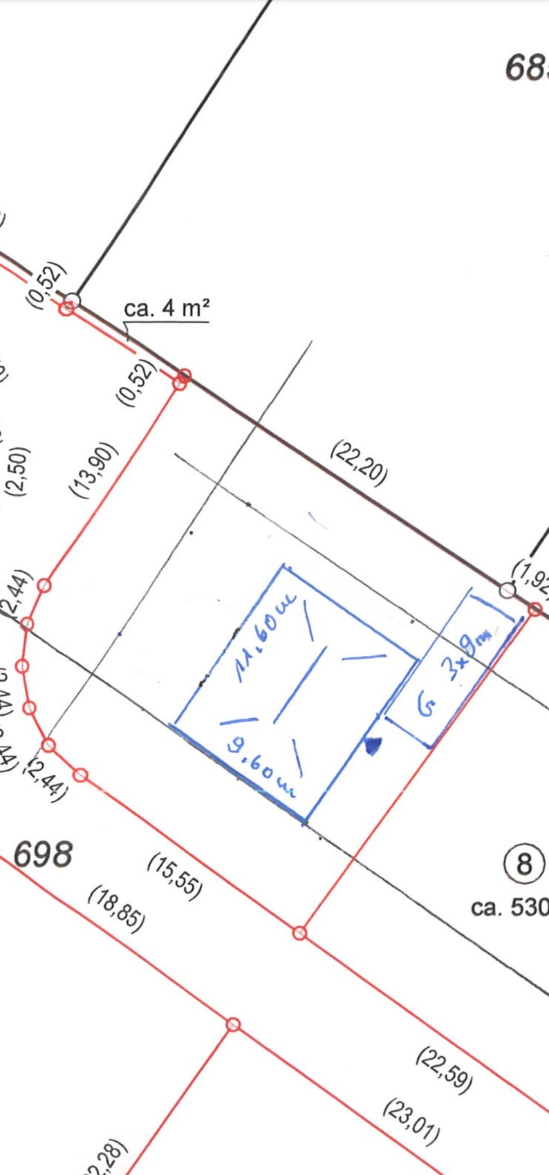

Below is a rough sketch of our plot including the house footprint (still a bit smaller here) with garage. The orientation of the sketch corresponds to the cardinal directions (so top = north).
