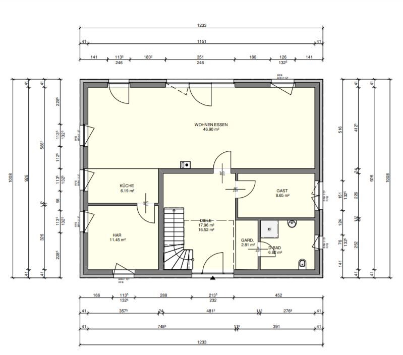

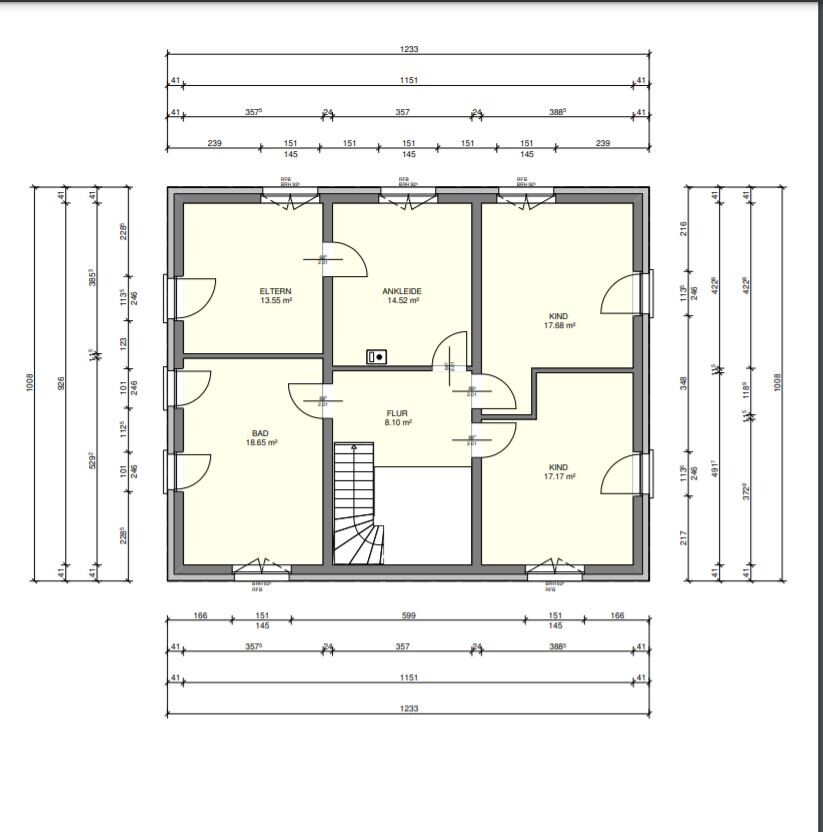

My girlfriend and I are currently deep in planning our new build (urban villa, about 185 sqm (2000 sq ft), without a basement). We already have the plot (521 sqm (5600 sq ft)) and a builder (Heinz von Heiden) selected.
The actual architectural consultation for the detailed planning will take place next year. At the moment, we only have a draft that we created together with the sales representative.
We would appreciate any feedback from you regarding whether there are any major mistakes in our planning or if there might be smaller suggestions for improvement.
Our main considerations are as follows:
- Living/dining/kitchen area should be open and not too cramped (~53 sqm (570 sq ft))
- A gallery in the entrance area as a small visual highlight is important to us
- Master bedroom with a relatively large walk-in closet on the upper floor
- 2 children’s bedrooms
- Smaller office on the ground floor, which can also be used as a 3rd children’s room if needed
- Large bathroom for parents and children on the upper floor, as well as a shower/WC on the ground floor for guests and as an alternative when the children grow older
- Attic will not be developed (25° roof pitch) but used only as storage space (folding attic stairs are installed)
- Utility room with 11 sqm (120 sq ft) should be large enough to accommodate the air source heat pump, water tank, ventilation system, as well as washing machine, dryer, and water crates
However, we still have some open questions:
- Should we build a reinforced concrete staircase with storage space underneath?
- Should we place a pantry next to the kitchen (and thereby sacrifice part of the hallway)?
- Is the ground floor hallway too large at nearly 21 sqm (225 sq ft)? Where could space reasonably be gained?
Many thanks and best regards
Julian

If you have to omit something, which details or extensions?
- Hallway on ground floor could be smaller
Why did the design end up like this?
- Standard design with minor adaptations by us

Sounds reasonable 🙂 Unless the soil is a nightmare, those numbers are well estimated 🙂 But I find the house price hard to believe. With a 12x10 meter (39x33 feet) footprint, that’s about 200 m² (2,150 sq ft) of living space. Even at an extremely “low” 2,000 EUR/m² (186 USD/sq ft), you’re already at 400,000 EUR. And for a house of that size, 15,000 EUR for structural upgrades is usually not enough. You can almost spend that amount on electrical work alone :/

It seems to me that you are still at a very early stage and haven’t explored the floor plan topic in enough detail. A few obvious points that stand out right away (does Heinz von Heiden really offer such a floor plan?):
+ If the guest room on the ground floor is intended to become a children’s room, it is far too small. At 8 sq. meters (86 sq. feet), it’s hardly usable as a guest room either.
+ The utility room is only accessible through the kitchen – do you really want to carry laundry through the kitchen every time? Also, the door obstructs the kitchen space significantly.
+ Staircase right at the entrance: consider whether you really want this, especially regarding carrying mud upstairs (this becomes more relevant with kids and their friends).
+ The same applies to the toilet on the ground floor: dirty shoes are left in the cloakroom, but you still have to walk through there every time to get to the toilet.
+ The bathroom upstairs is very large, but there is no storage space.
+ If you need to use the toilet at night, it’s quite a long way.
This is just a quick overview for now. My advice: look at many more floor plans again, there’s a lot possible with a house of this size!
