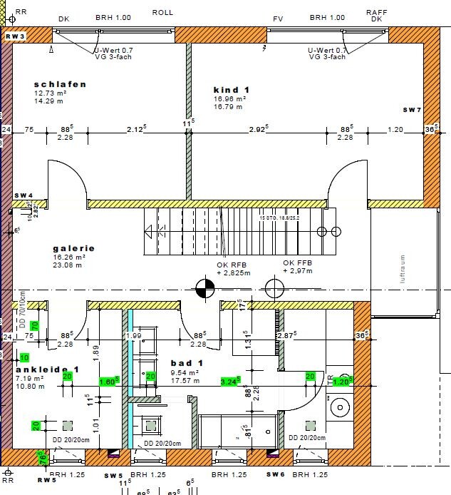

Dear all,
Attached is the current floor plan of our family bathroom. The masons will start working on the interior walls in the next few days.
We decided not to separate the toilet with a sliding door, so the walls will not be full height but only 1.20 m (4 feet) high as simple privacy walls. The short wall section extending by the partition next to the bathtub will be omitted.
We expect this will create a slightly more spacious feeling and allow more light into the bathroom, which is not very large anyway.
Overall, we like the layout quite well, but it doesn’t really create a "wow" effect. So our question is: could it be improved significantly, or should we leave it as it is?
The window side faces east, and the right side on the plan faces north. The windows and utility room positions are fixed. Doors can be adjusted.
Grundriss eines Badezimmers (Bad 1) mit Waschbecken, Toilette, Dusche und Türen.
16 Jun 2019 15:48
But the drainage location is already fixed, right?
Where would it be? By the toilet?
MadameP16 Jun 2019 16:01
But the drain position is already fixed, right?
Where exactly is it? By the toilet?
You can see the drain in the plan in the purple-shaded wall section "under" the bathtub.
It is fixed, yes. If I understood the plumber correctly, the layout of the fixtures is still flexible, as they will do it in the floor...
kaho67416 Jun 2019 16:57
So, the door to the utility room is also accessible from the hallway? (Always those cropped floor plans :rolleyes
What would bother me a lot: the sinks are quite dark. Could you quickly mark the room dimensions? I can’t make it out...
kbt09
16 Jun 2019 17:14
If I understand correctly, all these "modesty" partitions are now supposed to be only 120 cm (47 inches) high, so that the area around the sinks is also brighter.
And yes... what exactly is supposed to go into this utility room?
MadameP16 Jun 2019 19:25
kaho674 schrieb:
So, the door to the utility room can also be accessed from the hallway?
In theory, yes, but in practice we would prefer access from the bathroom. Towels, first aid kit, toiletries stock, toilet paper, cleaning supplies...
kaho674 schrieb:
Could you quickly sketch the room dimensions? I can’t quite figure it out...
3.015 m (9 ft 11 in) deep = hallway-exterior wall / 3.26 m (10 ft 8 in) wide
kbt09 schrieb:
If I understood correctly, all these "privacy" partition walls are only going to be 120 cm (47 in) high, so that the area around the sinks is brighter.
Correct. For exactly that reason. So, the same height as the pre-wall installations and the wall tiles.
kbt09 schrieb:
And yes... what exactly is going to be stored in this utility room?
Washing machine, dryer, laundry basket, shelves with: see above, towels, first aid kit, toiletries stock, toilet paper, cleaning supplies. This is only the laundry utility room; everything else is downstairs in the technical room (i.e., water crates, vacuum cleaner, recycling paper, etc.)
