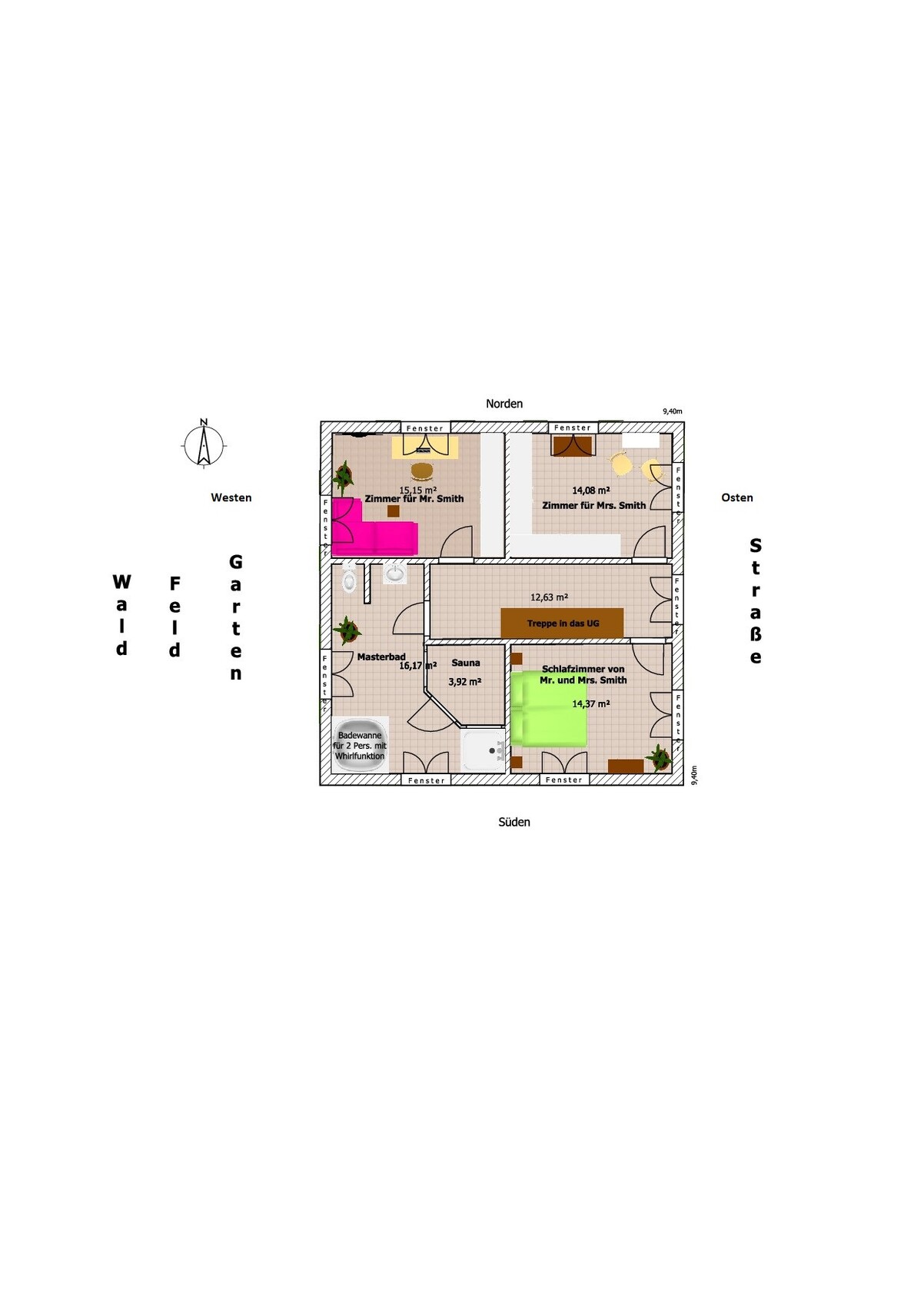

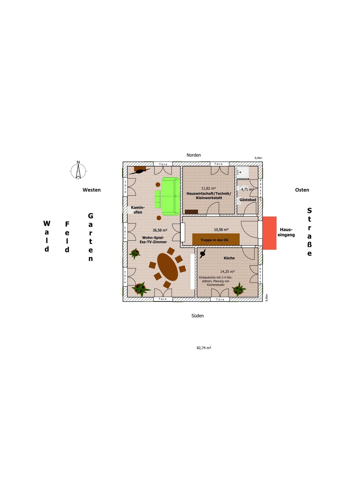

I kindly ask you to review the floor plan of our future house and thank you in advance for your time and attention. The floor plan has not yet been reviewed by an architect.
--> Despite many efforts, I was unable to make the drawings larger. They originate from Sweet Home, were converted into a PDF, and then into a JPEG. If there is a better way to do this, please let me know. Otherwise, I hope it won't be too much trouble for you to enlarge the floor plans on your computer. It is possible, but as mentioned, I could not upload them in a larger size on this site. :-(

Nothing particularly stands out; the floor plan is pragmatic and kept simple due to our financial situation. We emphasize brightness, openness, and transparency in every room, aiming for as many windows (or door windows) of the same shape and size as possible. Except for the main entrance side on the ground floor, all openings are floor-to-ceiling windows or patio doors, allowing direct outdoor access from every room. On the upper floor, the windows should be identically sized and arranged as symmetrically as possible. Due to budget constraints, practical reasons, and the extra cost and maintenance of window grilles (instead of mullions), we decided against using door windows upstairs.
What do you dislike? Why?
Everything is satisfactory and fits our budget. We would prefer more door windows.
Price estimate by architect/planner: fixed, already commissioned offer/order EUR 312,780.00 (house only, excluding garage/carport, landscaping, incidental construction costs, land, etc.)
Personal budget limit for the house including fittings: EUR 400,000.00
Preferred heating technology: gas condensing boiler plus solar thermal system (according to legal requirements)
If you have to give up something, which details/extras
- Can give up: possibly a new kitchen
- Cannot give up: window muntins (grids)
There has been no architect consultation yet. The floor plan is a mix of example floor plans from various prefab home providers and our own ideas and requirements. Two special features for a relatively small house are, in our view, the somewhat larger utility room (which should be nearly like a second kitchen for hobbies) and the sauna in the master bathroom, which required a larger bathroom than we would need without the sauna.
What do you consider particularly good or bad about it?
Good:
  • We live as a couple only, so each of us has one closet and “storage” room
  • The guest bathroom on the ground floor will also include a shower
  • We own few pieces of furniture and value pictures and plants more, which allows us to have many windows and glazed doors
Bad:
  • Relatively narrow hallways
  • What is the most important/basic question about the floor plan in 130 characters?
  • For now, our concern refers only to the house floor plan, not its placement on the plot, as we are still waiting for information from the surveyor and architect. We welcome suggestions for improvements, additions, and criticism. It is important to us that the house looks harmonious, balanced, and “pleasing” from the outside. Due to lack of expertise in architectural harmony or facade design, we initially focused only on symmetry in the exterior facade. We do not want a house that looks unstructured or chaotic from the outside. Nor do we want too many different window shapes and sizes. On the ground floor, every room should allow access to the garden.
Floor plan of a house with living room, kitchen, guest bath, utility room, and stairs to the upper floor.
Floor plan of a house with two bedrooms, bathroom, sauna, and stairs to the basement; north is up.

Pinkiponk schrieb:
Addendum:
Sorry, I forgot to mention earlier. We have a bed with a very high headboard that is screwed to the wall. Therefore, we need a solid wall without windows behind the bed. This means we probably cannot place the bedroom on the garden side.
Your bedroom faces south and west. So, the sun will warm up the bedroom until sunset during the summer.
It’s not a disaster, but on hot days it can get uncomfortable.
Swapping the bedroom with Mr. Smith’s room could be an option if you’re willing to give up the symmetrical arrangement of the windows on the east side. This way, either a strip of windows above the headboard or one or two narrow windows next to the bed could be installed.

ltenzer schrieb:
Your bedroom faces south and west, so the sun heats it up until sunset during the summer.
It's not a disaster, but it can get quite uncomfortable on hot days.
Swapping the bedroom with Mr. Smith’s room could be possible if you are willing to give up the symmetrical arrangement of the east-facing windows. Then, either a horizontal strip window above the headboard or one or two narrow windows next to the bed could be installed.
Symmetry, or rather external harmony, is quite important to us. However, your suggestion is useful, and we will discuss with the architect how we might relocate the bedroom.

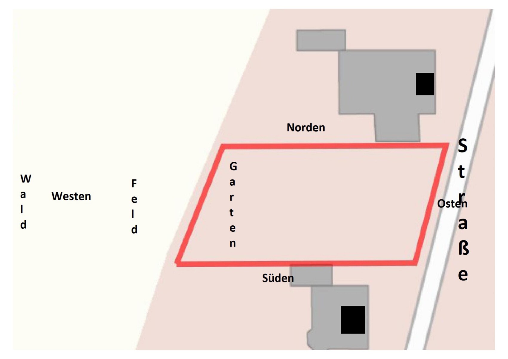

4 Jan 2020 13:33
ltenzer schrieb:
Which floor plan suits a house best depends greatly on the plot and the position of the house on it.
Is there at least an excerpt from the development plan with a building envelope?
Because a house without land is like a sauce without a main course—you don’t know if they will go well together.
Attached is the site plan. I still need some time to prepare the development plan for online use.
Site plan: red garden in the center, north at the top, road to the right; fields on the left, buildings top/bottom.
