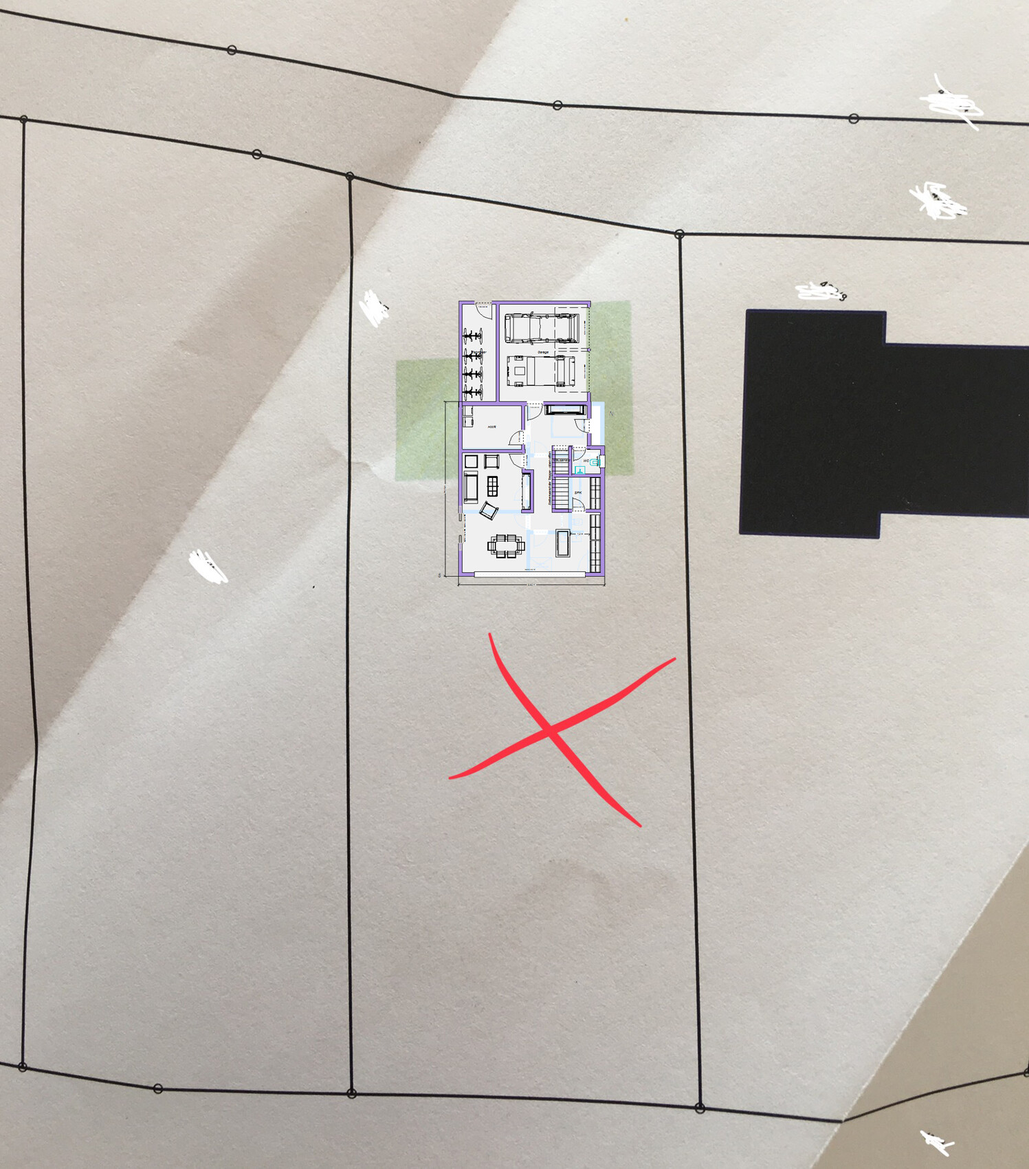

kaho67415 Jul 2018 14:53
I thought the house would be roughly positioned like this:
Site plan with small building footprint on the property and an area marked with a red X
Maybe it’s better to leave out the bicycle area and then slide it flush against the left side of the house for a more comfortable driveway. Or is the driveway not actually at the top of the plan?

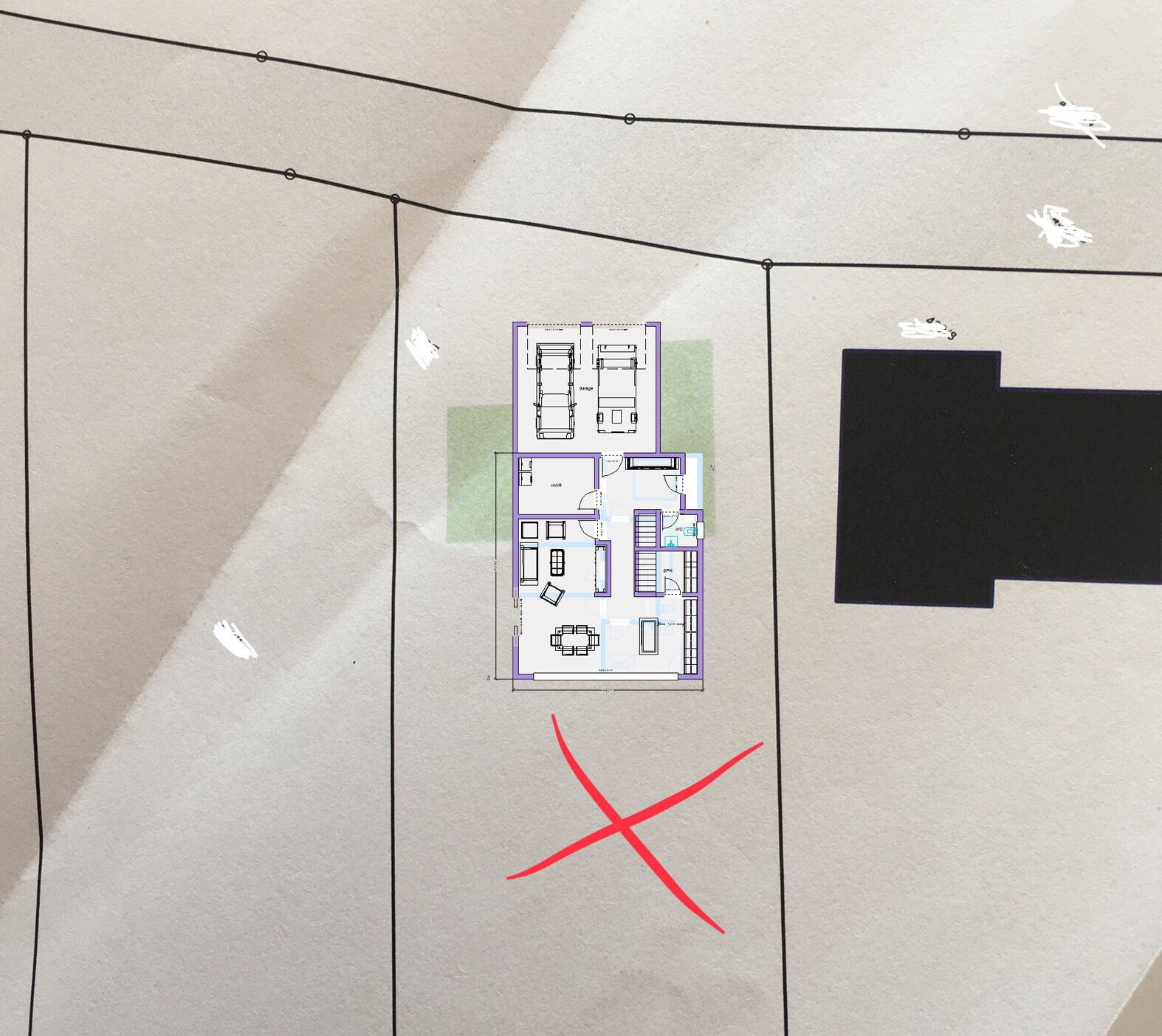

face2615 Jul 2018 14:59
...why have a driveway at a 90-degree angle at all?
kaho67415 Jul 2018 15:10
Yes, it's best to drive in forwards.
Floor plan of a house on a plot with parcel boundary and red X-cross

15 Jul 2018 16:32
Above is essentially the street, which has no sidewalk and is mostly single-lane. It ends as a cul-de-sac three properties further down. The lot slopes upward sharply at the front along the street, so with the garage positioned to the right of the building, the driveway would be very short unless we move everything further back on the lot.
We preferred to have the garage on the side since it looks better on our flat-roof house, and especially because we did not want to lose another 6–7 meters (20–23 feet) of lot depth. We purchased 1100 sqm (12,000 sq ft) and have several plans and projects. With a terrace, we would already be building on more than half of the lot. Additionally, the last 6 meters (20 feet) of the lot have some limitations due to a utility easement. That’s why we are considering placing the double garage on the side of the building.
