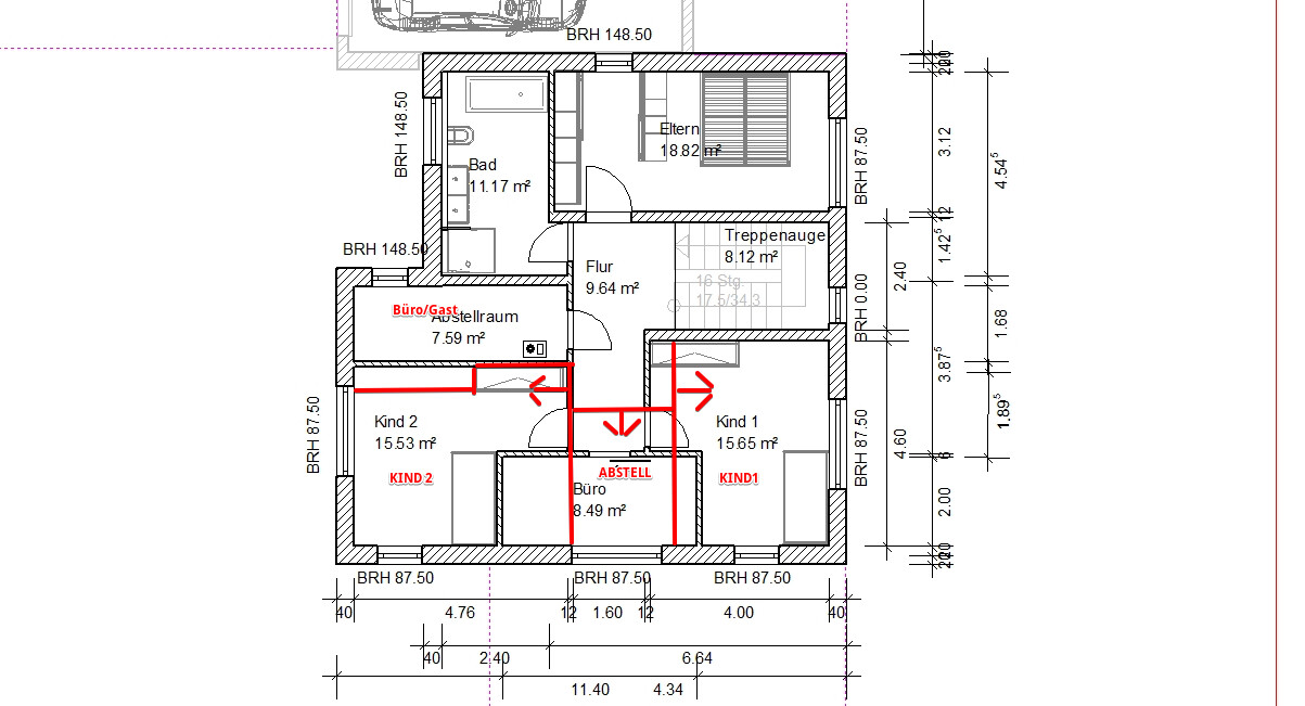

develloper6 Nov 2016 11:56develloper schrieb:
Hello
Just a quick idea for the upper floor?
I already had that, also fixed in place. However, I thought the south side was too valuable
Regards
develloper6 Nov 2016 12:29ypg schrieb:
also a private office room is welcomeThat doesn't sound like a home office to me, so I don't think having it on the south side is necessary for filing, research, and paying bills.
Otherwise, it only works with the cramped room in the middle, that's true...
@Häuslebau3r
I can also design a completely different house
RegardsThat’s not what I meant, Yvonne, I hope you understand that.
I just wanted to say that sometimes you might need to help the original planner see beyond their initial ideas a bit, which can then unconsciously lead to a different (and potentially better) direction they hadn’t considered.
You have nailed the floor plan exactly as wanted; now it’s more about finding the right solutions for the interior.
