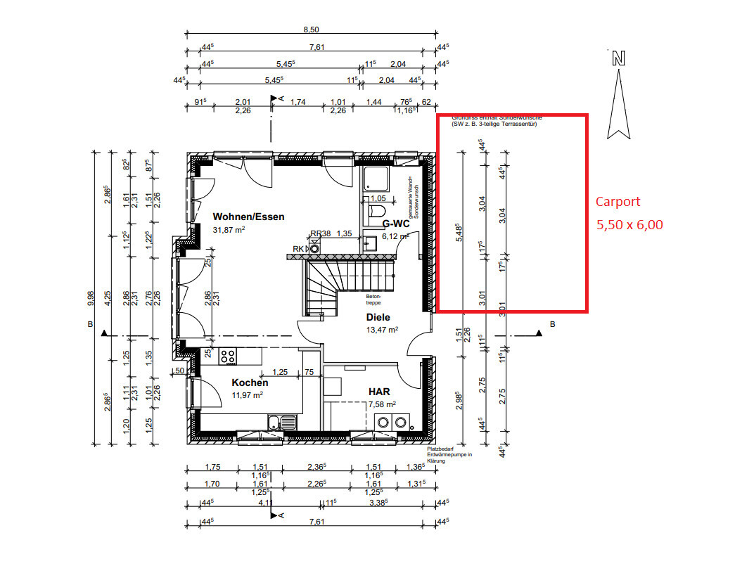

MiTo2020Hello everyone,
We are slowly but surely getting a bit frustrated with the floor plan design and could really use some different opinions and ideas.
Here are the most important details:
Attached you will find the latest draft from our potential builder.
It’s a city villa with a flat or low-pitched roof with a maximum slope of 10 degrees and a green roof, which we want to have constructed as a hipped roof.
Due to the building plot’s size restrictions, our house can be a maximum of 8.50 m (28 feet) wide. We aim for 130–135 m² (1,400–1,450 sq ft) of living space.
Ground Floor Requirements:
- Side entrance on the east side with an adjacent carport, possibly also on the south side
- Small entrance hall (currently wasted space)
- Utility room should be at least 9 m² (97 sq ft)
- Staircase preferably as shown or a half-turn staircase (maybe with storage under the stairs)
- Guest bathroom with a shower
- Cloakroom niche
- The kitchen layout should be roughly similar to the floor plan
- The fireplace is unfortunately misplaced—it should actually be where the couch is. According to the builder, this is not possible with this city villa design.
On the north and west sides, we have a nice field next to the property, so we want windows facing those directions.

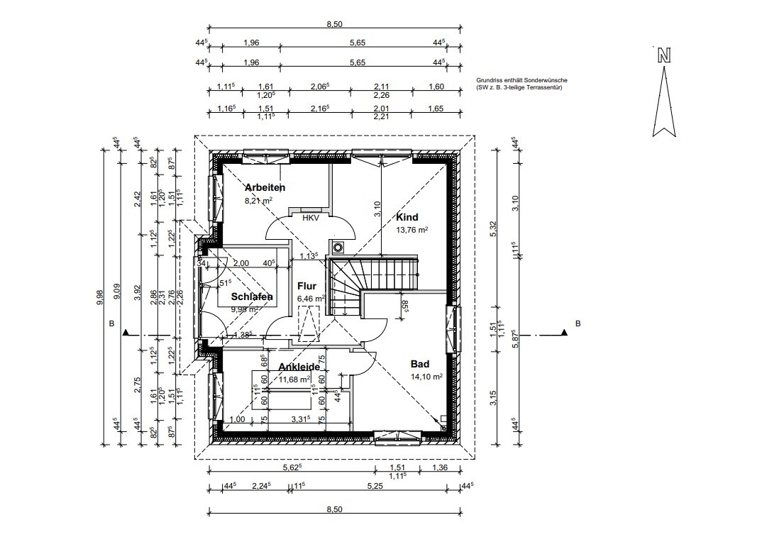

Upper Floor Requirements:
- Circulation space connecting bedroom, dressing room, and bathroom, with the bathroom also accessible from the hallway
- For the bed, we need at least 3.80 m (12.5 feet) of space, and we have about 6 m (20 feet) of wardrobe (Ikea Pax) that needs to be accommodated
- Home office
- Children’s room
Maybe you have some ideas on how to optimize this floor plan. We are looking forward to your suggestions.

You should read https://www.hausbau-forum.de/threads/grundriss-planung-unbedingt-vor-beitrag-erstellung-lesen.11714/, which is pinned at the top of this forum section, and update your post accordingly.

Myrna_Loy4 Nov 2022 16:49I find the walk-in closet, at just over 15 sqm (160 sq ft), quite wasteful for such a compact floor plan. Why not place the wardrobes against the wall instead of as an island? Then you could put a bench or something similar in the middle.
The upper floor needs to be completely redesigned. The bathroom, walk-in closet, and bedroom are excessively large overall and take up too much space without feeling spacious or being practical.
Start with a redesign of the upper floor and then work your way down to the ground floor.
Pitiglianio4 Nov 2022 17:18The walk-in closet is planned to be 11.7 sqm (126 sq ft) according to the design. However, in a 130 sqm (1,399 sq ft) house, I would always plan without a walk-in closet.
The bathroom on the upper floor is also too large for the size of the house, especially since there is already a 6.5 sqm (70 sq ft) shower bathroom on the ground floor.
On the ground floor, perhaps consider placing the kitchen on the north side to benefit the living and dining area, which could then be located on the brighter southwest side. But without seeing the property layout, it is difficult to judge.
