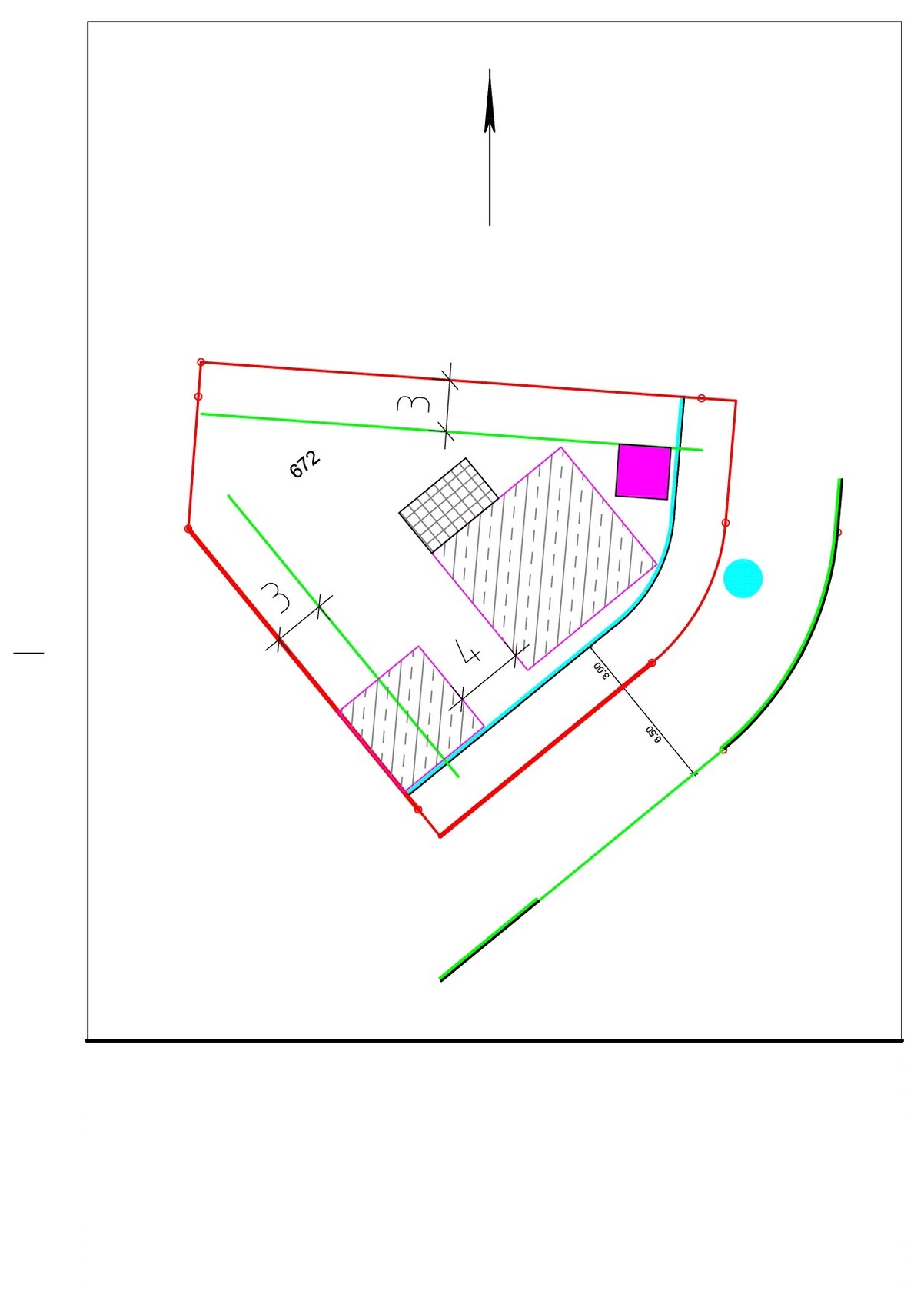

This is how we imagined it: the large rectangle represents the house with a terrace, the smaller one on the left is intended to be the carport, and the smaller one on the right will be a tool shed. After a lot of shifting back and forth, we found this positioning to be the most optimal, but maybe you have better suggestions. I’m still grateful for your ideas.
That works well. In the evening, there is still sunlight until about October and again from March, while in between, the sun sets further south. At midday, the area is still shaded, which can be important during midsummer. Overall, a good compromise for this piece of land. Karsten

the large rectangle is the house with the terrace, Is that now a different house (?)
bika5 schrieb:
the smaller one on the right is supposed to become a tool shed. ... which, in my opinion, should qualify for a boundary building exemption and therefore doesn’t need to be placed so close to the house.
I would probably position the house along the northern property boundary and place the carport adjacent to that boundary. The house would then be attached to the carport. I see the left side of the house as the living and kitchen area, with the other rooms, such as the utility room, on the right side, which faces east.
As the carport is currently planned, it would also allow for a nice garden, but here too, I see the house oriented toward the west. Additionally, during the months when the sun sets more in the southwest, that is in the winter months, the rooms will lack the comforting natural sunlight. The consequences (lack of daylight, reliance on artificial lighting) are not particularly beneficial for health.
I am critical of your approach – sunlight and warmth are important for well-being. If there is too much sun, then sun protection like roller shutters should be used. I consider a terrace located in the southwest area to be optimal.

Yes, seen from that perspective, the terrace might be better positioned between the house and the garage.
