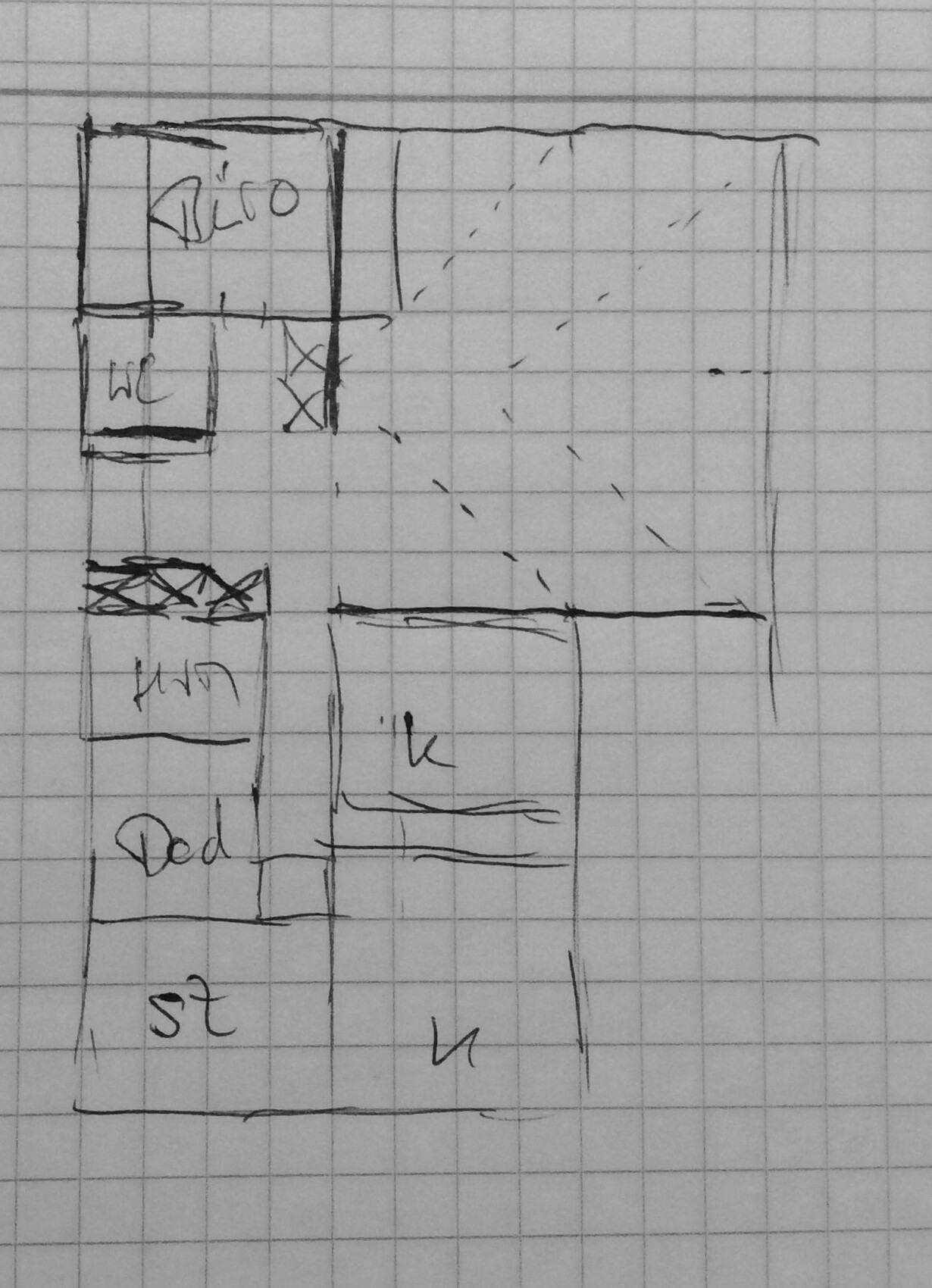

Maybe this is an approach?
Hand-drawn floor plan sketch of an apartment with WC, bathroom, kitchen, and sleeping/living room.
Chrisi1906
23 Jun 2019 09:52
When I say that the plot is not straightforward, I am understating it. Maybe this is an approach?
Thank you very much for the sketch. Which side faces the street? The one with the bedroom? What do the dashed dots represent? What kind of room is marked with a U? What is the room above the bathroom?
23 Jun 2019 11:06
Sorry, this is JUST A SKETCH... so nothing final, and it might be a bit distorted or exaggerated...
Bottom
Chrisi1906 schrieb:
What do the dashed dots mean?
The roof... while the ones on the right are not valid
Chrisi1906 schrieb:
What kind of room is this U?
I don’t see a U... oops:
The living room? No, of course the utility room... that’s still missing in your plan, isn’t it?!
Chrisi1906
23 Jun 2019 12:57
Sorry, it’s JUST A SKETCH... so nothing final, and it might be a bit skewed or exaggerated...
Below
Yes, the utility room was still missing. I meant the U at the bottom right in the room.

Niloa
23 Jun 2019 13:01
Chrisi1906 schrieb:
The U at the bottom right
I think that’s a K for kids’ room.
