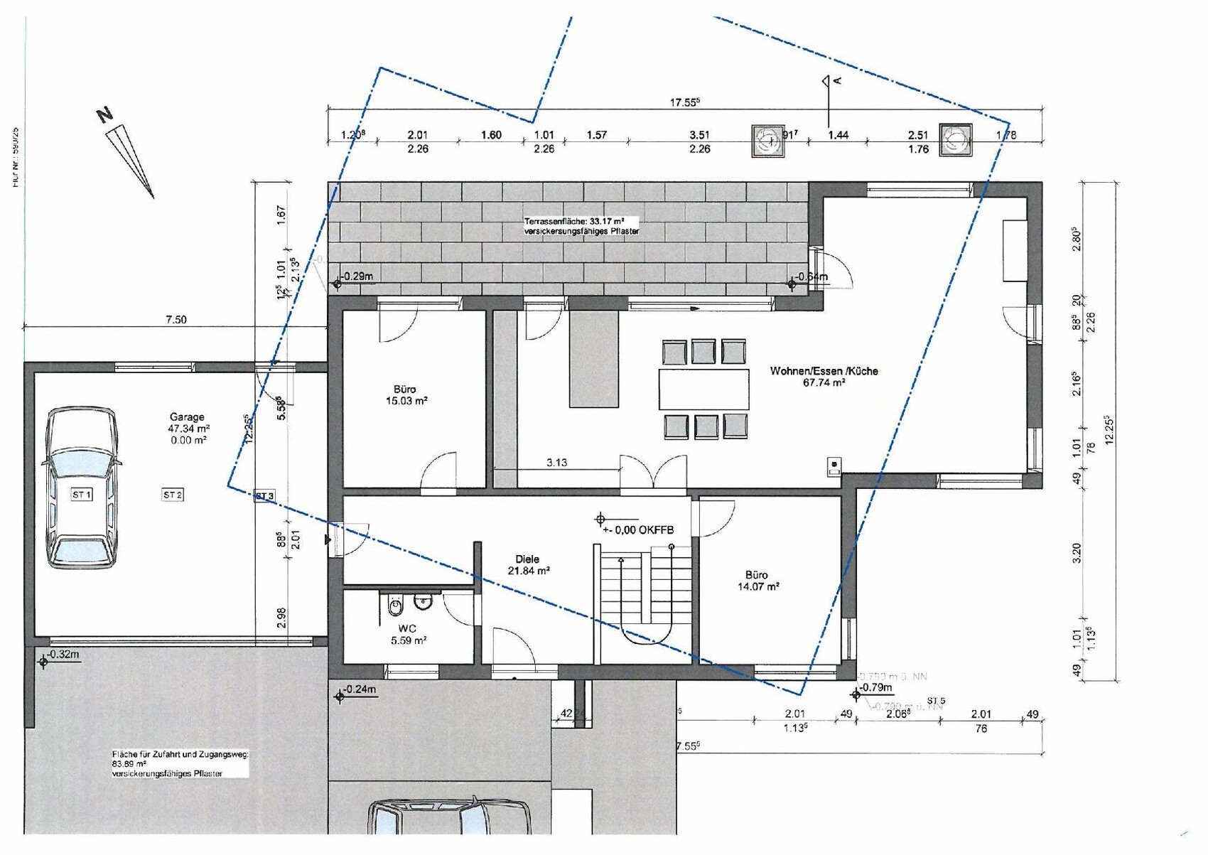

we would like to get feedback on our current planning for a single-family house. Here is the completed questionnaire.

- Is the floor plan good from your perspective, or have we overlooked something important?
Detailed questions about the floor plan:
- Does the entrance area seem too large?
- Do you have alternative ideas for designing the staircase better (we are currently considering either a U-shaped staircase with landing or an L-shaped staircase with landing)? We had a version drawn with an entrance bay so the staircase doesn't end right at the door. But that costs more and might make the entrance area too large?
- We are still considering reducing the number of windows in the living/dining/kitchen area. What do you think? We are afraid it might get too hot in summer because of the southern orientation (external blinds are planned).
- Another consideration is external roller shutters or blinds on the upper floor?
- Regarding the living room layout, we’re unsure. On one hand, we want two large floor-standing speakers optimally placed for a stereo triangle, on the other hand, we want to have a view of the garden from the sofa.
- About the windows on the upper floor, we're unsure: Does a floor-to-ceiling window make sense in the children’s rooms, or is it rather a safety risk? We have planned a window next to the bed (on the same wall as the head of the bed). I'm unsure if that might look strange in reality or if the bed should be placed on the opposite wall (but then the headboard would face the children’s room window).

- There is a busy street at the bottom side and a less busy street on the right side. Currently, the house is about 5m (16 ft) from the busy street and 8m (26 ft) from the right street. If we move the house further upwards, we would have more quiet from the street, but the garden would become smaller and the "wasted front garden area" would increase. What do you think?
- Do you have any creative ideas to shift or stretch the house further to the right? On the left side is a garage, which we would like to build directly onto.

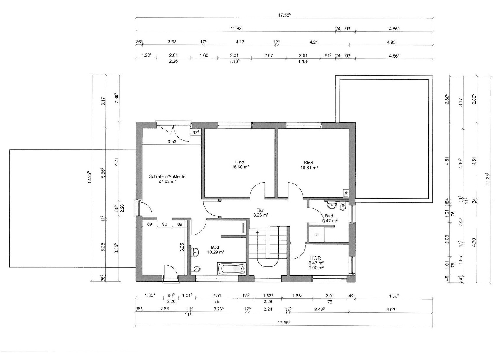

Toilet: According to the planner, this should not be a problem. The overlap in the drawing is likely just due to the software. In reality, the wall is supposed to run normally there. I think the question was more about where the toilet’s drainage should go. Below that is the large hallway and also the stairwell opening.
A small detail I noticed: your walk-in closet is 3.05 meters (10 feet) wide. That’s the raw structural dimension. Once you add plaster and finishes, you’ll lose some space. If you plan to install a standard 3-meter (10-foot) wardrobe there, it probably won’t fit.
I also have to say, I’m not really happy with the “parent’s wing” layout, though I can’t exactly say why.
Edit: Maybe swap the bathroom and walk-in closet, then adjust the walls a bit…

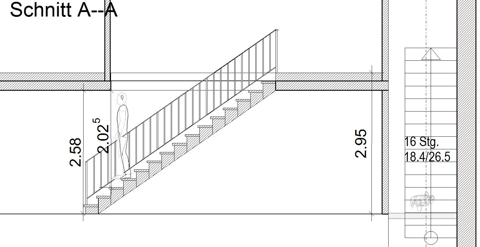

Wouldn't a half-turn quarter-landing staircase also work there? That way, the bottom step wouldn't be right next to the front door, and there would be enough space for the bathroom upstairs.
The shower in the children's bathroom can cause annoying noises in the adjacent children's bedroom. Please make sure to use very good sound insulation in this area.
Samantheus18 Jun 2021 14:31face26 schrieb:
I think the question was more about where the toilet waste should drain. Below that is the large hallway and also the stairwell opening.
A small detail I noticed: Your walk-in closet has a width of 3.05 meters (10 feet). That’s the raw construction measurement. Once you account for plastering and so on, you’ll lose some space. If you’re planning to fit a standard 3-meter (10-foot) closet there, it probably won’t quite fit.
I also have to say, I’m not completely sold on the “master suite” area. I can’t quite put my finger on why.
Edit: Maybe swap the bathroom and the walk-in closet, then adjust the walls a bit… Toilet: Ah, okay, I misunderstood that then. Good point. I will bring that up with the designer. I don’t have any input on that myself.
The walk-in closet is actually planned for a 3-meter (10-foot) closet. Previously, the length was 2.96 meters (9 feet 8 inches), and we have now extended it. According to the designer, about 1.5 cm (0.6 inches) per side will be lost, so the 3-meter (10-foot) closet should fit. Do you think more space will be lost?
Hmm, we do like the master suite area… what is your idea behind swapping those spaces?

Wouldn’t a half-turn stair with a landing work there? That way, the stair start wouldn’t be right next to the front door, and there would be enough space for the bathroom upstairs.
The shower in the children’s bathroom could cause annoying noise in the adjacent children’s bedroom. Make sure to include really good sound insulation there. We also considered a U-shaped stair, but felt an L-shaped stair on the ground floor creates a more open feeling. We never had a strong preference for either option.
Thanks for the noise tip; we hadn’t thought of that. Do you think a standard partition wall with perforated bricks would be enough, or would you recommend something more robust?
kbt09 schrieb:
It’s clear there’s a wall there, but the floor from above covers the two first steps on the ground floor, and that could cause a head clearance issue, especially when going downstairs. How tall are you?
And of course, the toilet drainage problem 😉 About 1.85 meters (6 feet 1 inch). I thought those two steps wouldn’t cause any trouble. Would you recommend placing the entire stair within the open stairwell space?
Well, here is my picture again 😉
When going down, a person who is 180 cm (71 inches) tall... it’s easy to bump your head on the ceiling, and you can see that 185 cm (73 inches) is already critical. This is with a finished height of 258 cm (102 inches)... every centimeter less makes it more critical.
Samantheus18 Jun 2021 14:43Ok, convinced already, I will also discuss this again with the designer. Then we probably have to either use the U-shape or reduce the size of either the bathroom or the walk-in closet.
