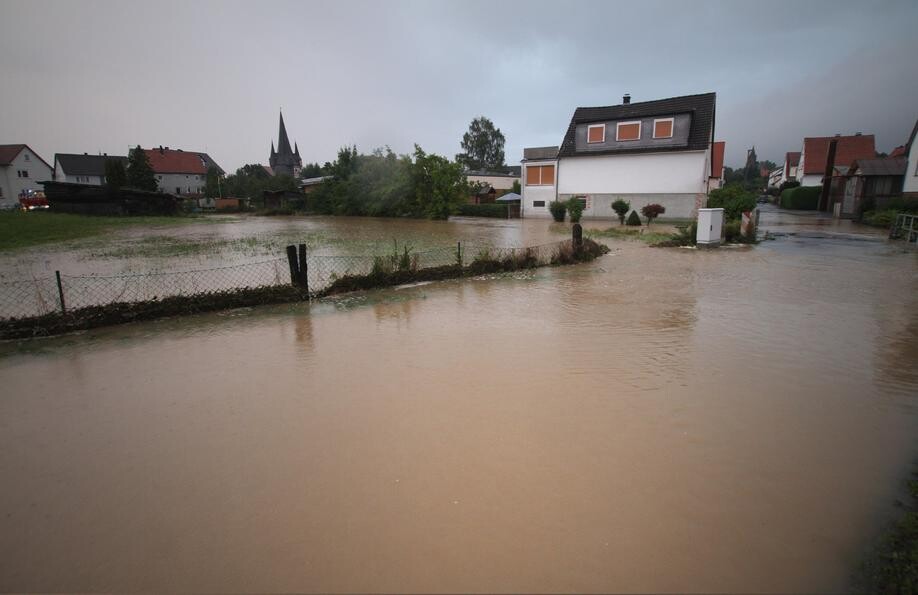

Could it possibly be very simple reasons why land developers are not lining up here?Try searching “Nellenburgstr Otterbach” on Google, then you will understand why no one wants this plot, even though it is being heavily promoted like hotcakes.
I have looked at the photos and am very familiar with the severe weather and flooding events in Neustadt, as I have been deployed there several times (power supplier). Since this storm, the Otterbach stream has been partially deepened toward the city center, and some culverts have been renewed and enlarged. The photo shows the property. The house is planned to be built at least 10cm (4 inches) above the street level of Nellenburgstraße. In the photo, you are looking from Neuen Gartenstraße toward the property; this street is a few centimeters below Nellenburgstraße. Therefore, it should be outside the 100-year flood zone.
