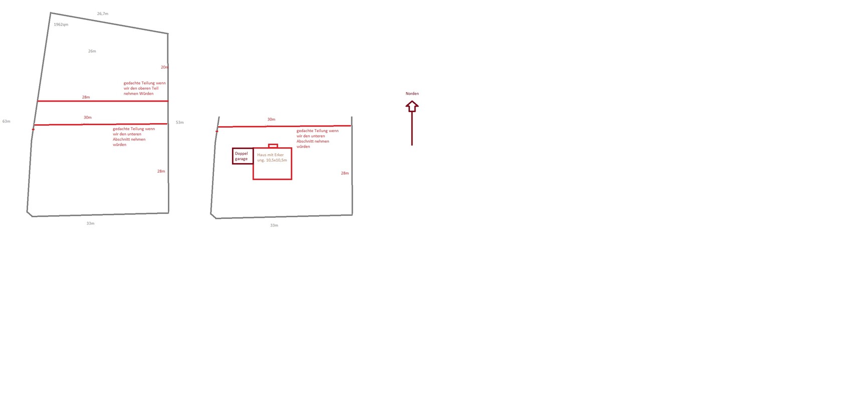

I plan to build a city villa with two residential units with Dennert.
The location is Neustadt, Marburg-Biedenkopf district, parcel 20, plot 16/2.
You can view it in the Hessen geodata system. The property would be split almost equally in half. It is not yet decided which half we will use ourselves; the younger sister will take the other half.
I’m unsure how to position the house so that, for example, a balcony above the garage could be used, possibly facing south-southwest.
Could you possibly help me with this?
The property is listed on Immobilienscout24 with Scout-ID: 70642775 (just enter the Scout ID on Google).
I know that without a building permit/planning permission it may not help much, but the property has not been purchased yet. See my related question in Land for Building, Contracts, Building Law Tips.
The neighboring development is set back 3 meters (10 feet) from the property, but there is an old house directly on the property boundary. Therefore, I would suggest planning the building plot at least 3 meters (10 feet) away from the property line.

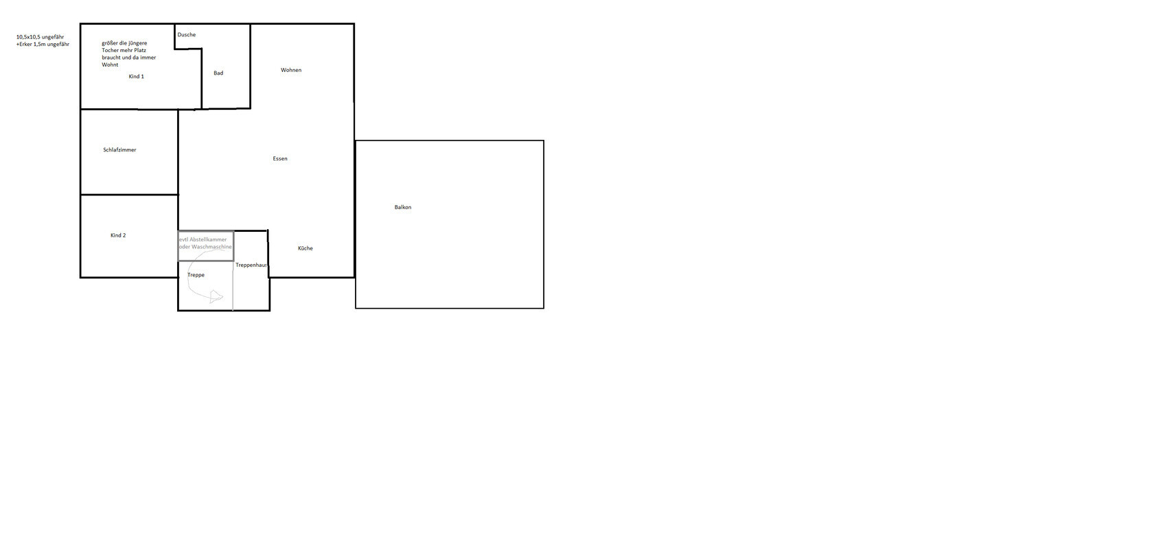

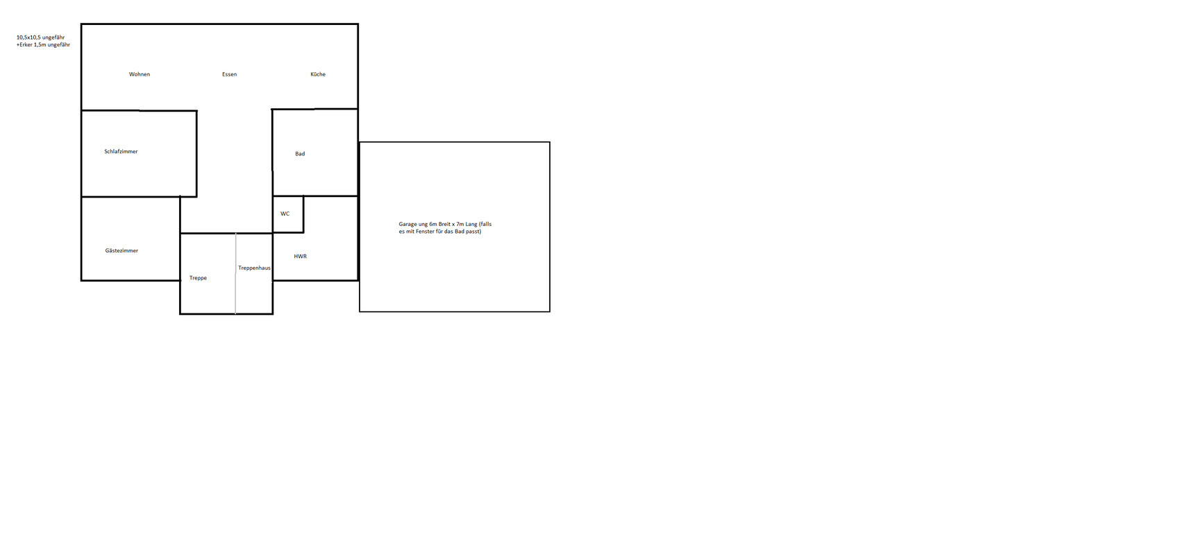

Parents, 60 and 63 years old, on the ground floor; sister, 37, with child 7 and second child 17 (who does not live there regularly) on the upper floor
Approximately 90 square meters (970 square feet) per residential unit
Ground floor definitely with a guest room
Very open architecture
Modern construction
Open kitchen, kitchen island: both yes
Number of dining seats: 8 on ground floor, 6 on upper floor
Balcony, roof terrace: possibly a balcony above the double garage
Garage, carport: double garage with door to the utility room

The proposed layout of the plot doesn’t really make sense to me; I can’t tell where the neighbors or the street are located. If a neighboring house is built right on the property line, I would expect there to be a setback agreement, meaning the previous owner probably registered an obligation in the land registry to maintain a 6m (20 feet) distance between the two houses on their side alone. I wouldn’t commit to any specific building material at this stage. I don’t quite understand the project: you show a two-family house that’s the size of a single-family villa, and you mention one sister living there and another sister on the other half of the property. Where do you fit into this arrangement yourself?

Ah, okay, there is a street under the property (more like a lane) and a street to the left. I thought I was not allowed to post links, so this is the explanation. There is no neighboring house in close proximity to the property.
I am planning for my parents and the older sister. The younger sister will get the other half of the plot. There is nothing for me. I already built a house 8 years ago.

I thought I was not allowed to post links, so here is the explanation. That is correct – we only provide free advice here, and there isn’t time to go look for plots ourselves. Screenshots of cadastral maps or aerial images would be more helpful.

There is nothing for me there. I already built 8 years ago. Um, I didn’t really get any planning experience from the floor plans :-(
8asti86 schrieb:
Ah ok, there is a street below the property (more like an alley) and a street on the left side.A drawing with measurements corresponding to the text would be helpful. I only see rectangles… and yes, those are supposed to be rooms. But honestly, I can’t make much sense of it. 8asti86 schrieb:
Whether this is feasible and if the location on the lot is acceptable.Try marking the existing trees with a green colored pencil, the street in gray, and draw some lines with measurements for the property boundaries. And don’t forget to indicate north.Similar topics
