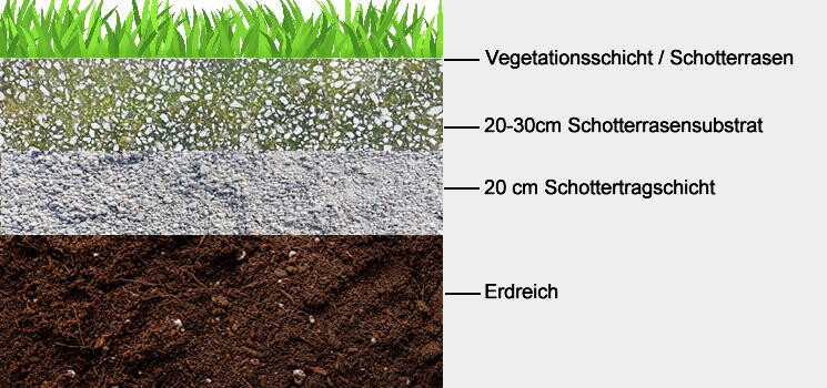

My Beautiful Garden Gravel Lawn
or simply
Creating a Gravel Lawn OK, thanks. I was confused because it gave me the same result as grass pavers.
haydee schrieb:
We are considering installing a gravel lawn on part of our driveway. Not the main driveway to the garage, just the 1.5 m (5 feet) on the left and right sides, where a car occasionally parks.Aaa, thanks, I understand now 🙂
BauFamily30 Jul 2021 16:13haydee schrieb:
We are considering creating part of our driveway as a gravel lawn. Not the driveway leading to the garage, just the 1.5 m (5 feet) on the left and right sides, where a car occasionally parks. Quick question: Does the gravel lawn count towards the floor area ratio (FAR) / site coverage ratio?
