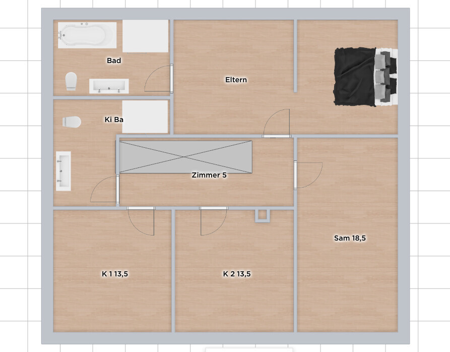

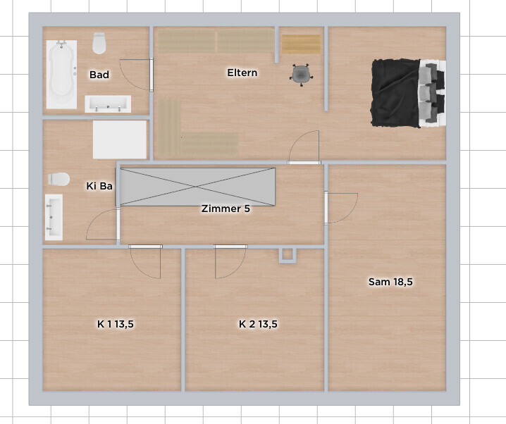

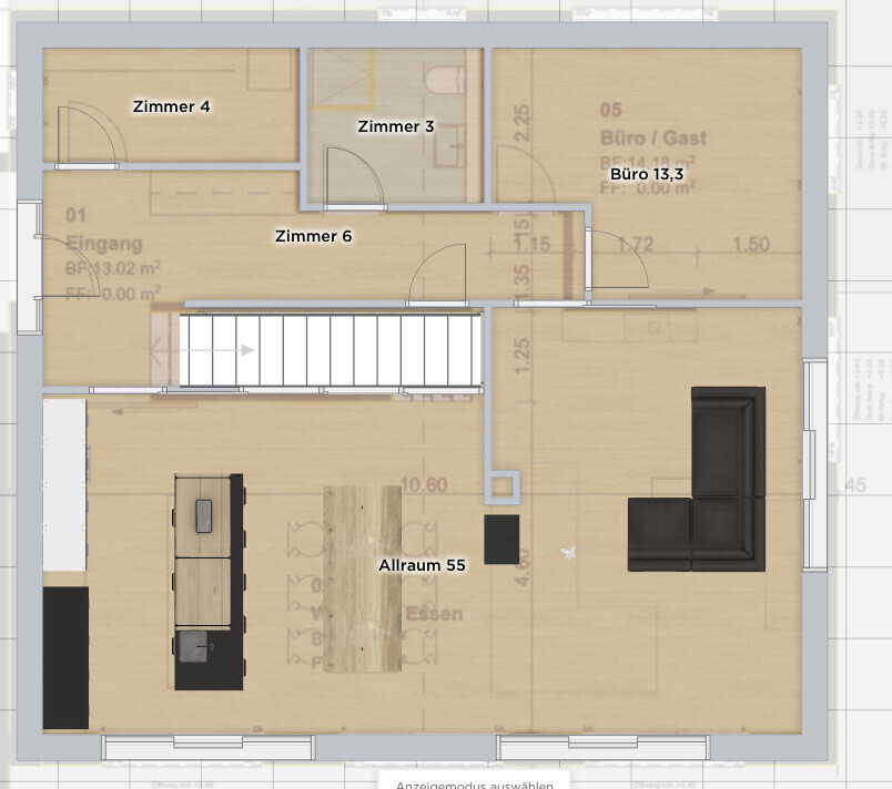

DasWirdNix30 Oct 2020 15:53pagoni2020 schrieb:
....not yet......but it’s also not as comfortable as in the rest of the house. There HAS to be a shower for Dad!!! And it has to be a proper one.Thank you, thank you, thank you!But unfortunately, I don’t see the point (for us) of having an additional shower. We have a shower on the ground floor that I can use if I can no longer get over the bathtub edge. If necessary, there is also a shower in the nearby bathroom.
Currently, our schedules and shower times are very different, so that works well for us. I don’t shower for 15 minutes, so mathematically all five of us can fit in one shower within about 1.5 hours.
So, thanks for the suggestion, but for me it’s an unnecessary use of space and money based on today’s circumstances (and only suitable for us, of course).
By the way, the same goes for the wardrobe. We could still put a sideboard under a window, but in the last 15 years we haven’t needed more closet space, so we won’t need more in the next 15. Otherwise, we use one of the children’s rooms or rotate with the basement. Or it ends up in the attic above our bathroom.
Regarding the sudden stop (full stop) issue: We will probably actually plan a bend in the children’s bathroom so the clearance is a bit larger. Currently, there is about 1 meter (3.3 feet) between the stair exit and the wall. That’s too little. I assumed 1.1 meters (3.6 feet). If necessary, we will move the stairs a bit toward the children’s room, although that would be unfortunate.
Interior dimensions are 10.6 x 9.6 meters (34.8 x 31.5 feet)... I hope I didn’t miscalculate.
I think everything is self-explanatory. However, the interior walls are only 10 cm (4 inches) thick—I’m not motivated to change that now.

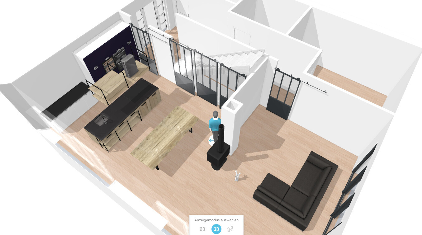

For reference: the dining table is 220 x 110 cm (87 x 43 inches), the island is 2.40 meters (7.9 feet), as are the tall cabinets. The bed is 185 cm (73 inches) wide, and the showers are about one meter (3.3 feet) wide. I’m not sure about the sofa...
DasWirdNix30 Oct 2020 18:24Wow, thank you! Even though I am very afraid to change something fundamental and start from scratch, I will take a close look at your design! Thank you!
