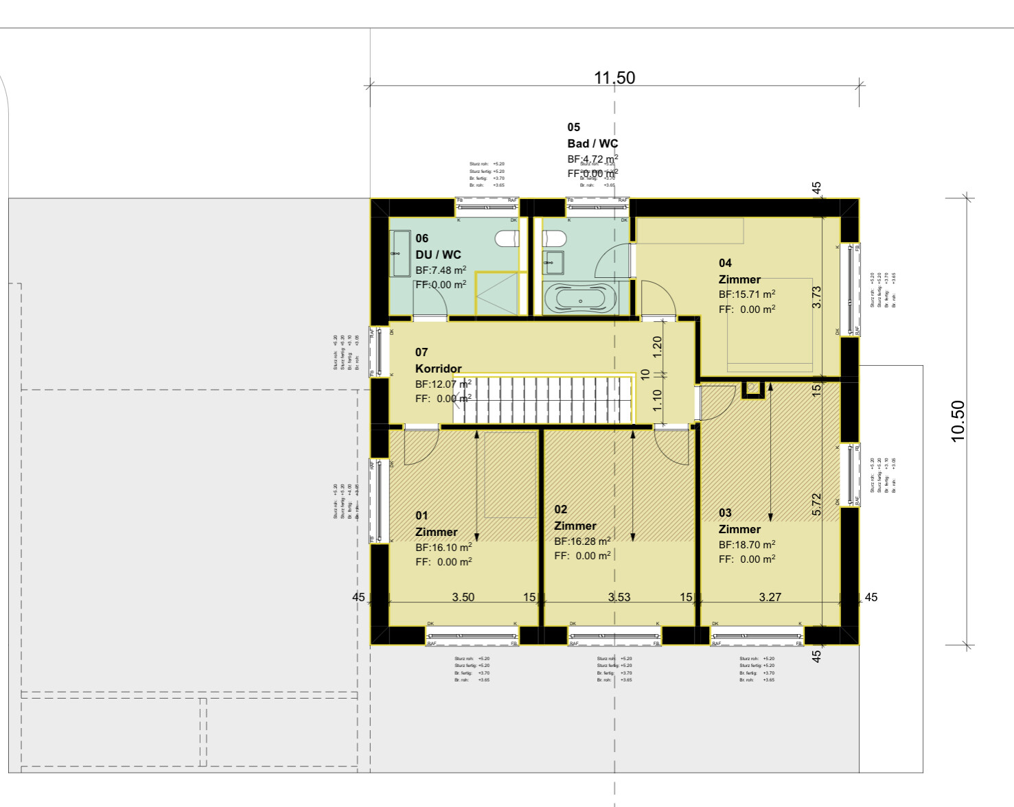

DasWirdNix29 Oct 2020 09:55D
DasWirdNix29 Oct 2020 09:58Nice-Nofret schrieb:
... 'it’s actually enough' means in plain language: You think it’s enough for your wife, but she is not happy with it Yes. No. I mean, it’s enough for our cooking habits. There is space for pizza dough, our appliances can be accommodated, and we don’t get in each other’s way. We don’t do that “Instagram cooking with friends” thing. When friends come over, we cook. In my opinion, we already have too much stuff in the kitchen today...
I would place the kitchen on the left side of the plan with a freestanding island in front; then the dining table in the center of the room. You can keep the fireplace where it is — OR you could move it, for example, to the bottom-right corner of the plan with an outdoor chimney. You could also locate it somewhere on the right wall — either with an outdoor chimney or an indoor fireplace. I don’t think an outdoor fireplace on the terrace is ideal. It would have to be placed sideways. Then we have the problem that the roof ridge runs from north to south, and the chimney must extend 1 meter (3 feet) above the highest point. So we would have a very tall chimney on the house side. That doesn’t look very good.
Nice-Nofret29 Oct 2020 10:01Your alternative floor plan would be exactly my style, but it has to work for you. I also like the short distance between the kitchen, basement, entrance, and pantry.
I’m not a fan of having the kitchen in the stairwell area because of the cooking smells; the food aroma tends to rise and linger in the hallway. The stairwell naturally creates a crossflow or chimney effect, drawing air upward.
DasWirdNix29 Oct 2020 10:04Nice-Nofret schrieb:
Your alternative floor plan is exactly my style, but it has to work for you.
I don’t like having the kitchen in the stairwell area because of cooking smells; the food odors rise and then linger in the hallway. The stairwell inevitably causes some cross-ventilation or chimney effect upward. Understood. I’ll attach the floor plan from above in a moment. For the cooking smells, I’m planning a POWERFUL exhaust hood.
Nice-Nofret29 Oct 2020 10:06Which range hood are you considering? There are really great models available now, but they still don’t capture 100% of all odors; for example, there’s usually still some smell coming from the oven.
