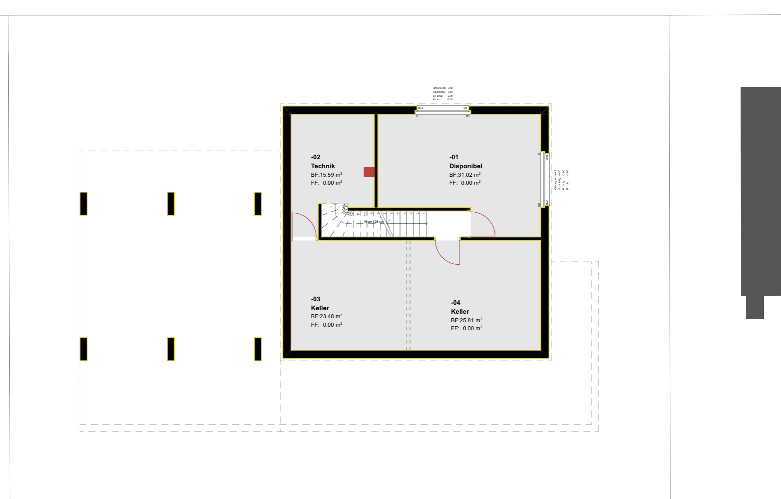

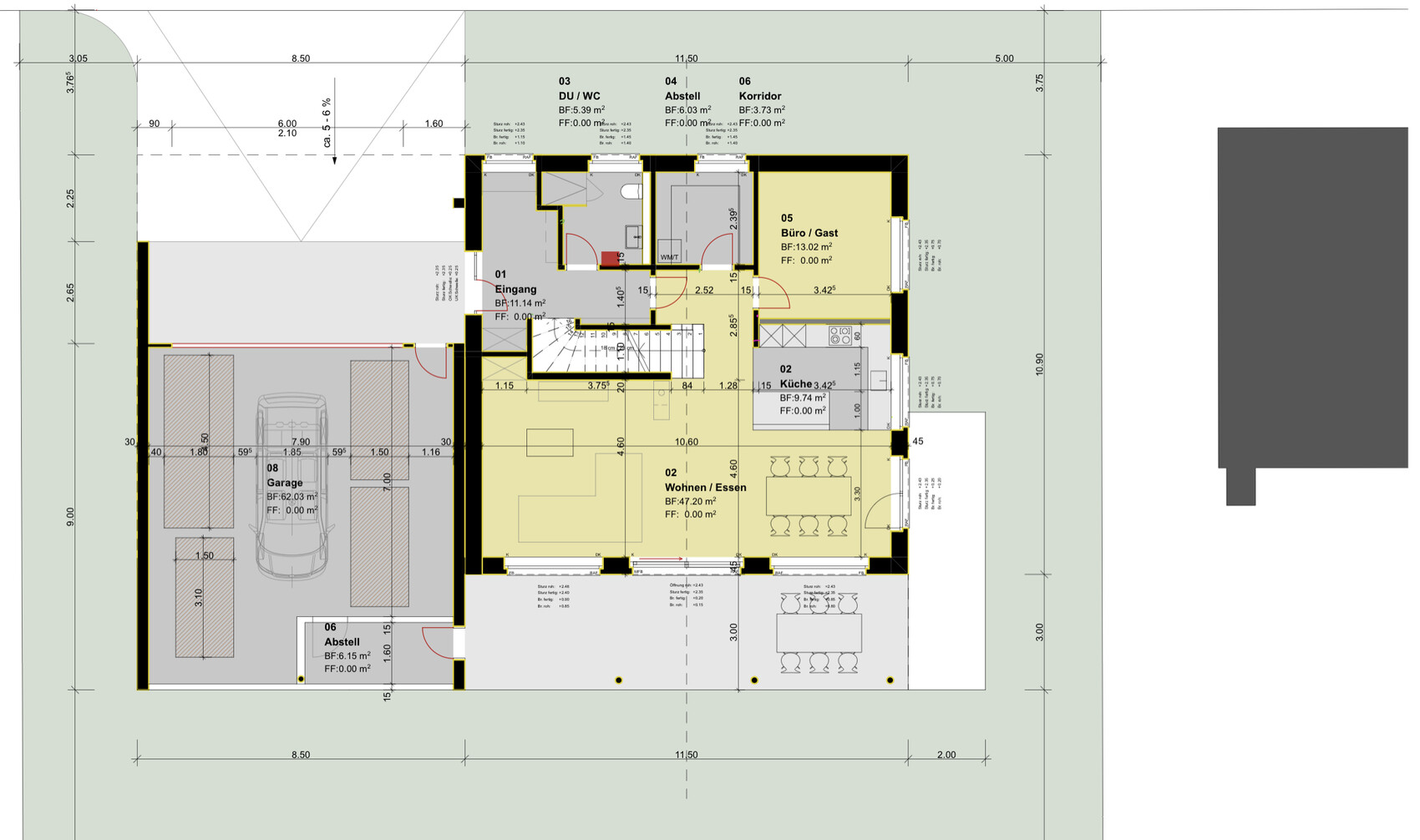

Osnabruecker29 Oct 2020 09:18I find the size a bit lacking in terms of space for technical equipment and storage.
The washer and dryer are shown in a designated area, but for a new build, I would allow for more space there. You really can’t turn around with a laundry basket if all the meters, vacuum cleaner, and so on are stored in that room.
Since there are already five of you, I would suggest furnishing the dining area to scale with furniture to see if the space is sufficient. Maybe consider planning with a larger table?

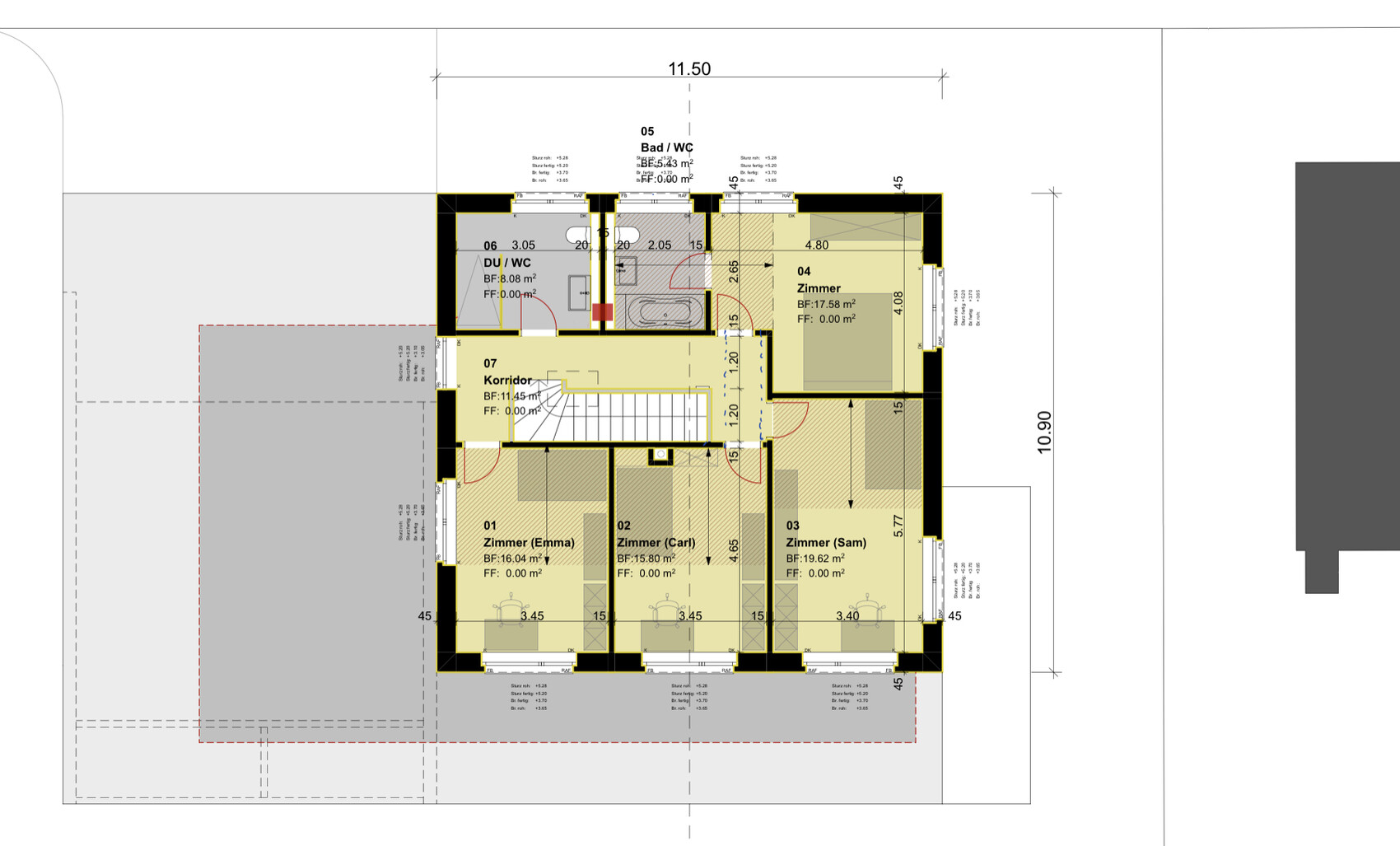

How long is your current wardrobe? The planned wall isn’t very wide.
Poor kid, having to tidy up 20 m2 (215 sq ft).

DasWirdNix29 Oct 2020 09:25Osnabruecker schrieb:
I feel like there could be a bit more space allocated for building services and storage. We still have a basement for building services and storage space. I’ll attach the floor plan later, but it’s nothing special.
The washer and dryer are shown in a single space; for a new build, I would allow more room there. You can’t really turn around with a laundry basket if all the meters, vacuum cleaners, etc. are stored in that room. The room will contain shelves, cordless vacuum cleaners, a freezer, and a washer/dryer stack. Do you think it’s too small to turn around with a laundry basket? Hmm, I’m not sure where else I could find the space. Otherwise, the office would be too small.
Since there are already five of you, I’d recommend placing furniture to scale in the dining area to see if the space is sufficient. Maybe plan for a larger table? We currently have the same size and layout in our apartment. It’s not very spacious but just about works. It couldn’t be any narrower.

How long is your current wardrobe? The planned wall isn’t very wide. It’s currently 2.5m (8 feet) long — 2 sections of 1m (3 feet) plus 1 section of 0.5m (1.5 feet).
Poor kid, having to tidy a 20 m² (215 sq ft) room Our oldest gets that room, and he is very tidy and organized. I’m more concerned about my daughter’s room on the west side.

Nice-Nofret29 Oct 2020 09:38I like the floor plan overall, although the kitchen seems a bit small to me; a lot of kitchen stuff will probably end up in the basement. Also, one might consider combining the office and guest room into the flexible space.
If it were my house, I would swap the kitchen with the living area to gain more storage and workspace in the kitchen.
DasWirdNix29 Oct 2020 09:43Nice-Nofret schrieb:
I like the layout overall, although the kitchen seems a bit small; I guess a lot of kitchen stuff will end up in the basement. Also, I wonder if it wouldn’t make sense to combine the office and guest room into the extra space. What do you mean? One large room for everything?
If it were my house, I would swap the kitchen and living area to get more storage and workspace in the kitchen. That’s also my wife’s preference, but I see a problem with the current stair layout. The living room wall would become quite short and narrow, which wouldn’t work well with the fireplace. If we moved the kitchen back, we’d have to rearrange and change a lot upstairs as well.
Our kitchen today is roughly the same size as on this plan. That’s usually enough. Large items like a fondue set, raclette grill, or rarely used appliances we would store in the extra room. It’s not far away anyway.
My thought was: in the living room, you either have reading light in the evening or the TV is on. So it’s either bright or you have mood lighting. At home, it’s the opposite: my wife almost always has the light on above the dining table because it’s too dark for working otherwise. So during the day and morning, I prefer a bright dining area and a “darker” living room.
I would like to reverse it as well (water connections closer to the heating system in the basement, shorter routes from the entrance/car to the kitchen). But I haven’t been able to arrange it so that everything really fits well.
