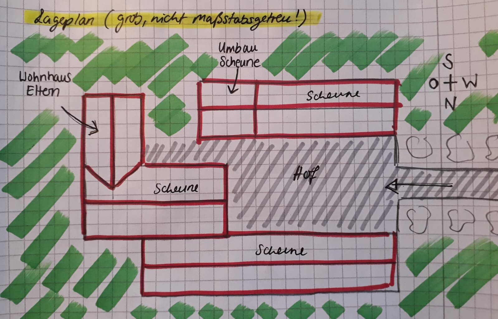

Now I’d like to give it a try as well. Just a brief introduction: My partner and I would like to convert part of the barn on his parents’ farm into a residential home. This means we are not as free in terms of dimensions, style, design, etc. as with a new build and have to work with the existing conditions. The goal is to convert the barn section into a single-family house for a family with presumably three children. However, the house should later, if needed, also be rentable as two separate apartments. The reason is that the existing farmhouse, where my partner’s parents currently live, is not very suitable for rental, so a move there in the future is not excluded. The potential for later rental, along with the constraints of the existing building, imposes further limitations.

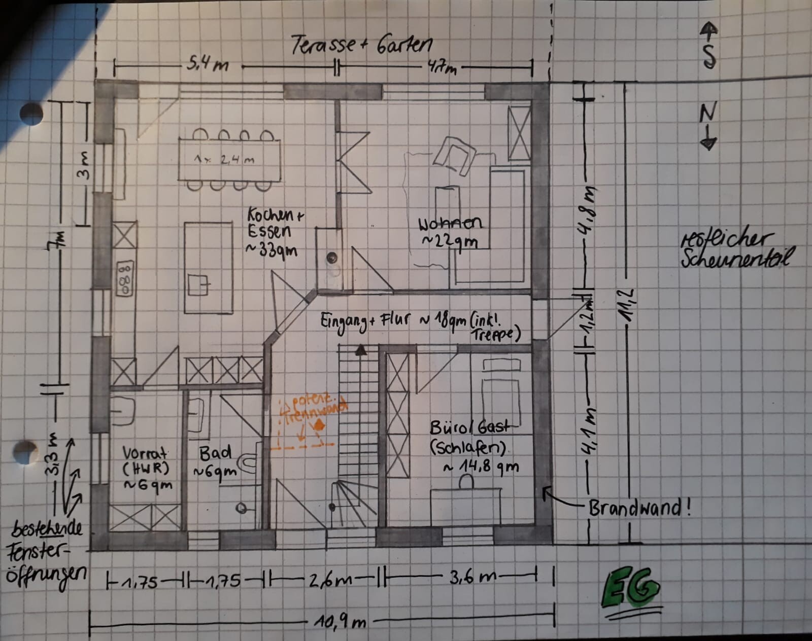

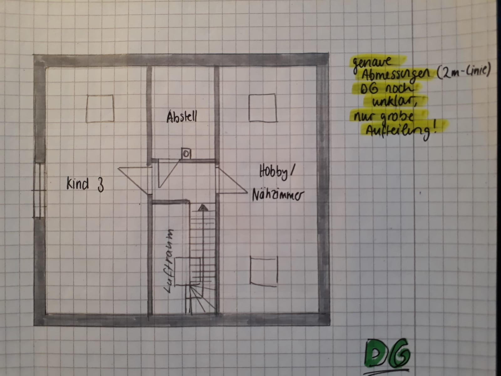

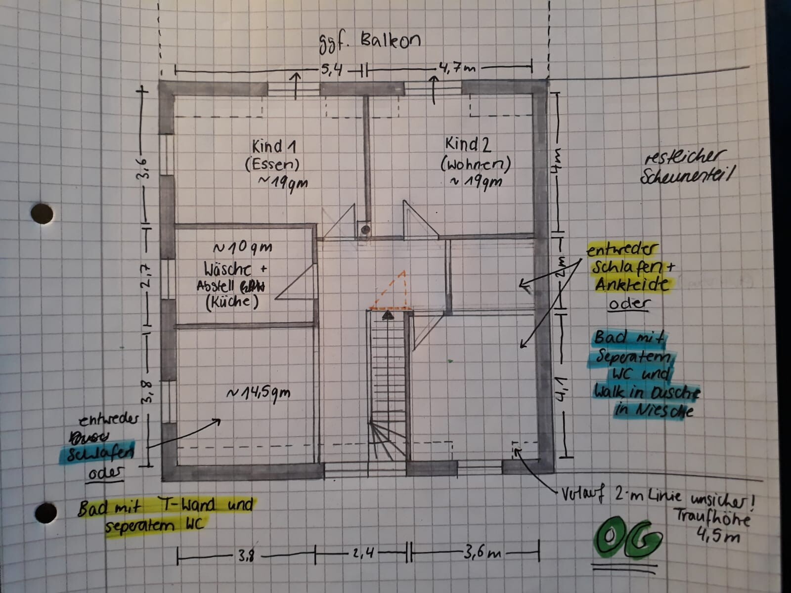

We are therefore looking for the best and most practical compromise. Our first ideas are shown in the attached floor plans. Please excuse the hand-drawn nature and the partly missing dimensions, etc. Our main focus is on the general layout of the rooms! We welcome criticism and suggestions that maybe we haven’t thought of yet. Thank you very much!

GF: Living room, kitchen + dining, pantry (utility room if rented), office / guest room (bedroom if rented), bathroom
FF: Bedroom (dressing room if possible), family bathroom with separate toilet, 2 children’s rooms (dining and living if rented), laundry room (kitchen if rented)
Attic: small storage room, children’s room, hobby room

What do you like most? Why?
- All elements included, large kitchen/dining/living area
- Tunnel fireplace
- Large children’s rooms
- All rooms with windows (challenge due to fire wall)
What do you dislike? Why?
- Narrow entrance?
- Wardrobe only possible under the stairs
- Staircase start unfortunately right at the entrance due to future rental considerations
- Slanted wall as kitchen entrance may not be very contemporary?
- Bathroom and guest room (later bedroom) on the ground floor not next to each other
- Dressing room not always available (two variants on FF)
