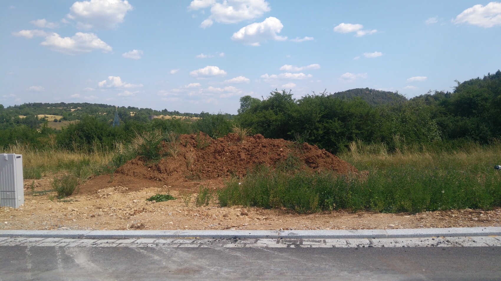

Robert Bau20249 Jul 2023 14:54Here is another photo taken from the road (doesn’t look quite as dramatic).
There isn’t much topsoil available. Below that is the bedrock slab. Is that good or bad for a bungalow on a slight slope?
A few centimeters (cm) of soil will be pushed aside, then a capillary-breaking gravel layer (about 60cm (24 inches)?) will be installed. After that, I plan to bring in soil to fill up the garden area.
