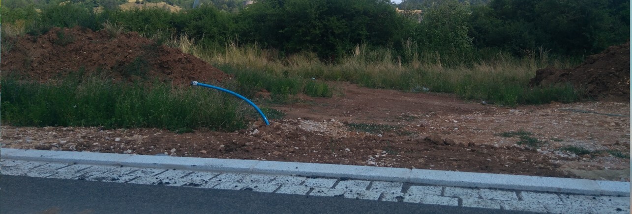

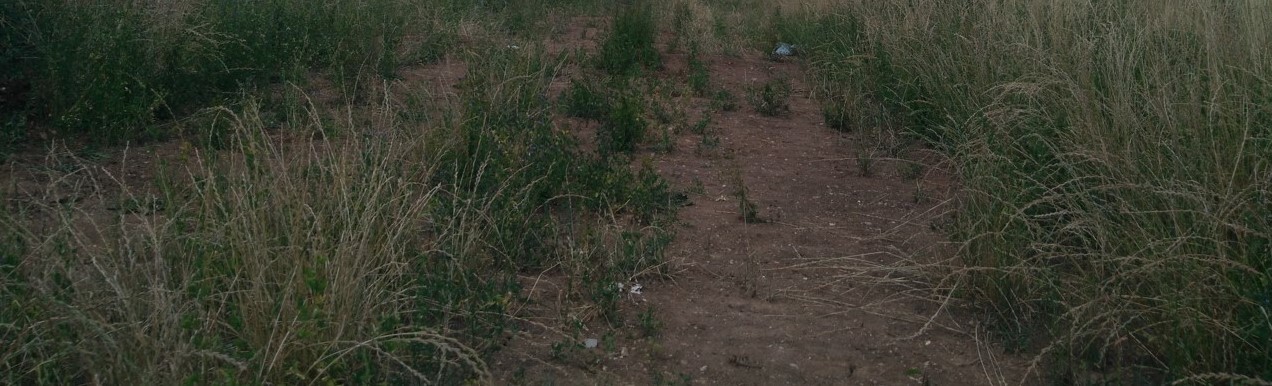

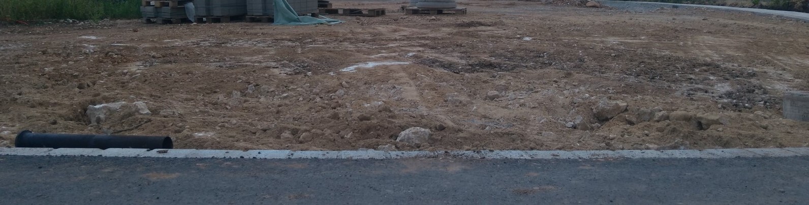

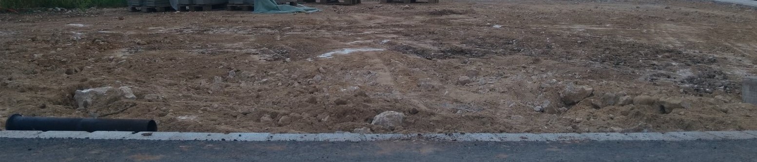

The contour lines don’t lie. Within the building area, it’s 1 meter (3.3 feet). On plot #3, it’s nearly 2 meters (6.6 feet).

The contour lines don’t lie. In the building area, it’s 1 meter (3 feet 3 inches). On plot #3, almost 2 meters (6 feet 6 inches).I feel like I’ve reviewed around 1000 floor plans already (which is why I’m also good at creating my own 😉
The photo from the street looks pretty wild... I took another one that I’ll upload as well.
