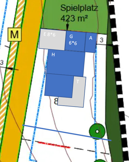

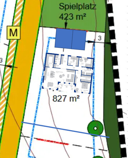

Robert Bau20249 Jul 2023 11:05Hello Hanghaus,
Yes, it should look like in your PNG image. The 827 m² (8,900 sq ft) will actually be smaller – everything is still being measured and not finished yet. According to the local authority, it will be around 700 m² (7,535 sq ft) because the plan is still changing a bit.
The garage can be built on the boundary. I’m not sure when a slope is officially considered a hillside, but the plot does have a slight incline. I would say from the street (highest point) down to the hedge (lowest point) the drop is maybe 1 m (3 ft), max 1.5 m (5 ft) over the entire length.

Robert Bau20249 Jul 2023 11:55Yes, the contour lines are always 1 meter (3 feet) apart. On the east side, there is a 3-meter (10-foot) thick hedge. Beyond the hedge, there is a 20-meter (65-foot) rock slab, and then the terrain drops off steeply about 20 meters (65 feet). Below is the old village center with the church, village square, and so on.
I live just a stone’s throw away from the construction area and want to build cost-effectively. However, I am not sure if a house made of brick, beams, and, for example, thick sandwich panels on top can meet the KfW 55 standard. I want to keep the technology simple and affordable — air-to-air heat pumps and tankless water heaters — no smart home stuff, I don’t need any of that. I don’t mind working a few hours after work or on Saturdays. I have always been a village person, and that’s just part of it.

Robert Bau20249 Jul 2023 12:41Where in Bavaria is that?
I'll send it to you via private message, I don't want to share too much information in the forum.
Yes, I can easily imagine it the way you’ve planned. The plot definitely loses a few meters along the long side. But everything still needs to be surveyed and divided.
