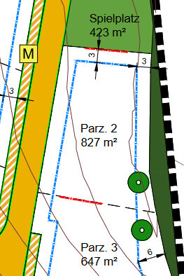

hanghaus20238 Jul 2023 18:05Is there a site plan of the property showing the north arrow and dimensions? Ideally, it should include neighboring buildings and the street.
R
Robert Bau20248 Jul 2023 18:16The road in the building area was just paved last week, and the size specifications of the plots are no longer accurate (they are becoming smaller). North is currently pointing straight up. Plot 2 would be the preferred choice. The plots still need to be precisely surveyed. Therefore, there are no neighbors yet.

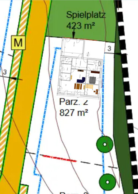

hanghaus20239 Jul 2023 10:32Let's assume you have plot #2 with your floor plan like this?
Is the garage allowed on the boundary? Then definitely place the windows facing east. Even better, add a door.
Your statement that there is no slope is probably a bit optimistic. I see contour lines, but unfortunately, no numbers are shown. Is there a larger section of the zoning plan available?
827 m² (8900 sq ft) is more than 700 m² (7500 sq ft)
