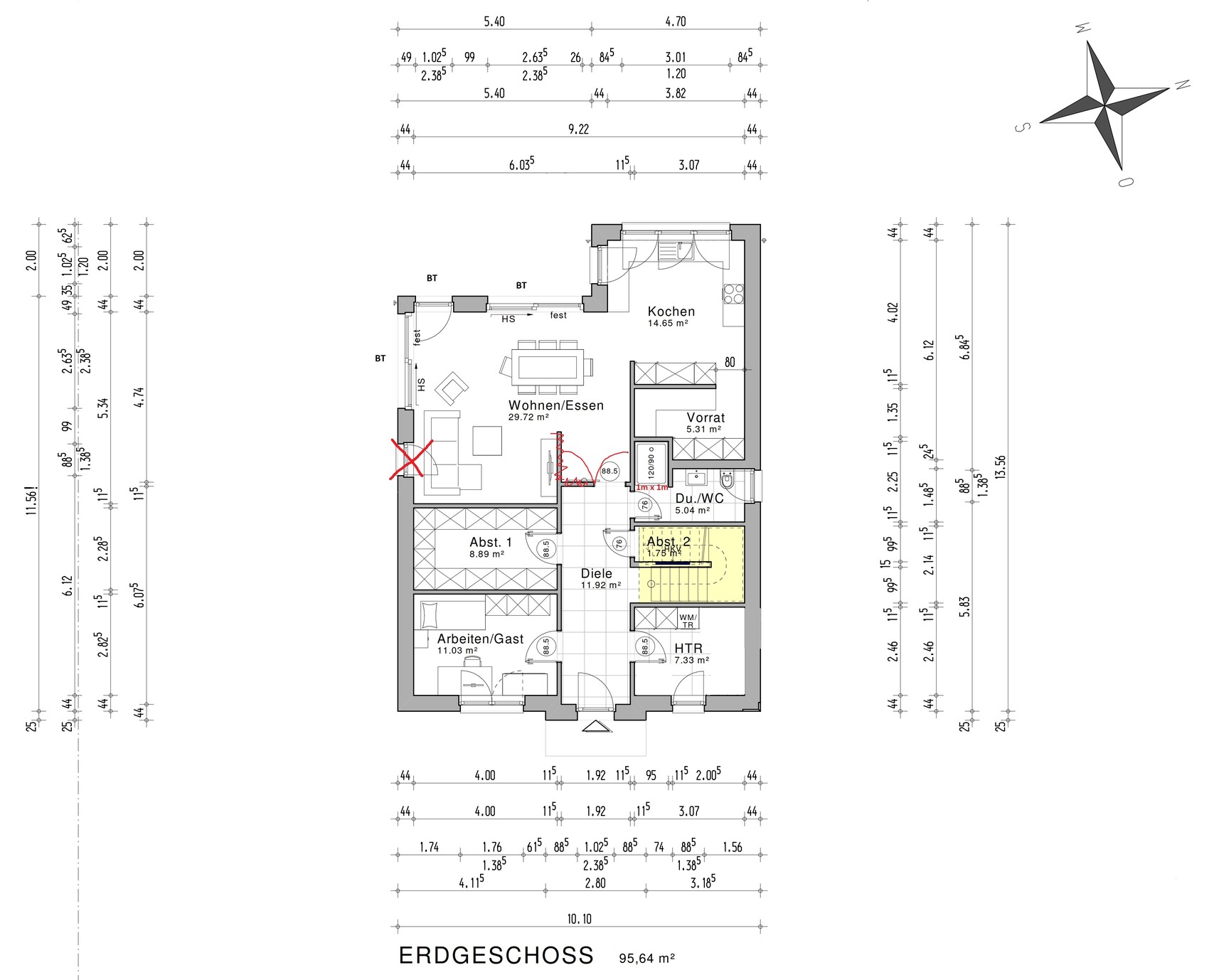

Space requirements for ground floor and upper floor:
Ground floor: should include the "public area" with living room, kitchen, but also a utility/technical room, guest room, and a full guest bathroom with shower;

Open kitchen, kitchen island: open kitchen, no kitchen island. The bay window should allow more light into the kitchen and provide workspace
Number of dining seats: 4, extendable to 6

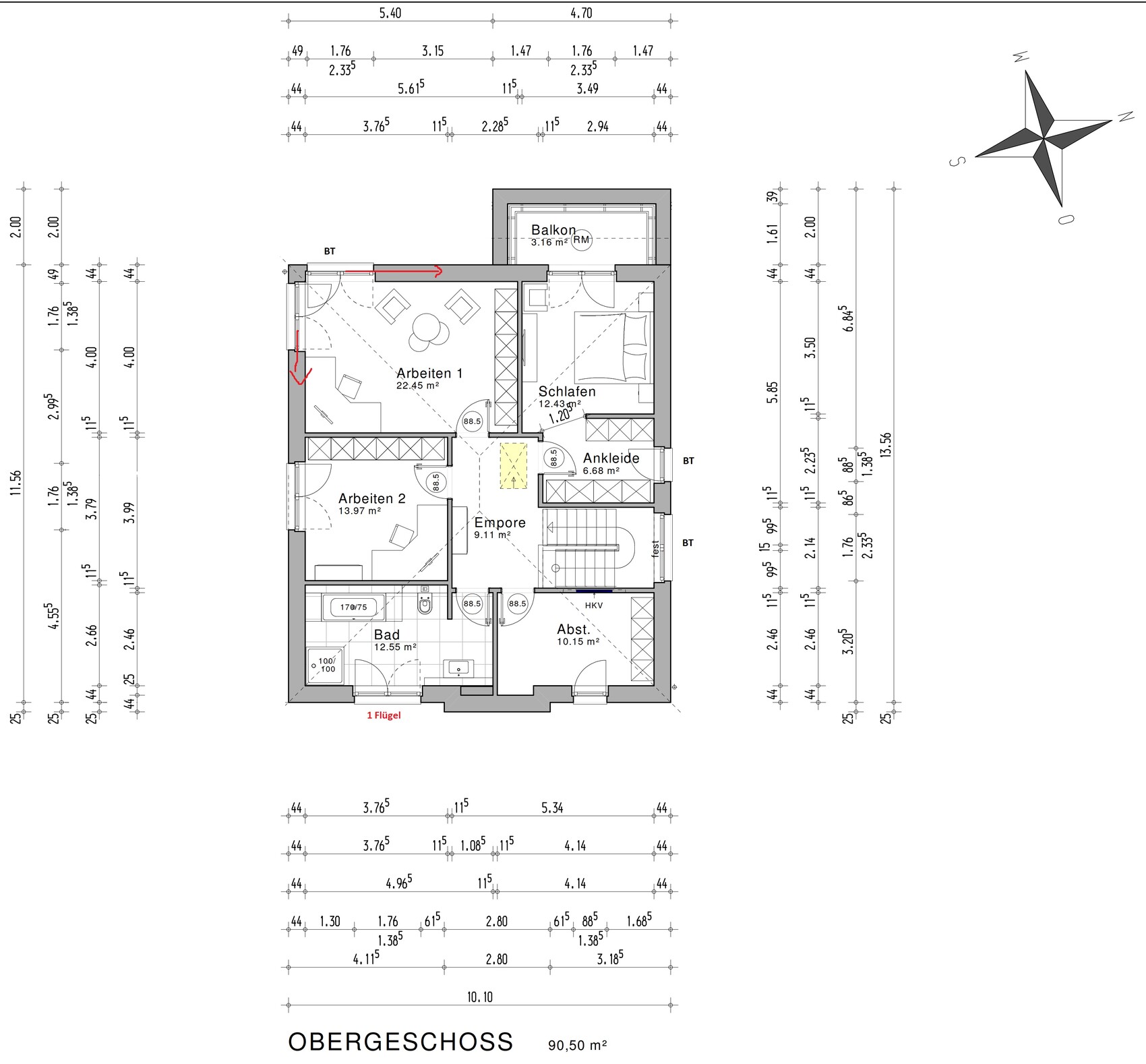

What do you particularly like? Why? We like the upper floor, the large office, and the bedroom. Additionally, we find the living room, kitchen, and pantry area logically and sensibly laid out. The kitchen has sufficient counter space as well as room for tall cabinets.
What do you dislike? Why? The window arrangement on the upper floor (especially in the large office) is still chaotic; we still need to work on that ourselves. We want bright rooms with many windows, but this compromises symmetry. Also, we do not like the window situation by the stairs. We want an open staircase without storage underneath; a small bench for putting on shoes would fit there.
We also want to avoid entering a dark hallway upon entering the house, so the double doors to the living room on the ground floor should have glass elements. Additionally, we are considering smart ways (also for ease of cleaning) to bring glass or light into the stairwell. Do you have any ideas? The currently planned fixed glass panel is not to our liking.

What comes to your mind spontaneously about this that we may not have considered yet or any deal-breakers in the design? We would appreciate discussing this.
Do you have ideas for how the window arrangement on the upper floor facing southwest could look and how to bring light from the staircase into the hallway on both floors?

Hausbewohner20 Jul 2020 18:14Thank you all for your responses.

I am allowed to place a wooden garden shed on the boundary, nothing more.
@Würfel*
We also have neighbors to the north. Four meters (13 feet) definitely isn’t enough, and there won’t be a full double garage. As described above, by extending the plot to the rear, you might get about 4.5–5 meters (15–16 feet); hopefully that will be enough for a comfortable single garage.
An office with glass doors is worth considering, thanks for the suggestion.
Do you have any ideas about implementing windows inside walls? Or examples of how this can be realized?
Hausbewohner schrieb:
The construction is carried out by a building company that offers standardized floor plans / model houses, which can be expanded and modified.The jump from post #1 to post #14 is quite a stretched interpretation of "modifiable," which makes me doubt its usefulness.https://www.instagram.com/11antgmxde/

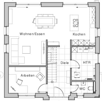

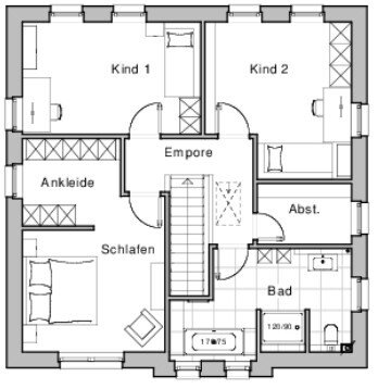

pagoni202020 Jul 2020 20:13I strongly advocate designing your house to meet your personal needs as much as possible.
However, from what I’ve read, you seem to put a lot of thought into storage space, luggage, etc., while at the same time accepting that there wouldn’t be room for a bookshelf or anything similar in the living area. Your approach to such valuable living space and bedrooms (which mean living quality) as “not necessarily needed” could never be mine, because I love openness and generosity in a room; that’s exactly why I’m building a house.
I would rather be annoyed that storage space takes away from living space. Of course, you can fit a double bed into just 10cm (5 inches) if necessary. You don’t need a living room, a gallery, or all that... but it’s great to have them and to be able to enjoy them.
Your mindset is therefore foreign to me, and I would feel as if my clutter or “stuff” controls me and prevents generous living. For practical reasons alone, I wouldn’t rebuild, but also simply because I want to create nice things for myself that might have taken a backseat with children. I strongly believe there are dream home concepts for you that can appear much more open and spacious while still meeting your other requirements.
I’m not a floor plan specialist, but I’m sure that much better solutions exist for you as well. Whether my approach suits you is of course something only you can decide.
If you really have that much stuff to store (maybe that’s the problem—you might just have too many suitcases, etc.), then why not build a garden shed without needing a building permit/planning permission, in a modern and attractive design? You could store all that stuff there. You could use it like a basement or utility room, or even outsource a technical room there instead of a basement; and if needed, you could also “relocate” some guests there.
So I don’t really have a solution, just a different approach: minimal storage and maximum comfort in living. Even for the office area, living quality would come first, followed by functionality. Home office can be done in many flexible ways.
Upstairs would feel too closed off to me; I would miss having an open area.
As mentioned above, the problem is that we have to fit both the garage and the house within the building area, and edge development is not allowed. Hausbewohner schrieb:
Moving the kitchen closer to the entrance would either mean placing it next to the garage (with no windows) or orienting it completely to the north (which we don’t like either). I really think it’s not appropriate to place the garage there.
A lot would improve if it were moved out of the sun.
Otherwise, it’s no problem to position a garage within a 14-meter (46-foot) wide building area – don’t we all have similar restrictions here?
And yes: I would also prioritize planning the living spaces first, then the parking area.
