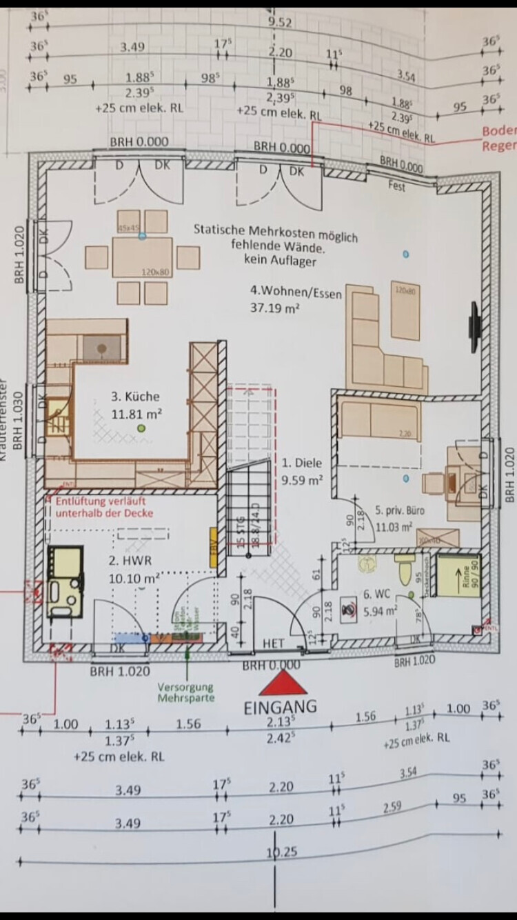

Hello dear members,
After a long time of quietly following the forum and officially reserving our preferred plot, we are now venturing into planning our urban villa. We have drawn inspiration from many catalog floor plans and sketched extensively on paper. The result is a design we are reasonably satisfied with. We would now like to have it reviewed by you to understand what works (or doesn’t).
First, the questionnaire:
Plot size 600 sqm (20x30 m) (6460 sq ft, 66x98 ft)
Slope no
Building area, building line and boundary 3 m (10 ft) setback
Number of parking spaces 2
Number of floors max. 2
Roof style any
Architectural style modern
Orientation garden facing southwest
Client requirements
Architectural style, roof type, building type urban villa with hipped roof
Basement, floors 2 floors without basement
Number of occupants, ages 3 (36, 35, 2)
Room area on ground and upper floors approx. 85 sqm (915 sq ft) each
Overnight guests per year 4
Open or closed architecture open
Open kitchen, kitchen island yes
Number of dining seats 6, extendable to 10
Balcony, roof terrace no
Garage, carport double garage
Who designed it? do-it-yourself
What do you like most? Why? Our space requirements are met. Front entrance centered.

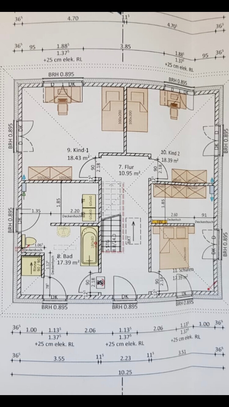

What do you dislike? Why? We are unsure if the upper floor works as planned. To make the fitness room functional in size, we had to move walls and reduce the upstairs hallway. Could this result in too little natural light on the upper floor? Also, we are uncertain if the utility room is adequately sized.
Preferred heating system: air-to-water heat pump + controlled mechanical ventilation
If you had to give up, which details/ additions would you omit
-could you give up: pantry, door from utility room to garage, straight staircase (even though we like it for being easy to use and providing storage underneath)
-could you not give up: fitness room, two children's bedrooms, office
Why is the design the way it is? For example,
What do you consider particularly good or bad about it? See above. We have included all the required rooms but are not sure the upper floor layout works. We also have concerns about storage space.
Regarding orientation, the plan is to position the house as close as possible to the street (northeast) to maximize garden space in the southwest.
Enough said: we look forward to feedback from the lions’ den. ;-)

Yes, the staircase was planned to be built closed in order to use the storage space underneath.If I were you, I would also draw a wall there, so you see exactly what you will get – a narrow, long hallway.
hampshire22 Sep 2021 13:09miriam85 schrieb:
We’re a bit shocked right now, but thanks nevertheless for your honest feedback.Try to let go of the square floor plan that you don’t actually need on your plot. This makes things much easier. Square floor plans are great if you want to save on cost per square meter or if you’re simply in love with that shape. They are only practical on very small plots to fill the building area. The more dark square meters (square feet) of space you have inside, the more the rooms compete for natural light. A rectangular layout helps solve this problem because more exterior wall means more access to light, creating more usable rooms. Often, this can even reduce the total square meters (square feet) and thus be quite cost-neutral for the builder.A
Alessandro22 Sep 2021 13:15miriam85 schrieb:
Thank you for the tip. We had already considered that. We definitely wanted the entrance centered at the front and couldn’t find space for a landing staircase without losing a room on the ground floor... Maybe we are just thinking too narrowly. You can also place a landing staircase in the center of the house. See Bien-Zenker Evolution 161
(of course, it’s not exactly a landing staircase, but it shows that there are solutions for centrally located stairs)

Friends of ours are currently building this floor plan, might be interesting for you since it’s almost identical.
It’s not really my style, but it was fully planned with their construction company.
Brave choice for the bedroom 😳
I always wonder where people keep their wardrobe...
The space under the straight staircase looks really poor.
Who plans for a 120cm x 80cm (47in x 31in) dining table? If you make it longer, you block access to the kitchen.
miriam85 schrieb:
Thanks for the tip. We had already considered that. We definitely wanted the entrance centered at the front, and couldn’t find space for the landing stairs without losing a room on the ground floor... Maybe our thinking is just too limited.That was just a thought sparked because we have the entrance at the front ourselves, and it sometimes bothers me. If I were to build again, I would probably do it differently. With our door open, you can see straight from the street through the entire hallway into the living room. That can be annoying when you leave the door open just to quickly take something out, load the car, or when the kid chats by the door with a friend for half an hour until he finally gets dressed. During that time, anyone walking by can see right through the whole house.
You can observe similar situations with the neighbors, but they have their doors facing the driveway, not the street.
