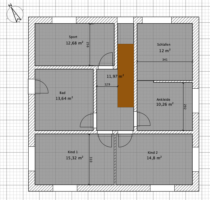

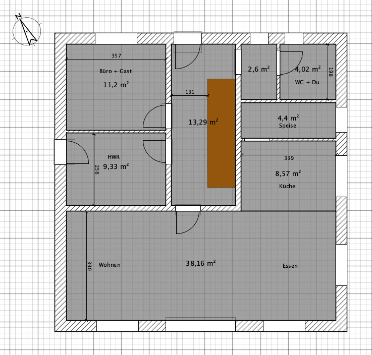

Hello dear members,
After a long time of quietly following the forum and officially reserving our preferred plot, we are now venturing into planning our urban villa. We have drawn inspiration from many catalog floor plans and sketched extensively on paper. The result is a design we are reasonably satisfied with. We would now like to have it reviewed by you to understand what works (or doesn’t).
First, the questionnaire:
Plot size 600 sqm (20x30 m) (6460 sq ft, 66x98 ft)
Slope no
Building area, building line and boundary 3 m (10 ft) setback
Number of parking spaces 2
Number of floors max. 2
Roof style any
Architectural style modern
Orientation garden facing southwest
Client requirements
Architectural style, roof type, building type urban villa with hipped roof
Basement, floors 2 floors without basement
Number of occupants, ages 3 (36, 35, 2)
Room area on ground and upper floors approx. 85 sqm (915 sq ft) each
Overnight guests per year 4
Open or closed architecture open
Open kitchen, kitchen island yes
Number of dining seats 6, extendable to 10
Balcony, roof terrace no
Garage, carport double garage
Who designed it? do-it-yourself
What do you like most? Why? Our space requirements are met. Front entrance centered.
What do you dislike? Why? We are unsure if the upper floor works as planned. To make the fitness room functional in size, we had to move walls and reduce the upstairs hallway. Could this result in too little natural light on the upper floor? Also, we are uncertain if the utility room is adequately sized.
Preferred heating system: air-to-water heat pump + controlled mechanical ventilation
If you had to give up, which details/ additions would you omit
-could you give up: pantry, door from utility room to garage, straight staircase (even though we like it for being easy to use and providing storage underneath)
-could you not give up: fitness room, two children's bedrooms, office
Why is the design the way it is? For example,
What do you consider particularly good or bad about it? See above. We have included all the required rooms but are not sure the upper floor layout works. We also have concerns about storage space.
Regarding orientation, the plan is to position the house as close as possible to the street (northeast) to maximize garden space in the southwest.
Enough said: we look forward to feedback from the lions’ den. ;-)
