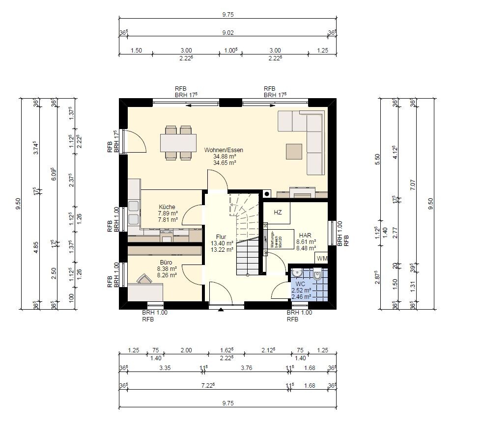

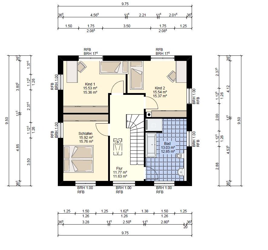

Origin of the plans: initial rough drafts by us after consultation with builder
What do you like most? Why? Spacious, bright living-dining area; office on ground floor; size of rooms on upper floor
What do you like less? Why? Kitchen size; lack of space for coat storage; (too) large hallway on upper floor; entrance area for child 1
Personal price limit for house, including fixtures and fittings:
-can be omitted: separate kitchen entrance, stair design
-cannot be omitted: L-shaped kitchen/living area, office/workspace (ground or upper floor), children’s rooms facing southwest (garden)
Standard design from the planner? no
Which wishes from you were implemented by the architect?
A mix of many examples from various magazines: yes
What do you think makes it particularly good or bad? good: all necessary rooms included; less good: kitchen size, lack of space for coat storage, (too) large hallway on upper floor, entrance area for child 1
Are there any other obvious criticisms or suggestions for improvement on your side?
Do you have suggestions to address or improve the points we mentioned (e.g., enlarge the kitchen width of 3.35 m (11 ft), add coat storage, redesign the upper floor hallway/access to rooms for better use)? Could changing the staircase design or location help optimize the layout?

I would move away from the square floor plan and embrace asymmetry even more consistently. The bathroom has plenty of open space.
Just a quick skim…
- Cloakroom (as you say) is missing. You could install one on the wall next to the inward-opening bathroom door, but that wouldn’t be nice or spacious.
- The door to the kitchen is very awkwardly placed.
- Dining table space is very limited.
- Upper floor: shift square meters from bathroom/hallway to bedroom/kids’ room.
- I would choose a different staircase.
- Storage areas/rooms?

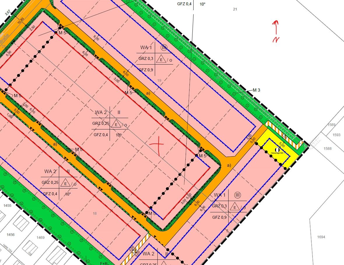

gutentag schrieb:
What does the development plan say about parking spaces? The drawing clearly indicates the following: one driveway per property, grouped in pairs at the corner, and the building line starts just 6m (20 feet) from there. So, I don’t see how a parking space requirement can be met between the street and the building line.
Thank you for your questions, it was clear that some information from my side was still missing.
We are not particularly attached to the square floor plan and are ready to change it immediately if some good ideas encourage us to do so.
We can also do without the door to the kitchen and most likely will.
The placement of furniture, kitchen, and items is by the draftsman, as is the bathroom layout. So please don’t take those as final references; I should have mentioned that in the initial post. For the dining table later on, a much larger one is planned (first ideas are around 1 x 2 m (3 ft 3 in x 6 ft 7 in), since the family is not getting any smaller).
Which staircase would you choose? Would you place it somewhere else?
We have already thought about storage spaces and are a bit unhappy about them, mainly because there are not enough.
The plot dimensions are 18.5 m x 34 m (61 ft x 111 ft).
The development plan says the following about parking spaces:
"Parking spaces and garages are not allowed in building zones outside the building boundaries and building lines along traffic areas. Parking spaces may be exceptionally permitted in general residential zones WA 1 outside the building boundaries along traffic areas if access is secured and there are no conflicts with green-landscape regulations."
We will park the cars next to the house, on the side of the utility room.
I would move away from the square floor plan and also let go of symmetry even more consistently. The bathroom has a lot of free space.
driver55 schrieb:
Just skimmed through…
- Cloakroom (as you said) none. It would be possible to set one up on the wall where the inward-opening WC door is, but it wouldn’t be nice or spacious.
- The door to the kitchen is very inconveniently placed.
- Dining table is very modest in size.
- Upstairs: shift floor space from bathroom/hallway to bedroom/child’s room.
- Storage space/rooms?
gutentag schrieb:
What are the dimensions of the plot?
