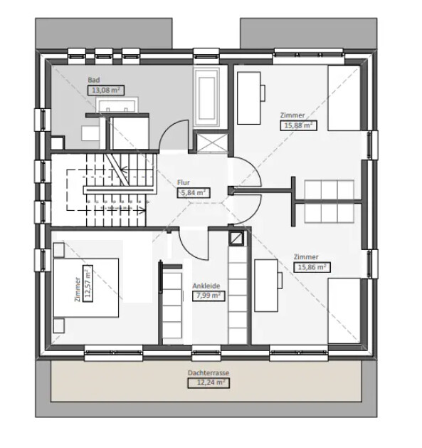

The architect has fulfilled most of our wishes, but the entire kitchen area is definitely still problematic, as it is too narrow and long. Due to the house shape, widening the kitchen is unfortunately not possible without affecting the light-flooded entrance area or making the house wider (which we would prefer but cannot due to the plot’s dimensions, as a 2.75m (9 ft) distance to the boundary has already been planned on both sides). Originally, we planned a pantry accessible through the kitchen front (yes, a somewhat modern convenience) placed on the north side of the kitchen, but this would block the light axis in that area and make the northern side windows redundant.
Furthermore, the bathroom on the upper floor is under discussion. Although we like the idea of a separate toilet, the shower and washbasin area may make the room feel smaller overall, even though it is quite large.
The upper-floor bedroom is also not perfect yet. We wanted a separate walk-in closet, but due to limited space on the upper floor (single-story design without roof slopes), the bedroom feels relatively small and we would prefer it to be a bit more spacious. The children’s rooms are generous enough.

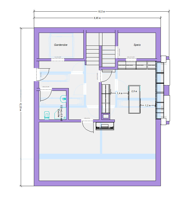

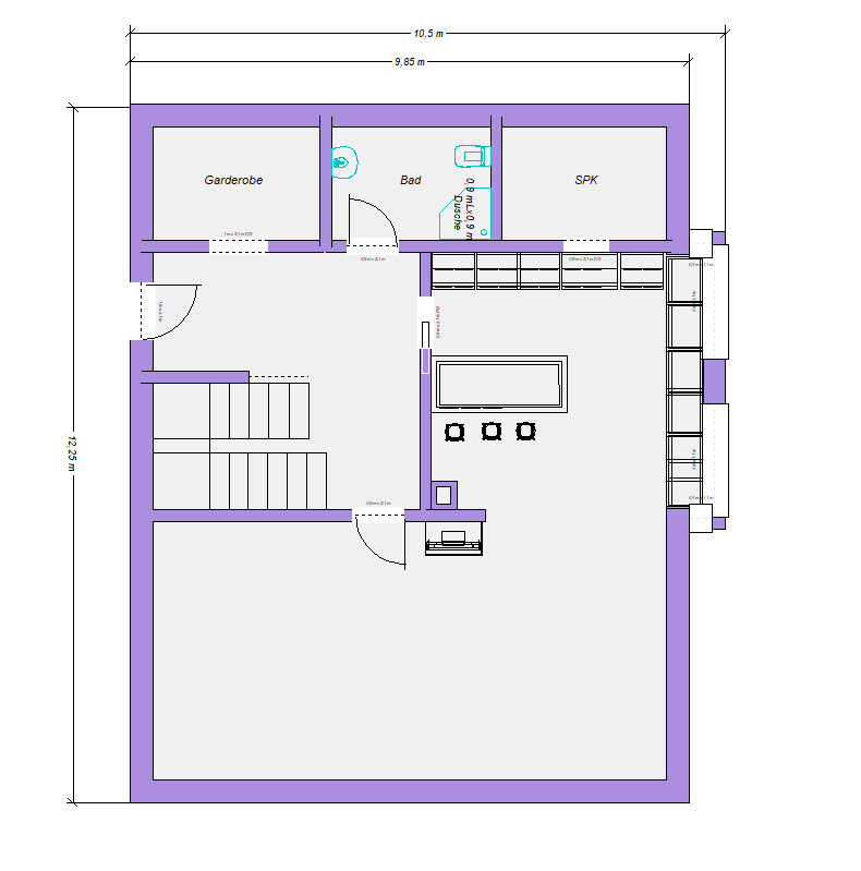

Our original idea was to have a pantry accessible from the kitchen front (yes, I know, a modern convenience) and locate it on the north side of the kitchen. However, this would block the light axis in that area and make the north-facing side windows useless.
That sounds rehearsed. Did the architect explain it to you like that?
Light axis or not – in this case, it wouldn’t be my top priority and it should give way to the pantry. Given the available width, you need to extend lengthwise to create sufficient space. A central entrance on the north side with a spacious entry area inevitably results in a kitchen that is not narrow. That’s why I would move away from this entrance and consider an entrance on the side instead, something like this:

The bathroom upstairs is also still under discussion. We like the idea of a separate toilet, but the shower and washbasin area might make the entire room feel smaller, even though it’s actually large.
I wouldn’t do that either. The room is too narrow for the toilet, and it would feel cramped. There are plenty of beautiful bathrooms without a hidden toilet. You can’t afford to be wasteful with space upstairs anyway.

The bedroom upstairs is also not perfect yet because we wanted a separate walk-in closet. But due to limited space upstairs (single-story design without sloped ceilings), the bedroom is quite small and we would prefer it to be a bit more spacious. The kids’ rooms are generously sized, though.

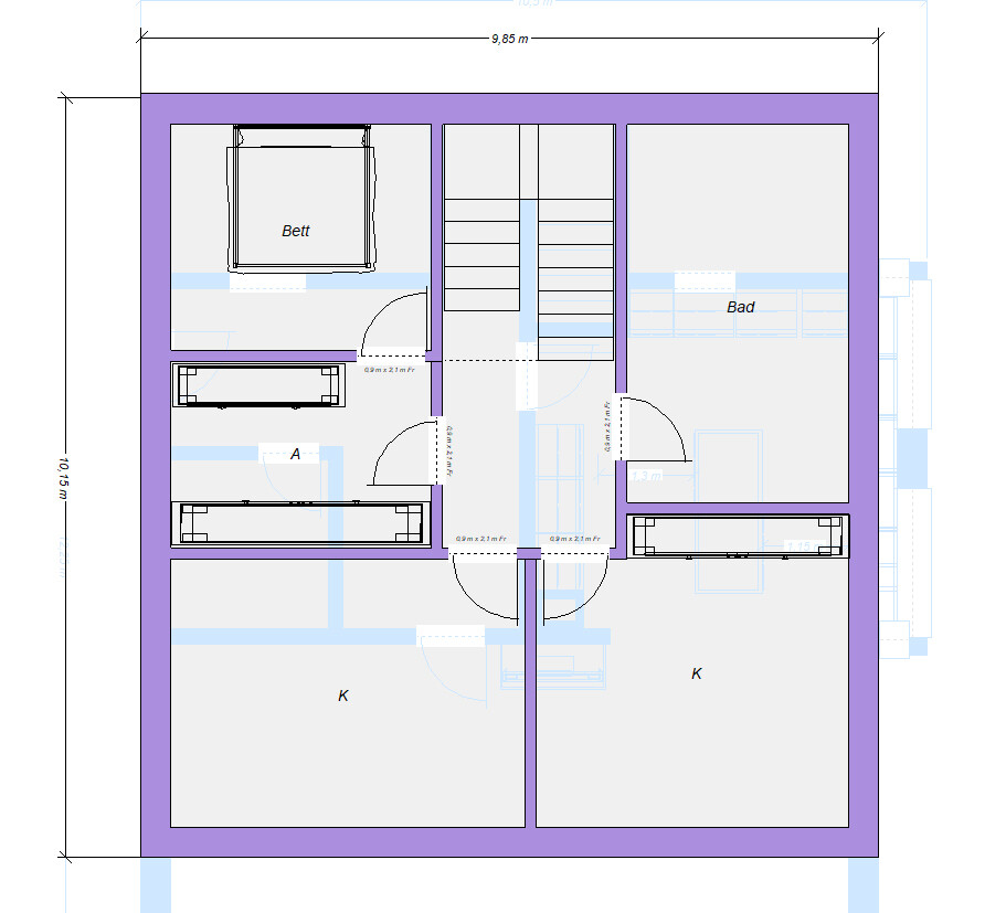

In my opinion, the room is large enough. Try rotating the bed. That way, the walk-in closet can grow at least a little. I left the small projection (“pups”) opposite the bed to show where the wall originally was. Also, it’s more comfortable if the door isn’t right next to the headboard. The west-facing window might need to shift slightly north or be removed entirely. What bothers me more is the complicated partitioning of the kids’ rooms, plus the bedroom located in the south where the kids would actually benefit more from it. The whole arrangement still feels quite awkward.

Yes, the carport or parking spaces seem underconsidered, especially in relation to windows or light wells. I would always have those drawn in to avoid nasty surprises later.
You might also consider placing the staircase on the north side:
Floor plan: wardrobe on the left, pantry on the right, stairs in the middle, bathroom bottom left, living area at the bottom.
Floor plan of a residential house: two identical apartments with bed, bath, kitchen, and hallway.
This makes the layout upstairs smoother and more sensible. Kids get the light, the bathroom faces the morning sun, and the parents just have to deal with whatever’s left.
By the way, you should think carefully about the partition wall in the living room. On paper it looks tidy, but in reality it’s just a “darkening wall.” It’s absolutely worth reviewing in 3D!

That sounds rehearsed to me. Did the architect explain it to you that way? Light axis or not – in this case, that wouldn’t be my top priority and it should give way to the pantry. Given the fixed width, you will need to extend in length to create enough space. A central entrance on the north side with a generous entry area inevitably results in a kitchen that is not narrow. That’s why I would move away from this entrance and consider an entrance on the side instead.
That’s an approach we have already considered, but then the house looks quite unattractive from the street side, and we want it to be visually appealing. We’ll try the current concept with a pantry on the north side and a kitchen smaller than now, but with a U-shape layout instead of a freestanding island.

In my opinion, the room is big enough. Try rotating the bed. The walk-in closet can then grow slightly. I left the “little protrusion” opposite to show where the wall was originally. Also, it’s more comfortable if the door isn’t right next to the headboard. The west-facing window would need to be shifted slightly toward the north or removed entirely. What bothers me more is the fiddling with the kids’ room walls, plus the bedroom in the south, where the children would actually benefit more. It all still feels quite disjointed.
Thanks for the suggestion. We will definitely rotate the bed; the question is the walk-in closet. We currently have one that is accessible through the bedroom but not as a passage room. We visited one yesterday similar to your sketch, and we didn’t like walking straight into the “tight” closet (possibly messy) when entering.

Yes, the carport or parking spaces still seem undecided. Especially in relation to windows or light wells. I would always make sure these are included in the drawings. Otherwise, you could end up with unpleasant surprises afterward.
Could you elaborate on that? If we place the garage along the eastern boundary behind the house, does that interfere with windows or light wells?
K a t j a schrieb:
By the way, you should think carefully about the partition wall in the living room. On paper, it looks quite attractive, but in reality, that’s basically a "darkening wall." You definitely need to see it in 3D!
We don’t want that anyway—that was the architect’s suggestion. Some friends have it like that, and I miss the open feeling in the room.
