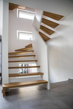

Modern wooden staircase with glass railing in a bright interior, light through windows
If the window is positioned lower like this, it should provide more than enough light.

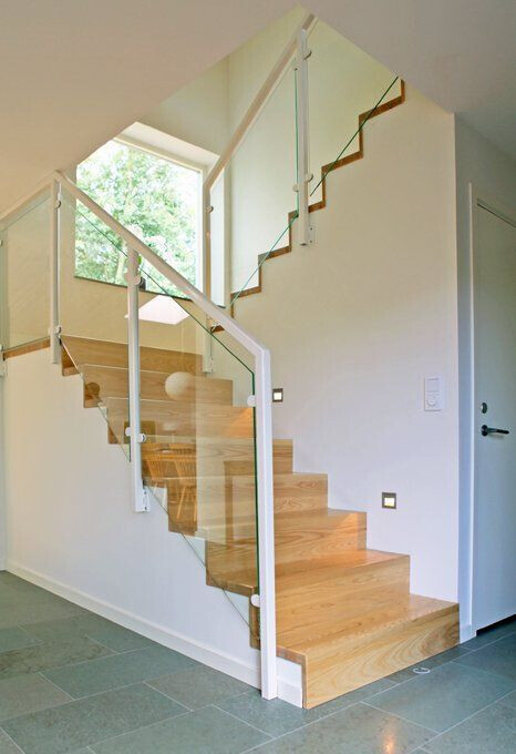

Modern wooden staircase with open risers in a bright interior with natural daylight.
An open staircase allows even more light to pass through.

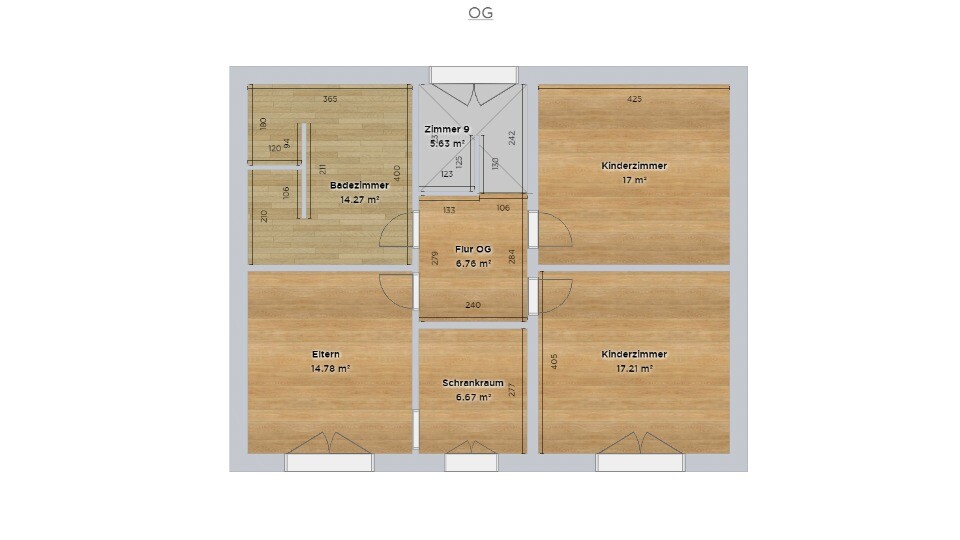

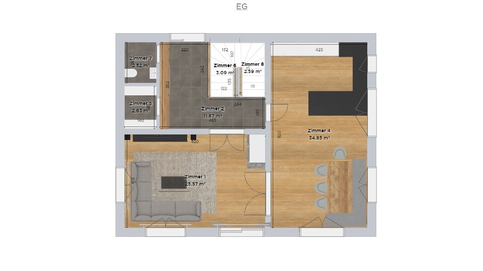

Here is the change with the 25cm (10 inches).
I'm not sure if it really makes much difference...
Floor plan of a residential layout showing rooms 1–8, living room, kitchen, and dining area.
Floor plan of the upper floor (first floor): master bedroom, two children's rooms, bathroom, hallway, walk-in closet.
Würfel*
27 Jul 2021 11:29
I like it better this way; you have a great, spacious kitchen and dining area! With a 400 cm (13 ft) kitchen front, you can fit 360 cm (12 ft) of standard cabinets plus panels or an additional narrow cabinet. For people who are perfectionists about symmetry in kitchen fronts, this might not be ideal 😉 The living room is also comfortably large at 25 m² (270 ft²).
In the bathroom, I would place the door in the center, the toilet under the window, and the sink opposite. This way, the door won't be right up against the wall.

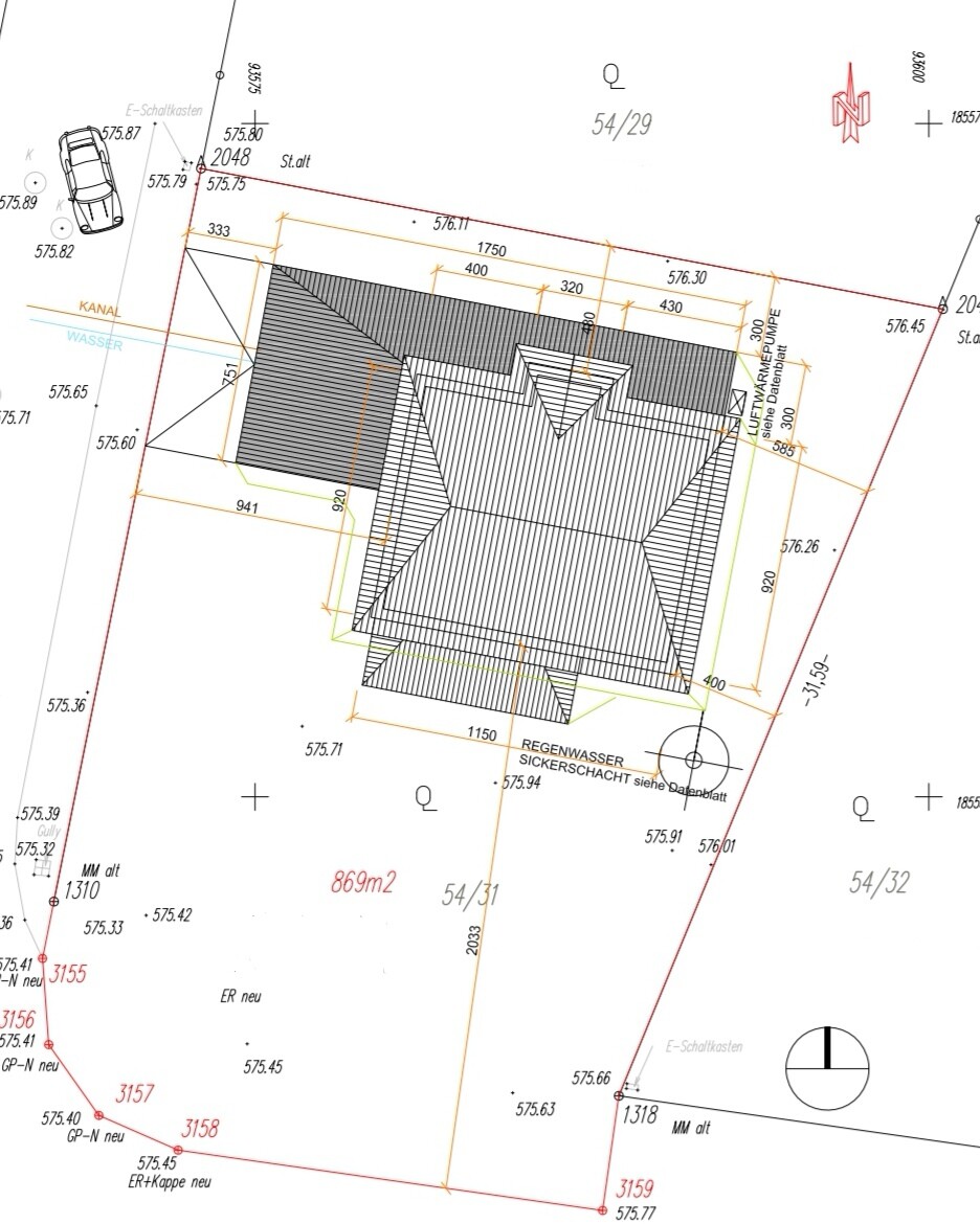

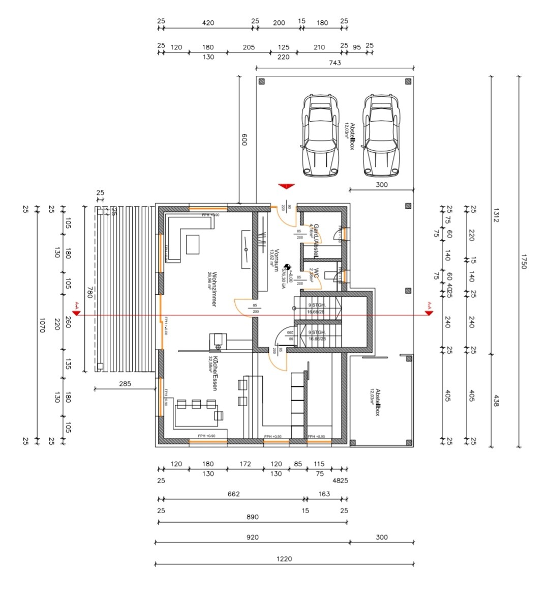

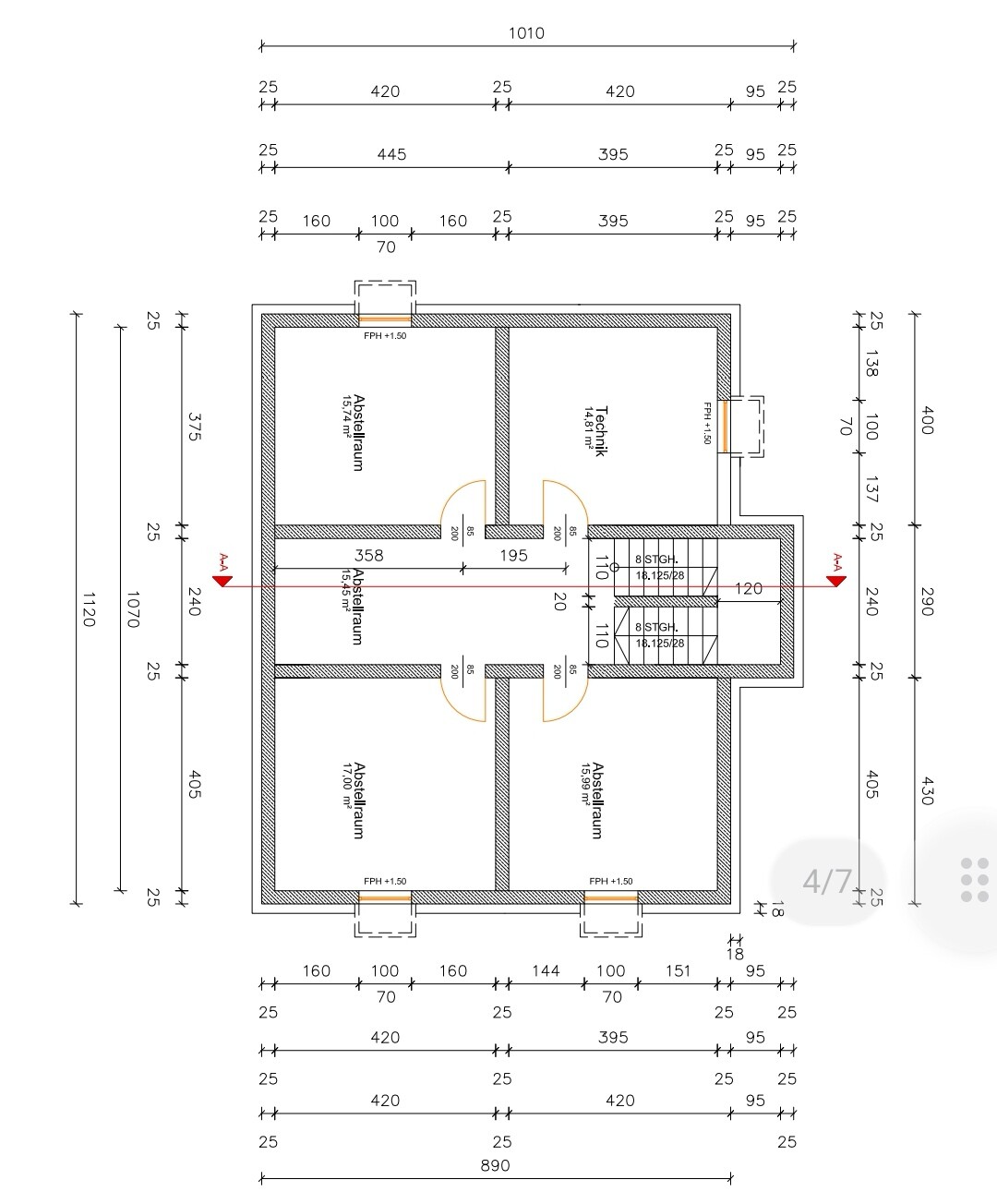

22 Nov 2021 21:17
Hello!
We have now had everything planned and made some changes.
What do you think of the new plan?
Floor plan of a single-family house with roof, dimension lines, and property boundaries.
Floor plan of a house with living, kitchen, and dining areas, staircase, and garage for two cars.

Floor plan of a building with storage rooms, utility room, staircase, doors, and dimensions.
