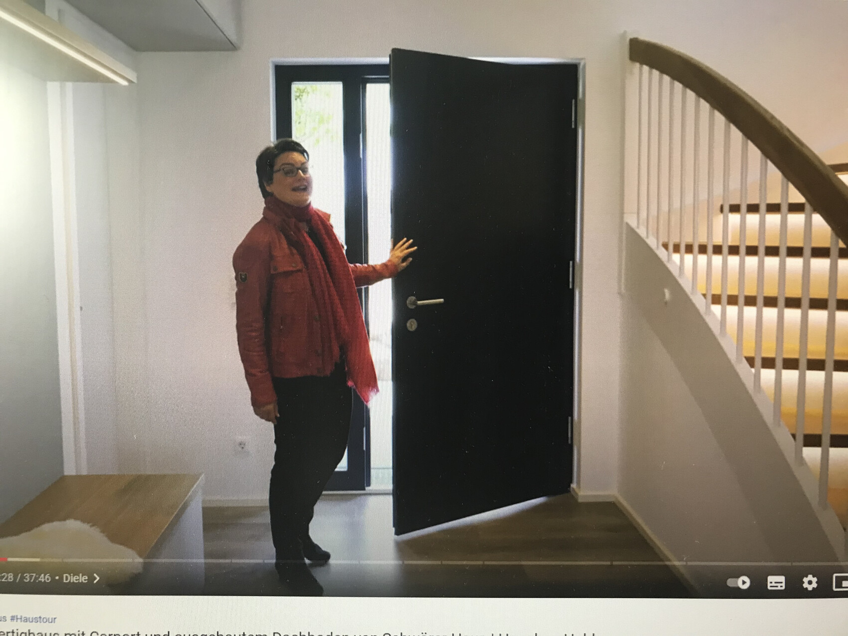

BauFamily schrieb:
This is the show home from Schwörerhaus, which was featured on YouTube by Hausbauhelden. There is plenty of natural light in the entrance area, no artificial lighting.
I just took a look.
But you did notice that in the video, on the brightest day, all the lights are turned on, right?

Addition: furthermore, the show house has a large sliding door to the living room directly opposite the front door. In the floor plan, there is only a smaller door offset opposite the staircase.

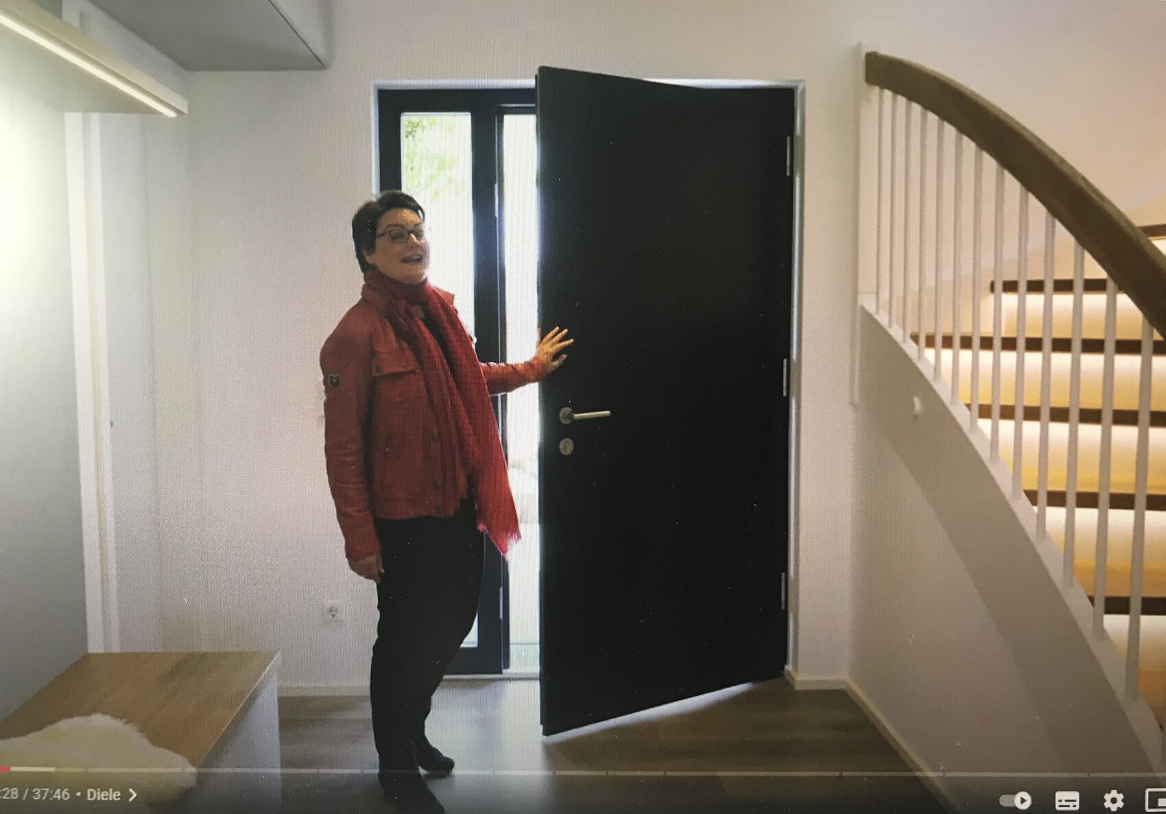

BauFamily schrieb:
That is the show home from Schwörerhaus which was featured on YouTube by Hausbauhelden. There is enough natural light in the entrance area without any tricks.
A video is always recorded with main lighting. Schwörerhaus will pay a lot for the shooting — nobody is walking around with an amateur camera.
Bright entrance area with blue front door, wooden staircase on the right, coat rack and bench.
A person in a red jacket and scarf standing in the hallway in front of an open black door; staircase on the right.
But anyway. In the design we are discussing, the layout is not as open as in the Schwörerhaus.
However, this can be fixed by using a door with glass. Here the door is closed because the house opens in the opposite direction and no one can look into the dining area.
Person in red jacket and scarf opening a black door in a bright hallway next to a staircase.
