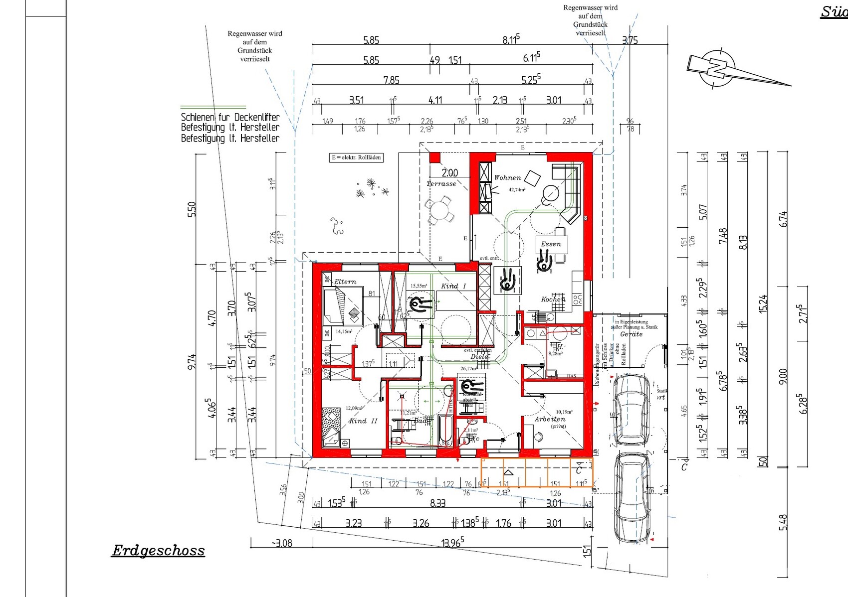

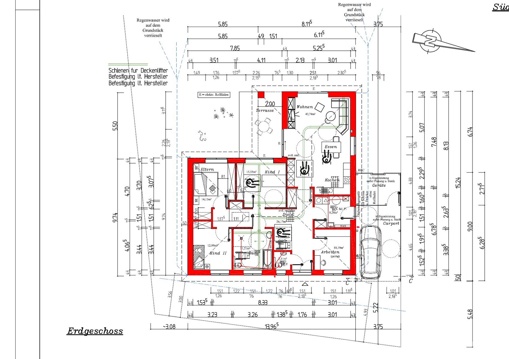

I have made a few changes to our floor plan. 00 is the current plan and 01 is my proposed version.
The advantage of 01 is having a window in the kitchen and more space in the utility room. If a covered entrance is desired, that can be added (it does not necessarily have to be a side entrance door from the carport).
What do you think?
Another consideration is the entrance door from the living room, where a sliding door would make the most sense. However, there is a lack of about 17 cm (7 inches) of space for this. There were two suggestions: 1. extend the wardrobe 17 cm (7 inches) into child’s room 1, 2. make the study, utility room, and kitchen 17 cm (7 inches) narrower. I don’t really like either of these options.
Does anyone maybe have a better idea?
Any other suggestions and improvements?
We would really appreciate your opinions.

1. A utility room without a window but with a fan is acceptable, or should a window be planned there? (The window would then be located under the carport.)
2. The entrance from the living room is not yet ideal for me. What do you think about removing the door from the living room completely? I can’t quite tell if it would feel comfortable or not.

1. Utility room without a window but with a ventilation fan is acceptable, or should a window be planned there? (Window would then be under the carport)Use a glass panel at the top of the door to bring in light without needing an extra window. For ventilation, a window is not very practical—who would go there just to close it again? So it would likely stay permanently tilted open, which isn’t ideal.zizzi schrieb:
2. The entrance from the living room is not ideal for me yet. What do you think about removing the living room door completely?Having a door doesn’t mean it has to be kept closed all the time, but with no door, the space is always open.https://www.instagram.com/11antgmxde/
Use a glass panel at the top of the door to bring in light without adding an extra window. For ventilation, a window isn’t very practical—who would go all the way there just to close it again? So it would likely be left open permanently, which isn’t ideal either. Nonsense. A room without a window is always, always, always a bad idea. And a bungalow certainly doesn’t require a long trek to reach it. Even being under a carport is better than nothing. Just for situations where you need to pass something through the window (we’ve had to do this multiple times, whether water, electricity, tools, or climbing gear) — imagine if you want to vacuum the car and there’s no outdoor power outlet — boom, cable through the window.

A room without a window is always, always, always a bad idea. And a bungalow certainly doesn’t require an exhausting trek to reach your destination. It’s not a living space. In theory, I agree with your view, but in practice, I expect the window to be left tilted open most of the time. Therefore, I consider integrating it into the mechanical ventilation system to be sensible (and then a “closed” window does not cause any loss).
kaho674 schrieb:
if there isn’t an outdoor socket – boom, cable through the window. If there is no outdoor socket: well, someone who forgot it should be held accountable. This is something not to be overlooked in new construction. And it should be switchable, after all, it’s not supposed to be an outdoor outlet for burglars ;-)
