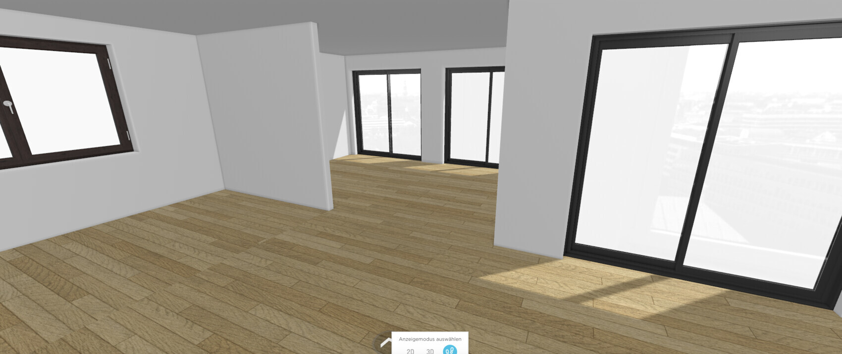

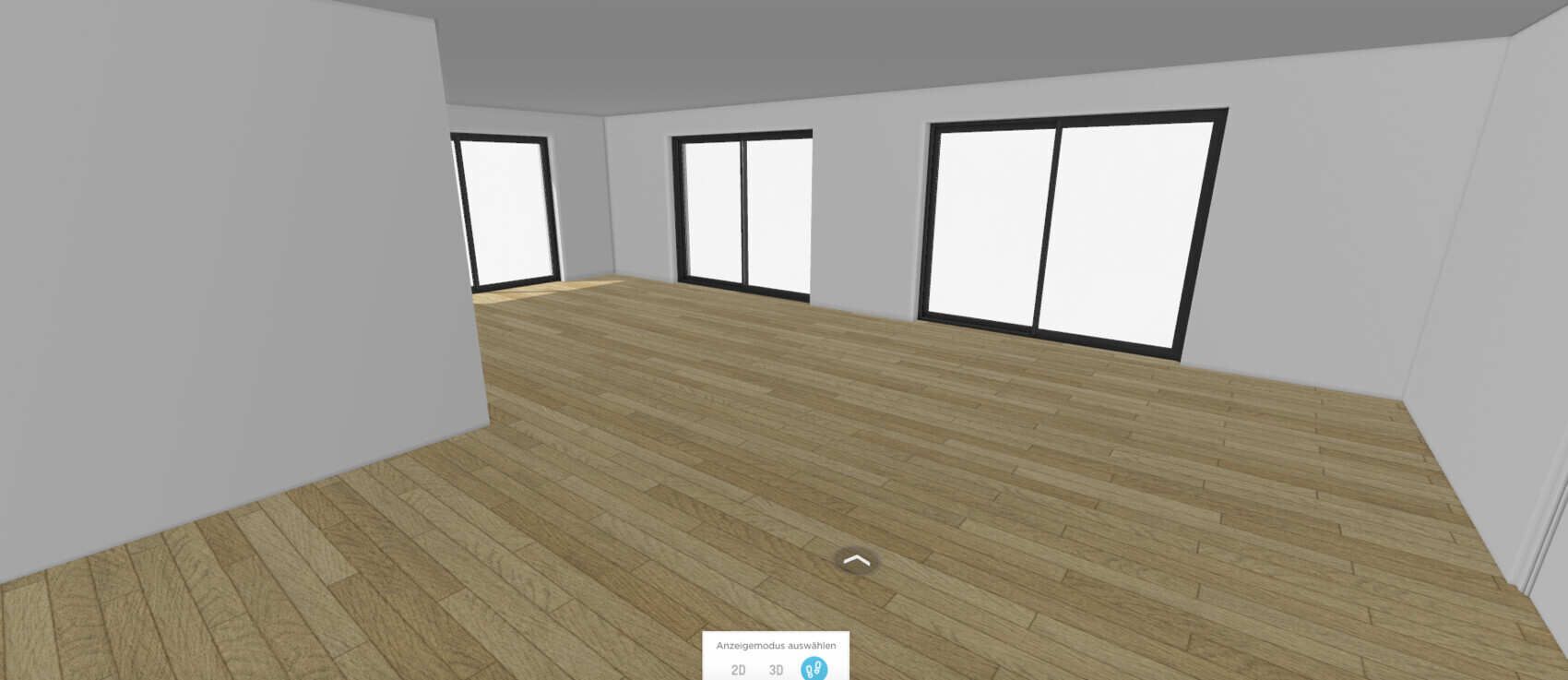

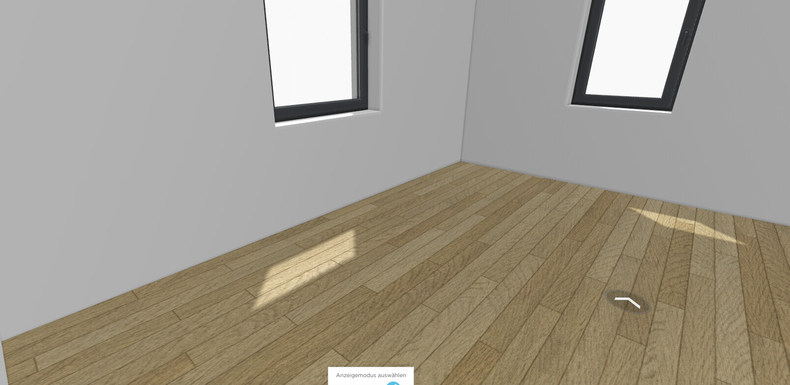

I count 7 different window widths: front 70 cm (28 inches) and 120 cm (47 inches), southwest side 90 cm (35 inches), living area 270 cm (106 inches), northeast 230 cm (91 inches) and 140 cm (55 inches). That’s what I call aesthetics 😉 How about choosing one window size for the “smaller” windows? Your design will thank you for that. Even a bungalow needs a load-bearing wall. With a width close to 15 meters (49 feet), two load-bearing walls would make the structural engineering cheaper.
Basically: the house is very dark. Where there is daylight, there are small windows, and where there aren’t windows, they’re big. But the big ones don’t illuminate the center. The kitchen is the darkest spot in the entire house. The brightest spot is the computer workstation in the office (which really doesn’t need any extra light).
Do yourselves a favor and position the rooms so that the home theater is in the northeast, the kitchen gets the light with at least 2 sqm (21.5 sq ft) of window area. If you have to give up 20 sqm (215 sq ft) for cost reasons, move the home theater upstairs. With a gable roof, that’s very possible.
Your office:
Your living room:
A comparable other property facing south:
Homebyme only indicates the sun at noon weakly, but that’s a hint whether light actually shines through a window.

About the house itself:
Your office:
Your living room:
