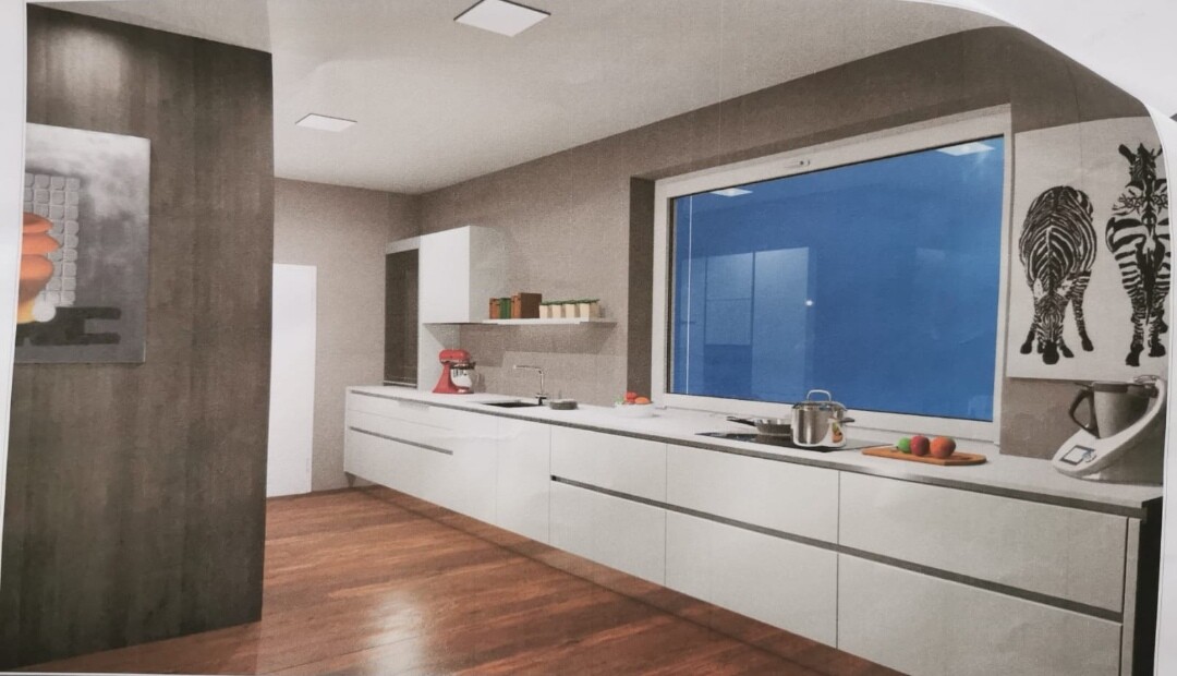

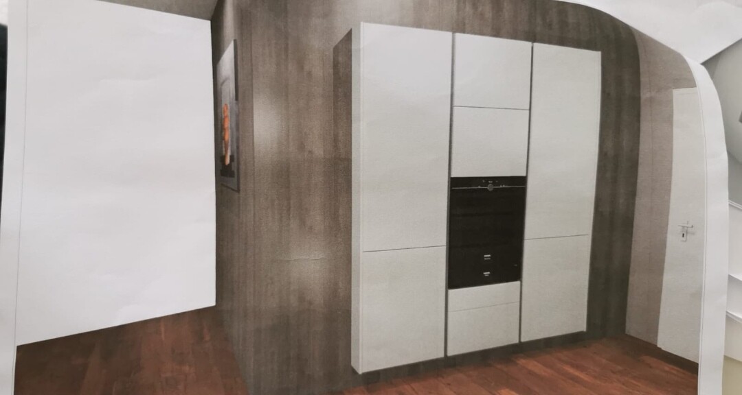

  • How will you use the kitchen – the layout wouldn’t suit my typical “running routes” well.
Yes, the routes are not the usual short ones, but that’s how the kitchen turned out and we made the best of it (in our opinion).
