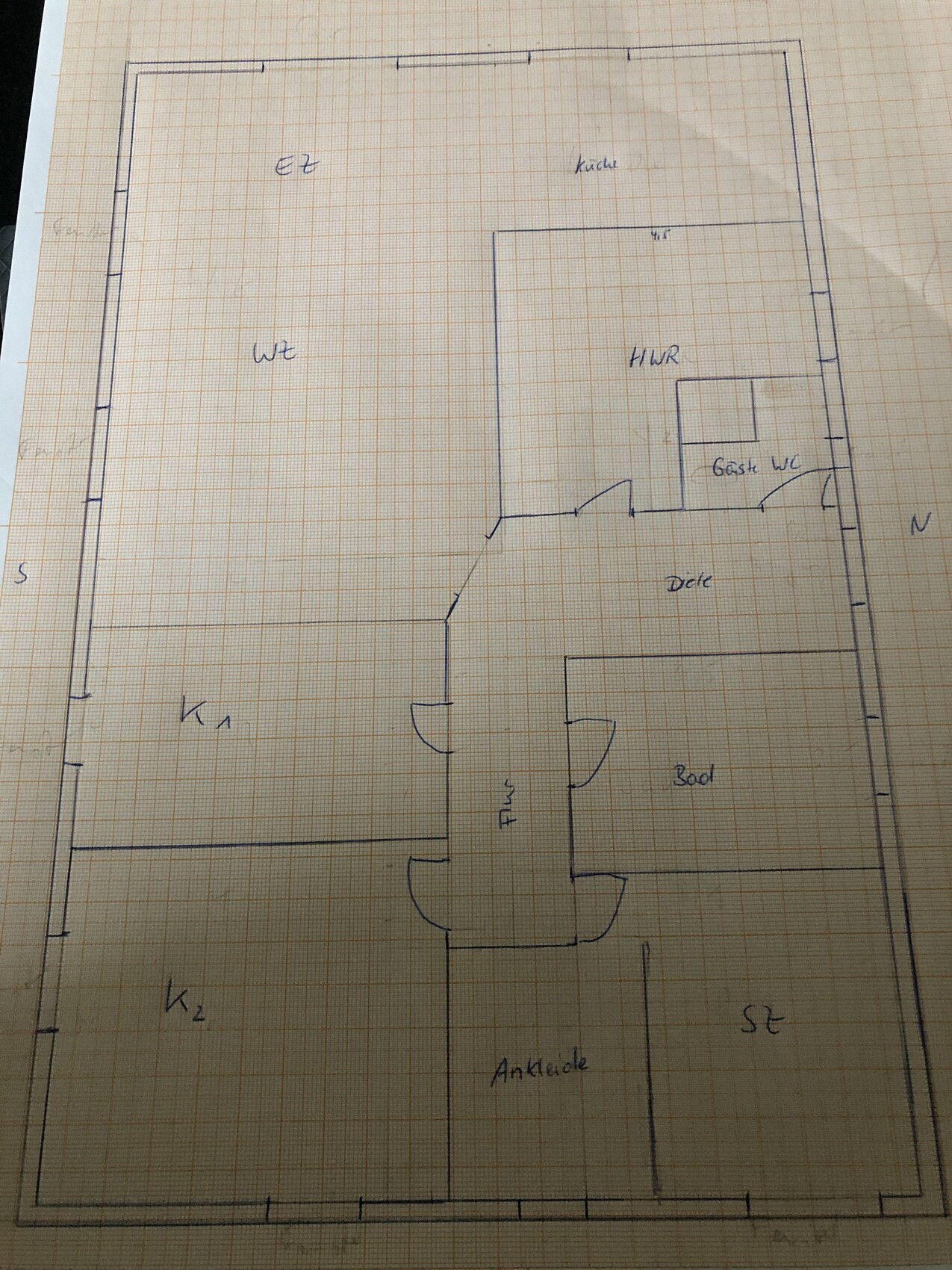

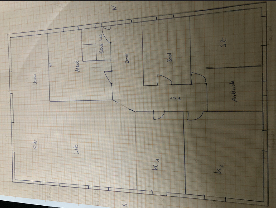

Since I am not sure if I am allowed to share the architect’s draft, I have sketched the floor plan on graph paper and would like your opinions.
Exterior walls are 36.5 Poroton (approx. 14 inches), interior walls according to specifications are 11.5 and 17.5 Poroton (approx. 5 and 7 inches).

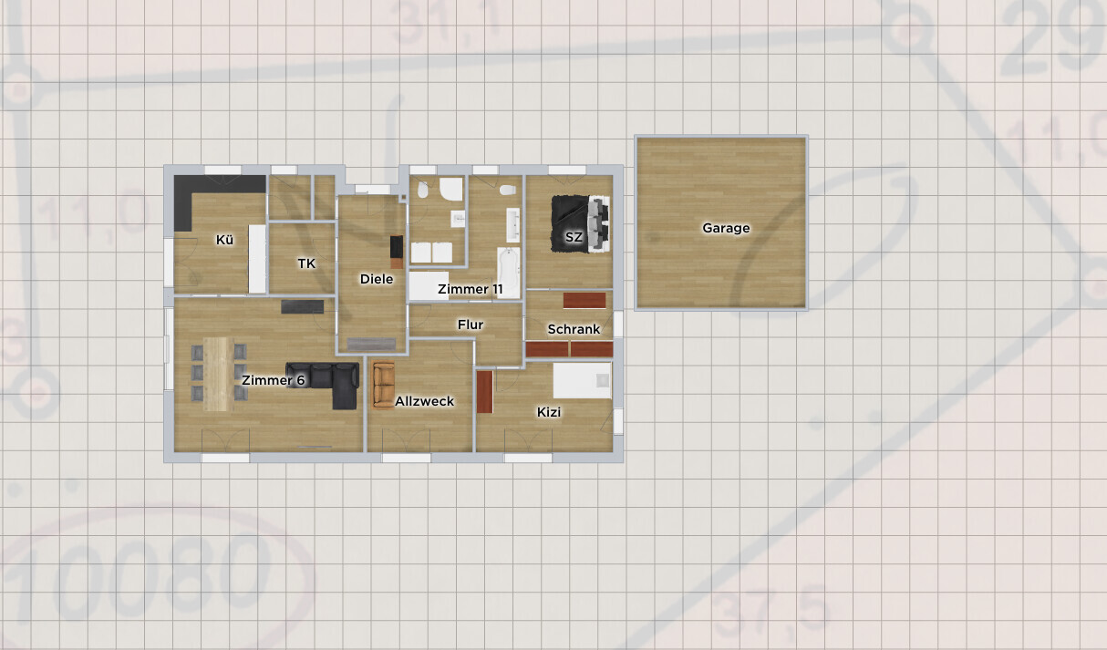

I put together a little something.
And now it’s your turn to share your windowless inspiration! 🙂Well, I went ahead and added windows and doors after all... :-p
