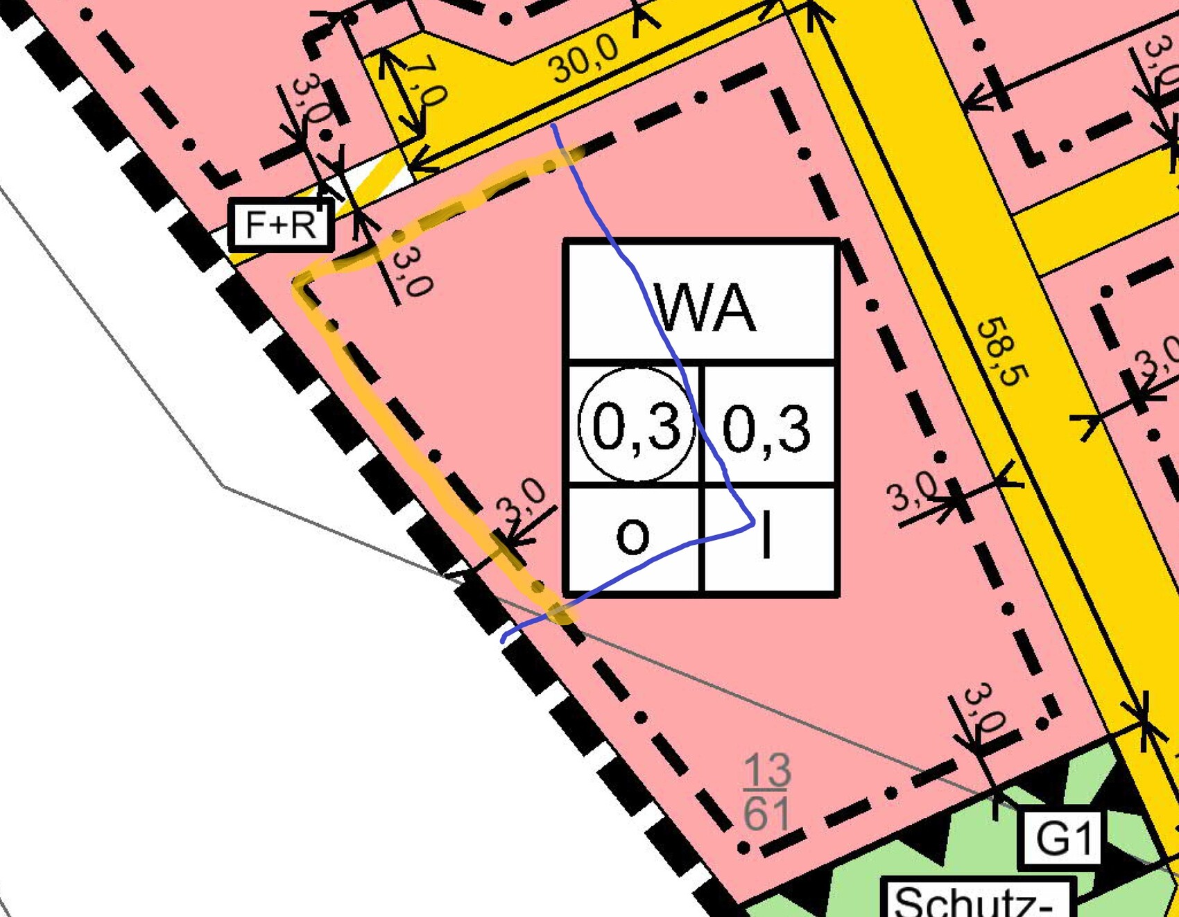

hanghaus202321 Apr 2024 07:45forrestde schrieb:
Thanks for the suggestion. You’re welcome.
forrestde schrieb:
We don’t like the floor plan, I already mentioned it’s just a placeholder.
forrestde schrieb:
The garage is not permitted as is, because the 3m (10 feet) building setback line at the top of the plan must be observed. Only boundary building is allowed on the right side toward the neighboring property. I’ll believe that once I’ve seen the full development plan.
F
forrestde21 Apr 2024 09:51forrestde schrieb:
But there is a development plan, see attached.

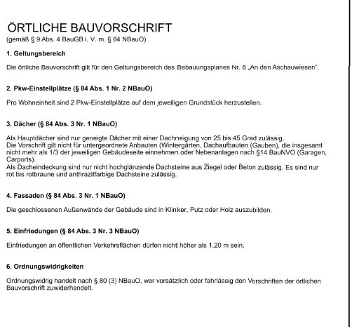

The development plan also includes a few textual regulations. forrestde schrieb:
I have already posted the excerpt from the development plan.
The thick dashed-dotted line highlighted in yellow is the building boundary. For me, that is clear. Well, you don’t have any restriction on building on the property boundary there. Therefore, we have to assume that the state building code applies and that the garage may be built right on the boundary—just as the state building code specifies.
It’s just unfortunate when a layperson treats their own interpretation as definitive and the original documents aren’t provided. Since, as you say, nothing else is specified there, the state building code applies.
hanghaus202321 Apr 2024 11:07I have not overlooked the plan and can read it. I don’t see any specified garage placement. So the location I suggested should also be possible. There might be something about this in the textual version of the development plan, but you haven’t shown that to us.
F
forrestde21 Apr 2024 11:44Thank you for the clarification. As you noticed, I was firmly convinced that the building setback line also applied to the garage. You have proven me wrong, thanks again. Since I am a layperson, I ask questions here and had misunderstood the legal requirements regarding the building setback line.
