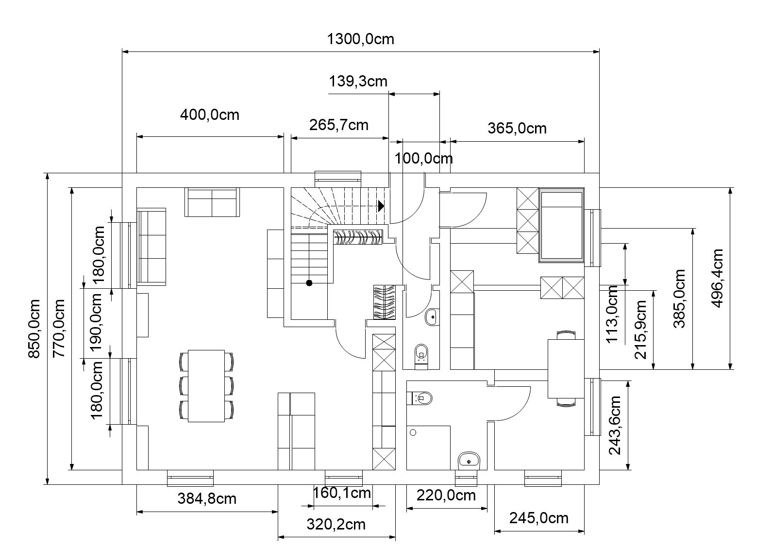

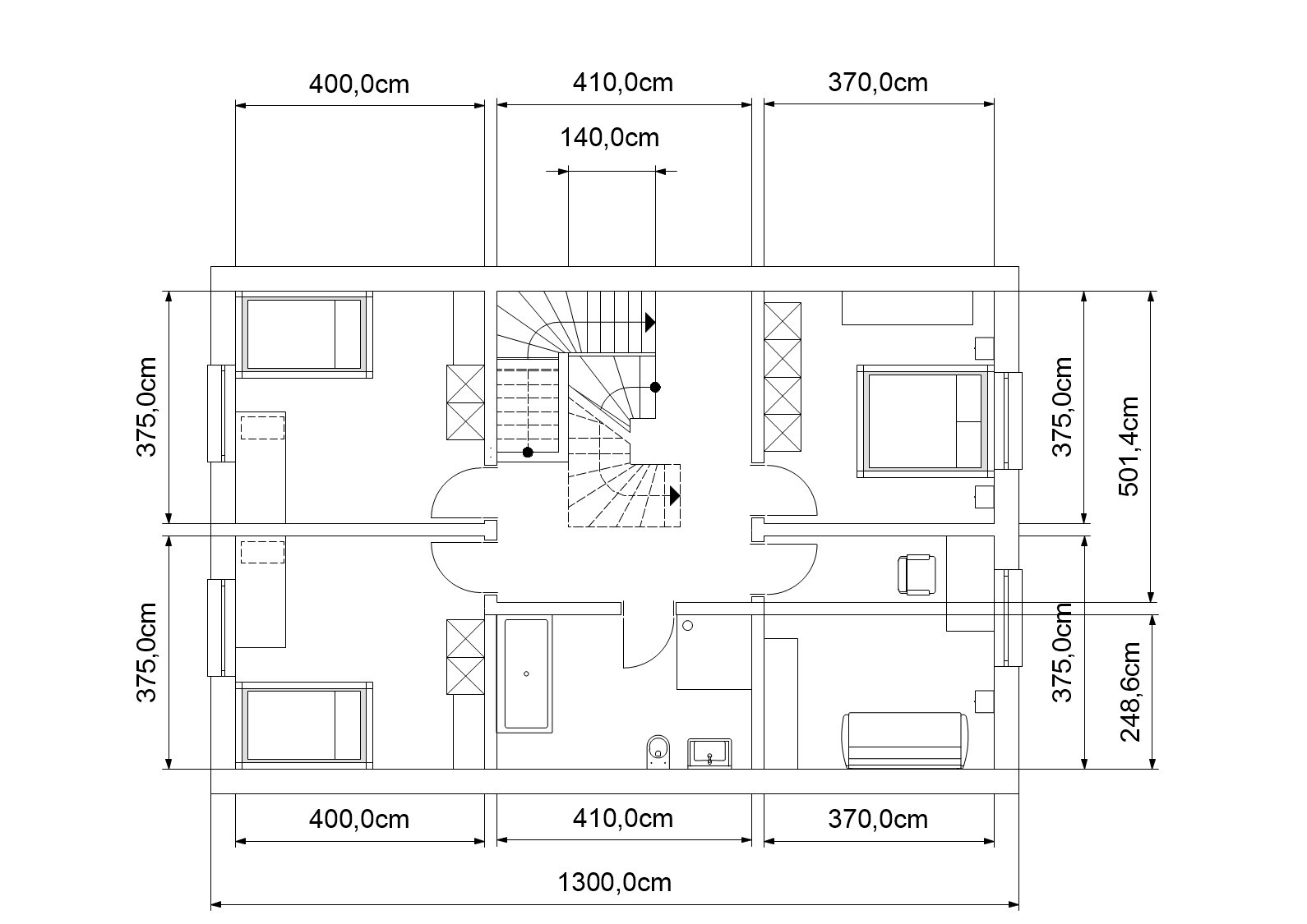

BucheOnBoard22 Mar 2023 12:49Since we want skylights, anything above a 1.5m (5 feet) knee wall seems difficult. However, with the house width and roof pitch, anything lower would significantly reduce the attic space, so I initially sketched it this way. So, either you climb the stairs bent over, or there is a dormer/skylight in that area to provide enough headroom at the top of the stairs. Or some other type of staircase.
According to ALKIS, some neighboring buildings are also two-story, even though they are in the same zoning plan area. So, if you don’t completely exceed the limits, something might be possible, but it would certainly be easier without that.
I think you should give up on the attic dream. You have a huge basement, and the upper floor is already quite large due to the granny flat. Why do you insist on using the attic space? In my opinion, the money would be better invested elsewhere. Installing a staircase here will always be difficult. The only option I can imagine is a spiral staircase, and even then, you’d probably only have about 2m (6.5 ft) depth where you can just stand upright.
BucheOnBoard22 Mar 2023 18:05Hmm, so the initial desired background is the current attic – it’s about 1.7 meters (5.5 feet) wide and just under 2 meters (6.5 feet) high with a 60° roof pitch, and it’s a very cozy bedroom and workspace. However, it can only be accessed by a ladder. Combined with the wish for both parents (that is, me and my wife) to each have their own room – not the kitchen or the office, but a room that doesn’t need tidying up, where you can slam the door if you feel like it.
But yes, maybe “my” room will have to be the workshop cellar after all, and instead of the room now taken up by the stairs, we’ll try to get the “sewing room” into the upper floor...
What did your start look like, @K a t j a?

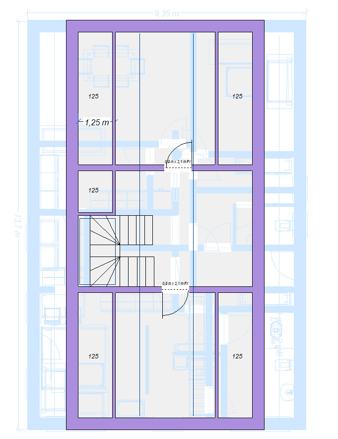

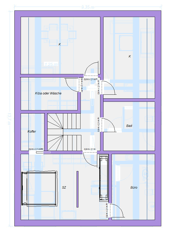

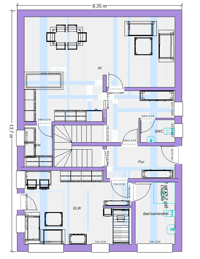

K a t j a schrieb:
Actually, I started similarly but thought I’d wait to see your plan first.
I initially started with a similar approach but then discarded the idea of the quarter-spiral staircase. Ultimately, this is the design I settled on:
I should mention that I haven’t optimized the dimensions much yet. I suspect there is room to reduce the size in some areas.
What was important to me:
- Granny flat living area facing south with an option for terraces. Accessible bathroom
- Main apartment with pantry
- Guest toilet with a window and a proper wardrobe closet
- Access to the attic – it needs to be calculated precisely whether the slope above the stairs requires a skylight or even a small dormer. I think a skylight might be sufficient. (Knee wall assumed at 1.5m (5 feet); that would already cover more than one story => special permit or the architect manages to solve the headroom differently.)
As you can see, the windows and terrace doors are not included yet – I got stuck on that. 😉
I have also already started, but so far only completed the ground floor. My approach is similar to @K a t j a, but with an external dimension of only 8.8 x 13 m (29 x 43 ft). The width of the plot at the front is just under 16 m (52 ft), and since there will be a garage/carport on the north side, I thought there should be some space left on the south side next to the setback from the boundary. That was my thinking on this.
BucheOnBoard22 Mar 2023 21:22I definitely find the staircase position interesting and will definitely experiment with it. However, regarding the exterior dimensions, I agree with @kbt09; going longer than 13m (43 feet) probably isn’t possible because of the tree, and I wouldn’t want it wider than about 8.5m (28 feet) either, mainly due to the terrace and carport. So, I’d gladly welcome input for dimensions in that range 😉
We’ve also moved away from the pantry, even though with the staircase position it really made good use of the narrow space behind it. Having a guest bathroom with a window is definitely pretty cool, thanks so much for that!
For the knee wall height, to keep it a single-story, it would need to be about 1.3m (4 feet 3 inches) high (if I haven’t miscalculated). That would be sufficient inside, but of course, it would make the stairs even more awkward. Another option would be to change the roof pitch, but I think that wouldn’t look as good. So, I’ll keep tinkering with it 🙂
