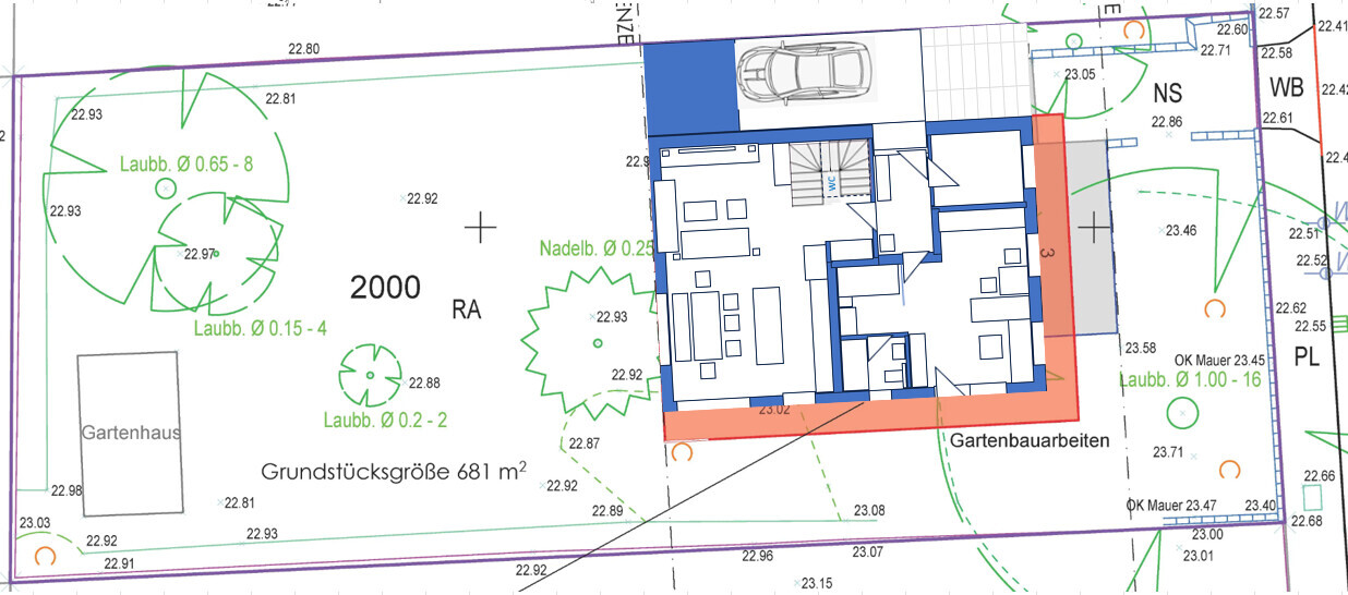

Attached are current ALKIS excerpt, aerial photo, and building plan excerpt, all oriented north and approximately the same section. I hope they are legible… Red borders and points mark the plot.

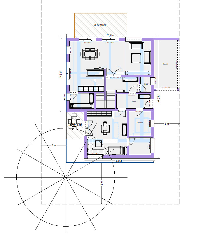

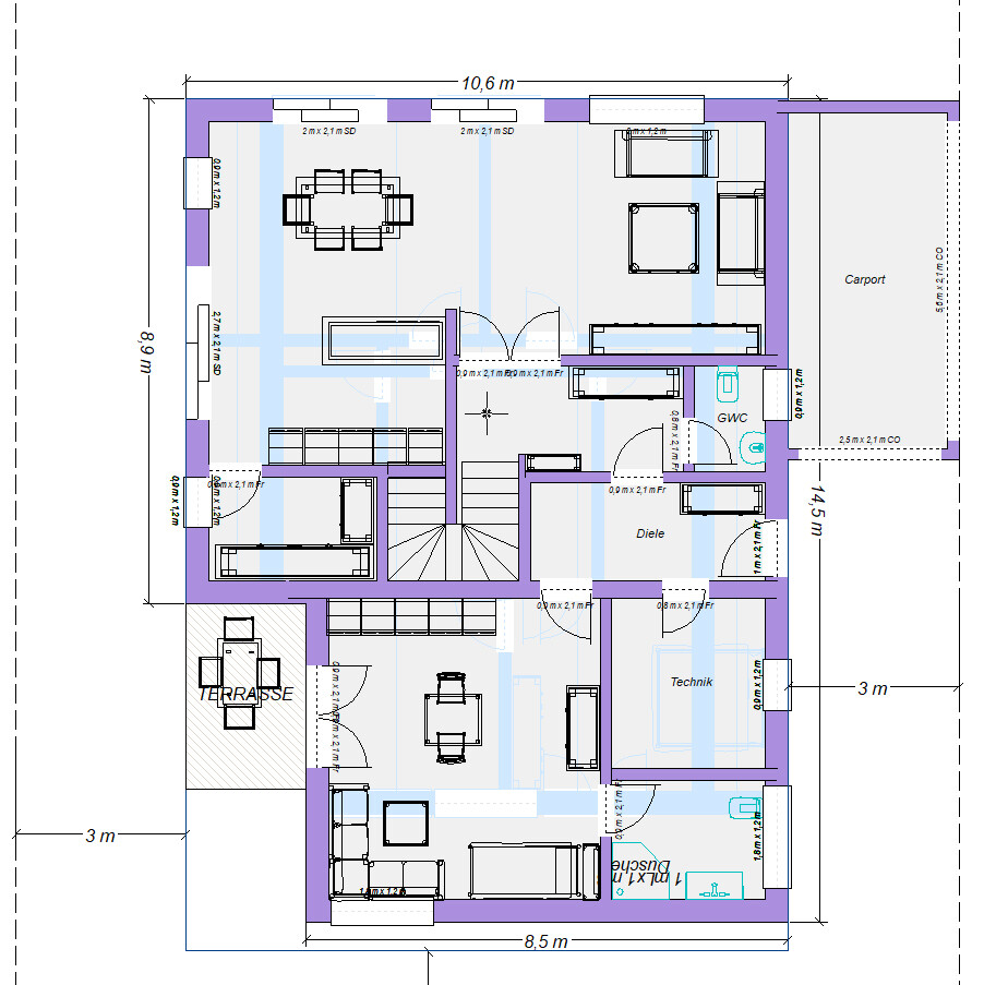

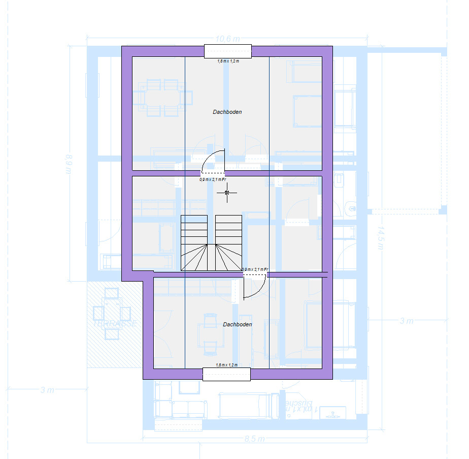

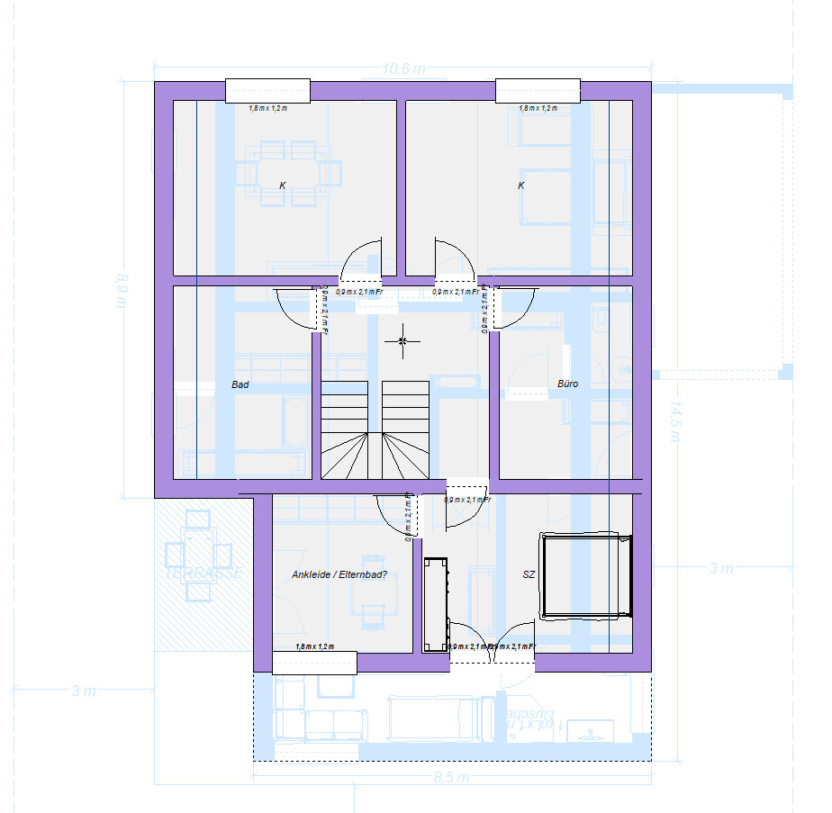

hanghaus202322 Oct 2023 11:45ypg schrieb:
I don't know what measurements your software is showing you, but for me it looks close to 90 sqm (970 sq ft). Could it be that the workshop/carport was included in your calculation? As a reference, I used the 13.50 from the original plan on the left.
[ATTACH alt="Bildschirmfoto 2023-10-21 um 15.53.21.png"]82468[/ATTACH] Thanks for redrawing this.
I have the house at 9 m * 12.5 m (30 ft * 41 ft). The original was 10 m * 13.5 m (33 ft * 44 ft).
From the sketch, it’s clear that my statement is correct. The usable rooms are significantly larger.
If I leave out the short wall section as shown in post #70, the bedroom isn’t as cramped, but if you want to separate it, a curtain will do in a pinch.
hanghaus202322 Oct 2023 11:53Unfortunately, again the 4 minutes? Sorry.
Here is the correction.
If I leave out the short wall section, as shown in post #84, the bedroom is no longer so cramped, but if you want to separate the space, a curtain will do in a pinch.
135 m² (1453 sq ft) * 0.8 equals approximately 108 m² (1163 sq ft) of living space.
112.5 m² (1211 sq ft) * 0.8 equals approximately 90 m² (969 sq ft) of living space.
18 m² (194 sq ft) * 3 k equals 54 k cost savings.
hanghaus202322 Oct 2023 12:07Some time ago, there was a case here where someone had to build a house around an oak tree because the plot was much smaller.
I don’t see the situation here as quite that extreme. With the reduction to 9 x 12.5 m (30 x 41 feet) as I marked, the new building is actually further away from the beech tree than the existing house.
In my opinion, the alternative would rather be a narrow house with an extension or a bay window.

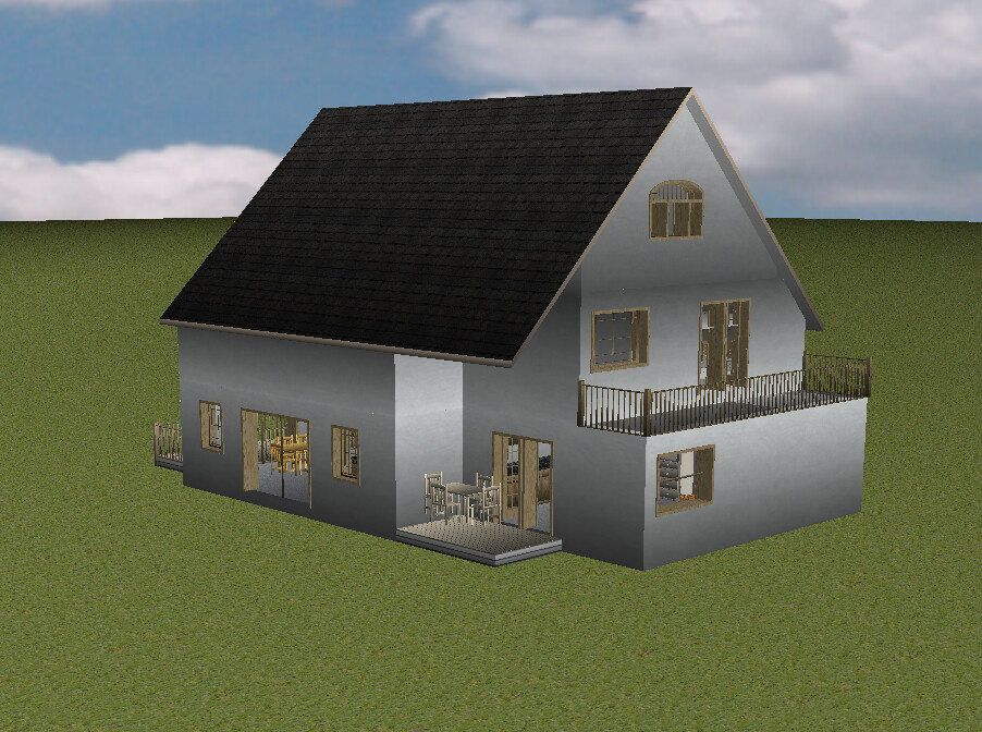

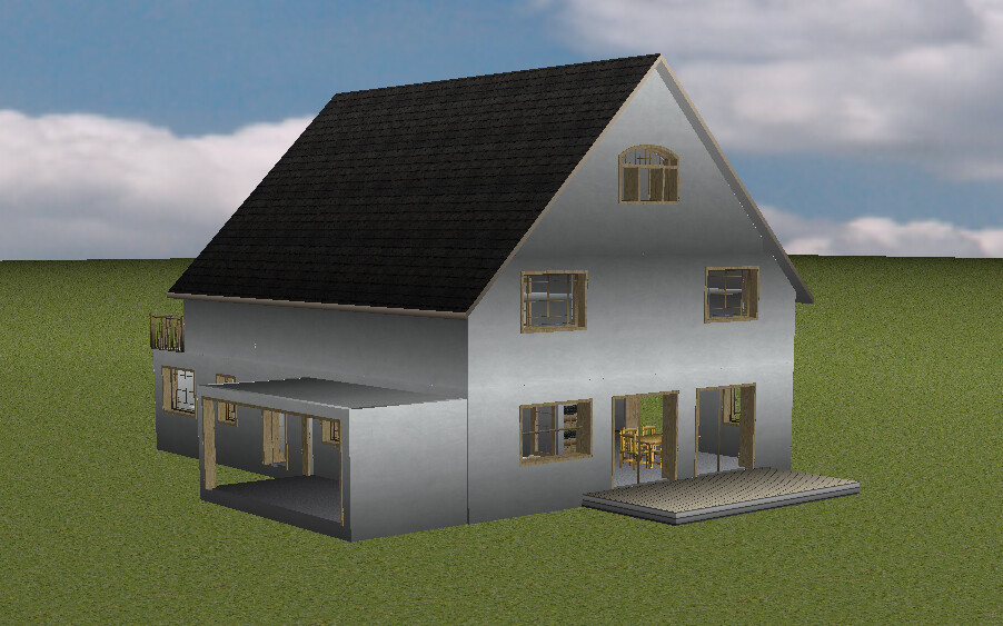

BucheOnBoard schrieb:
And we would also very much like to avoid a staircase in the open-plan living area... That is often the reason why everything ends up lined up next to each other.
but somehow just lined up next to each other, which results in large hallway areas or similar. ... and this depends on the size of the hallways.
For example, the front terrace being drawn into the beech tree is actually a minor issue, but it does affect the mood. Why? The canopy starts higher up and can provide plenty of shade on the terrace for someone who enjoys privacy.
Of course, you don’t have to just cut off the upper floor at the gable end—you could carve out a pie-shaped section and glass in the gable to bring the beech tree into the house 🙂 It doesn’t have to be expensive full-height glazing, but a floor-to-ceiling window without a sill, essentially a rotated horizontal band window, to always be able to admire the tree in its full glory would be affordable.
The most obvious solution would be to reduce the attic space by lowering the knee wall. This has traditionally been done instead of creating an expensive flat roof: either without a knee wall or with a small one built, installing a knee wall inside or using the walls for built-in closets.
