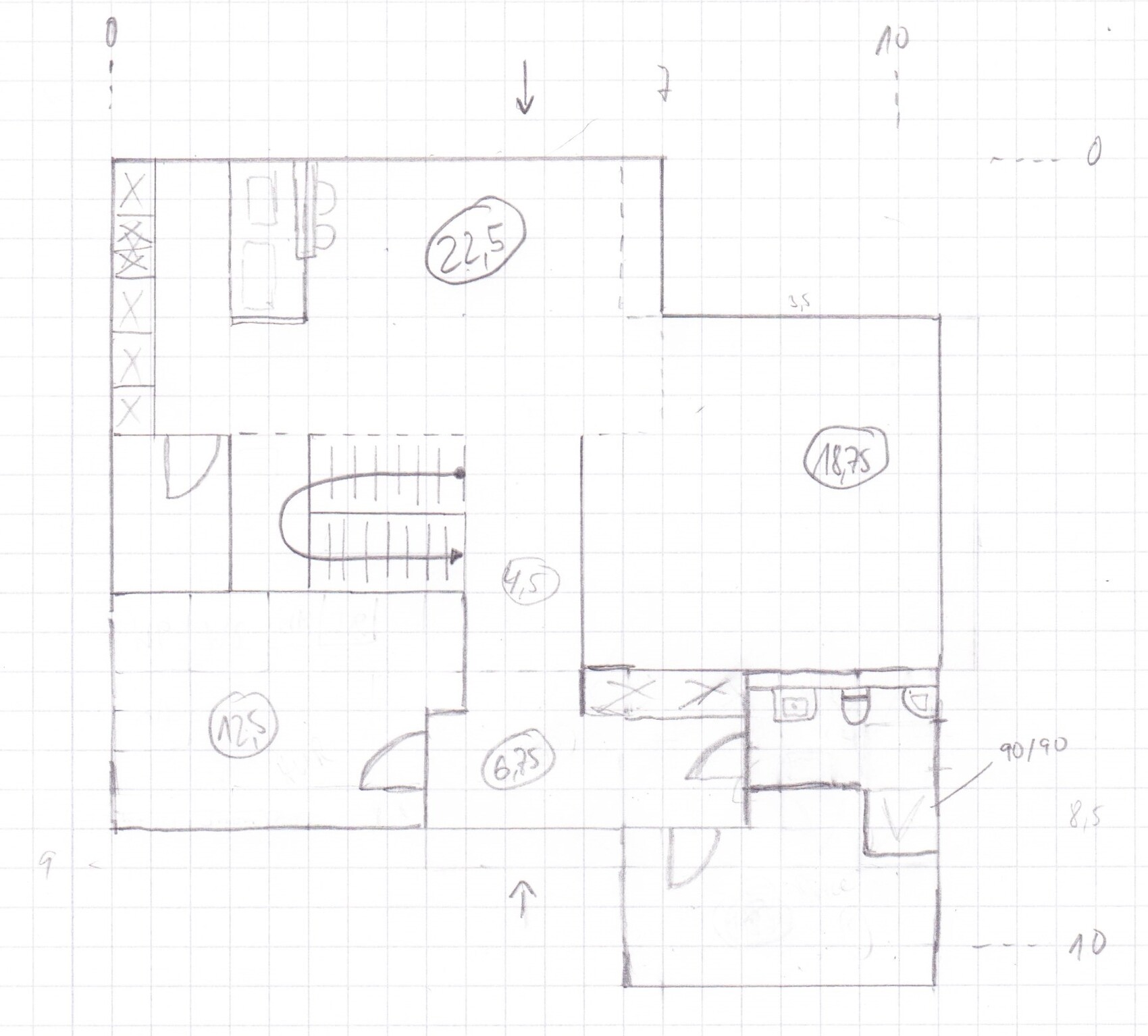

I have already drawn the concept for the dining and living area with terrace, but I am still missing ideas for the entrance area and room layout. The floor plan attached was the first idea, but I have since enlarged the living room (see sketch). Please do not evaluate the doors in the floor plan, as they were inserted provisionally.
As mentioned, the upper part of the ground floor (kitchen, dining room, living room) is almost fixed for me. Only the entrance area with hallway, wardrobe, utility room, home office, and staircase do not yet satisfy me. It would also be nice to highlight the staircase a bit.
I want to plan the upper floor towards the end once I know how many square meters I will have available. The ground floor should have 90-100 m² (970-1,080 sq ft). The shape of the ground floor can still vary depending on the design. Due to the long terrace front in the living room, the house will now be more rectangular. The house/garage should be built directly on the front left property boundary.

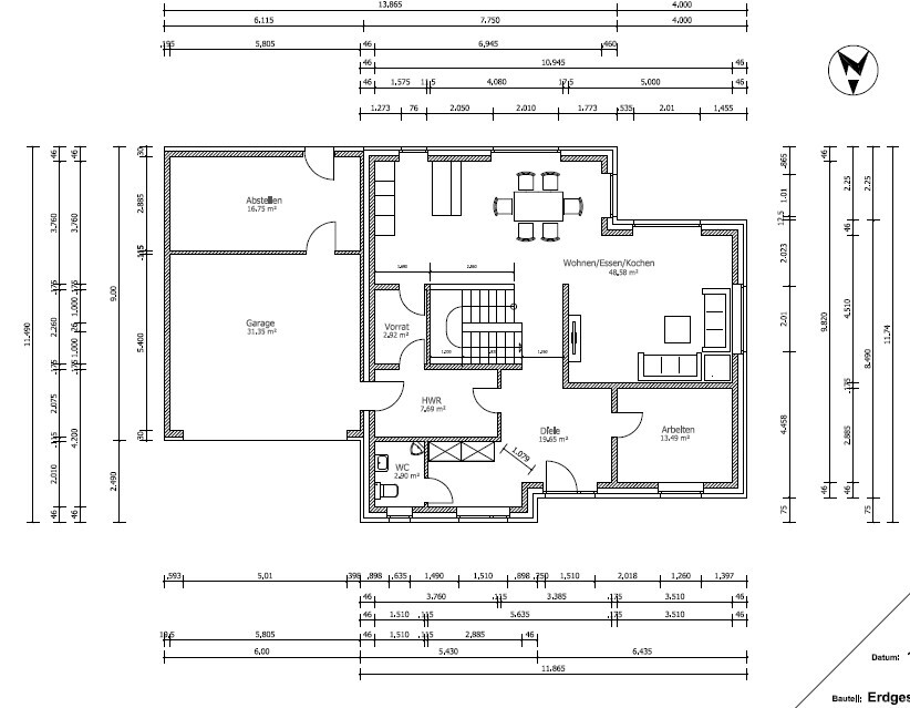

Unfortunately, the planning has been delayed a bit due to vacation. The ground floor has changed slightly, but I haven’t received the updated plans from the architect yet. The upper floor fits quite well with the delay, though.
The arrow at the bottom marks the front door. To the left of the entrance area is the study, which could also be used as a bedroom later on. On the right, there is the guest toilet and the utility room. This makes the wardrobe somewhat hidden. The staircase is now open toward the kitchen and dining area, meaning the wall will be at the height of the railing.

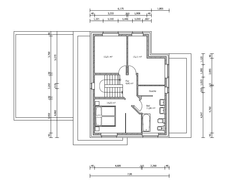

The second image shows the first idea. Here, the spaces in the utility room would have been difficult to use because of the doors, and the hallway area was too large—in our view, wasted space. The upper floor will also be adjusted since we are not satisfied with the bathroom layout yet.
What do you think about the new ground floor idea?
