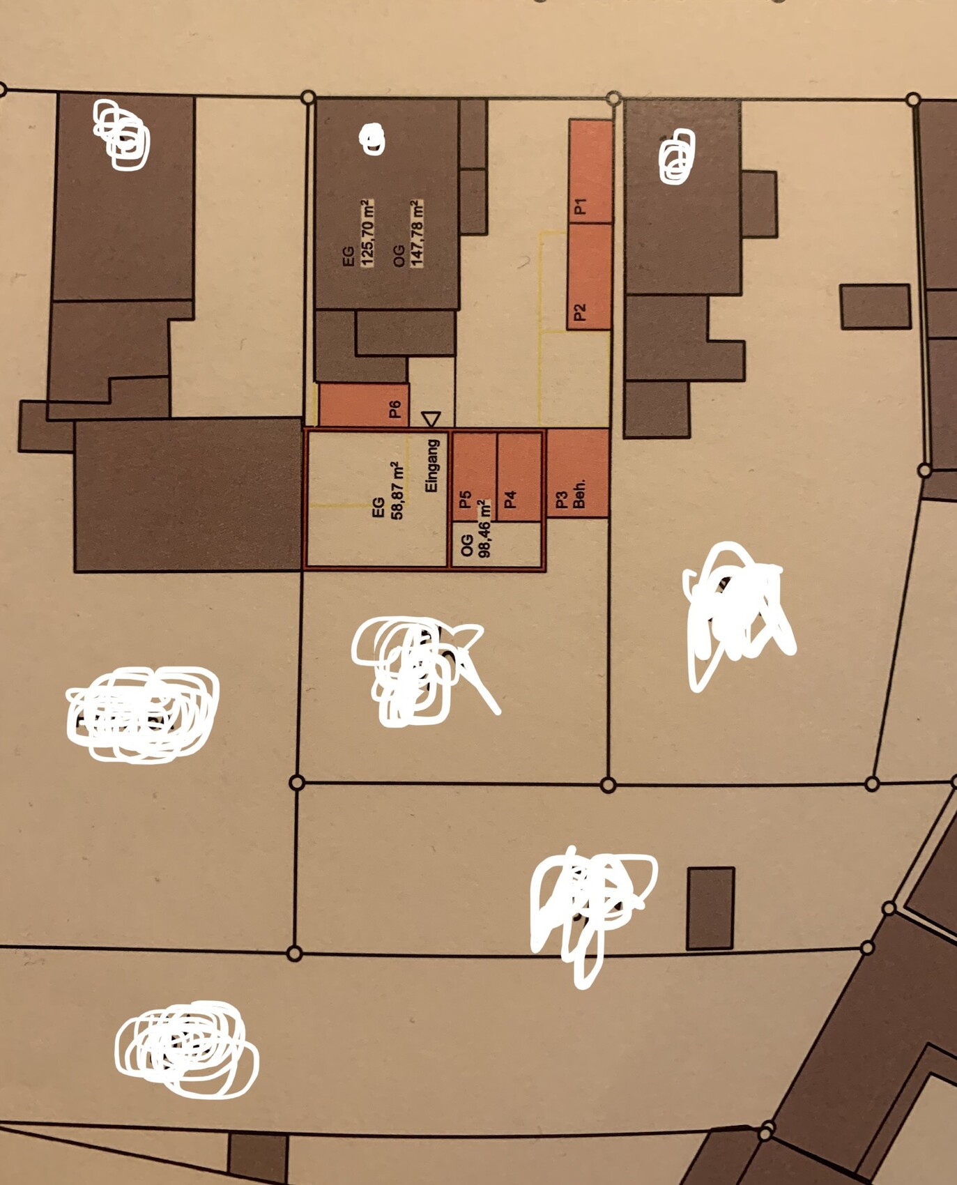

Regarding the floor plan, apart from the external walls (a line with property boundary construction and 3.5 m (11.5 ft) to the neighbor) and the double garage, we have complete freedom. We have already modified the floor plan as we want to prepare the upper floor for potential rental at some point (an external staircase will probably not be approved). Hence the second internal staircase.

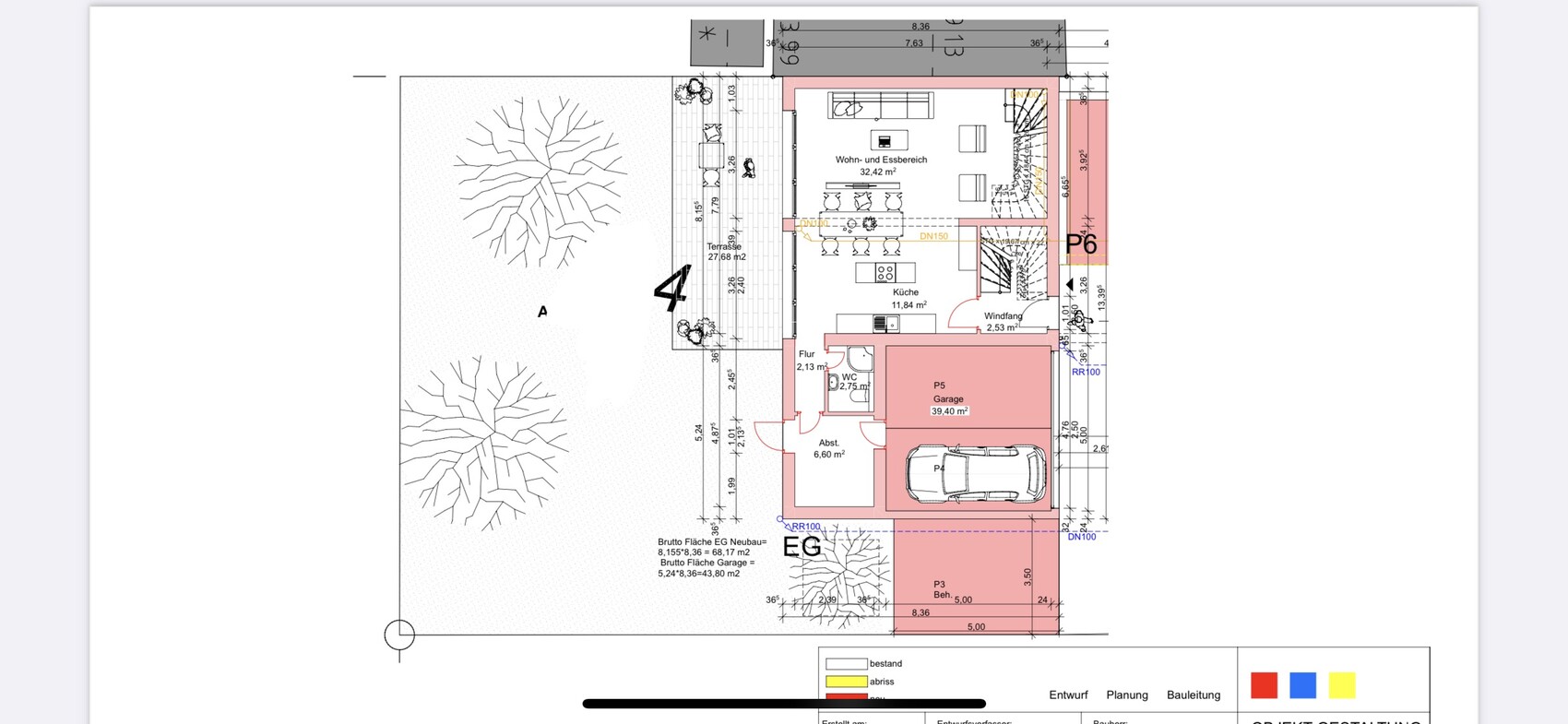

Basically, we are wondering how to best use the ground floor. Somehow I find it a bit small for cooking/living/dining. (Although I cannot verify the square meter figures, because based on the external dimensions and some calculations it should be about 49 sqm (527 sq ft) instead of approximately 44 sqm (474 sq ft), but I don’t know if the staircase is excluded).
Where is the best place to put a couch?

Boundary construction see pictures

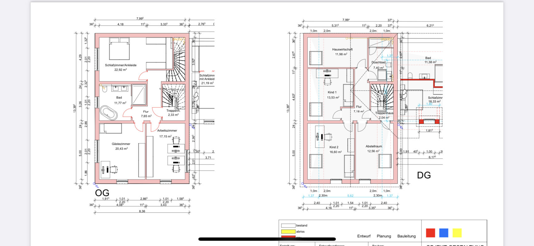

Is the blue dashed line in the attic the 1.80m (5 ft 11 in) line? The house is designed as a single-family home without a separate apartment. There are 4 units in total including the 3 condominiums, so 6 parking spaces must be allocated. Three of those would be ours. The necessity of this does not need to be discussed.
In short: even without a separate apartment, the 3 parking spaces must remain.
Yes, mine is the 1.80m (5 ft 11 in) line.

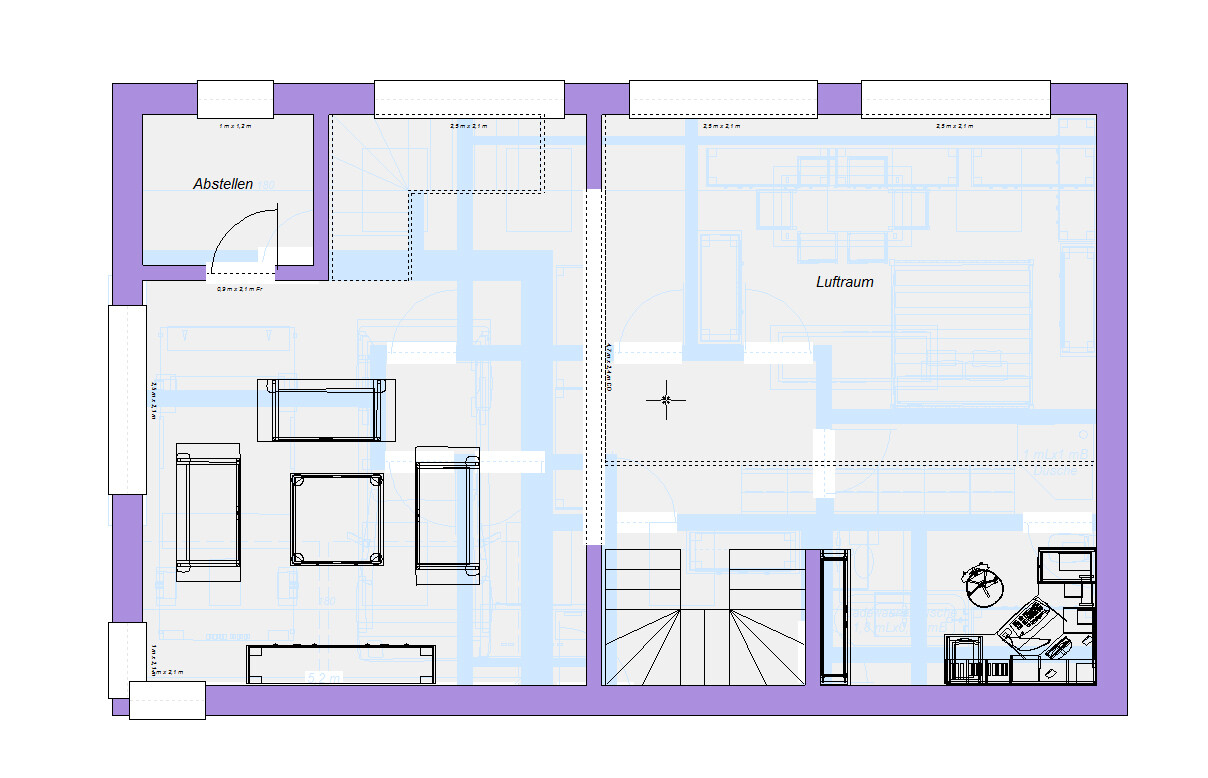

I figured as much. A parking space is probably worth its weight in gold here. I wouldn’t complain about that for now. Chances are the other residents will be willing to sell you their daughters for one. 😉Just an idea:
Structurally, it might not be fully optimized yet but I think it’s feasible.

Where will all your building services be installed? Water connection, electricity, fuse box, telephone, etc.? Heat pump/heating, hot water? We don’t have to buy it, but since it is so close to the house, we would do it. That way, no one else’s car will be parked there.
In the room behind the garage where the storage room is located.
