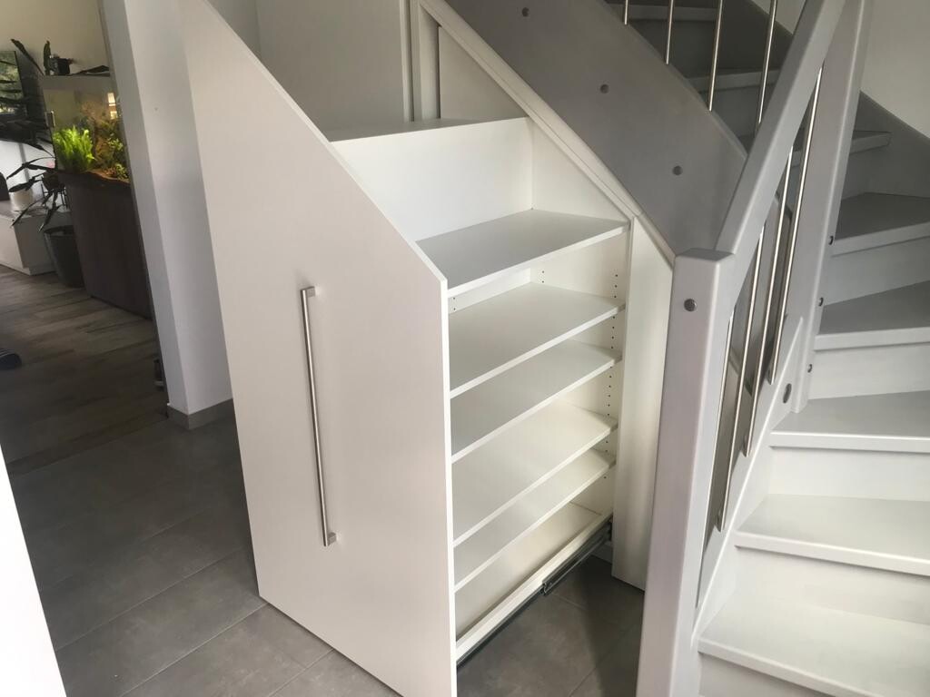

I can use the entire area. So not a purchased wardrobe, but fully enclosing the staircase and then installing pull-out drawers for shoes lower down and a pull-out clothes rail higher up. Maybe I’m oversimplifying it, but something like in the picture

From my perspective, there’s no reason against having a pantry in your case. I would also separate it from the utility room, especially because of the dryer. Adding the wall between the utility room and pantry also creates extra space for storage. I think a pantry is great—it’s much more organized than storing everything in kitchen cabinets. You still have space for a coat rack on the left side of the hallway. Whether the pull-out trays work out depends on if your kids are disciplined enough to always put their stuff away—that’s something you need to judge.
Just as a suggestion:
I don’t have a drying rack in the utility room, but rather a rod about 2 m (6.5 ft) high where I hang clothes on hangers. That way, any dirt from the dog shaking off won’t get on the laundry, and you keep the floor area clear.
